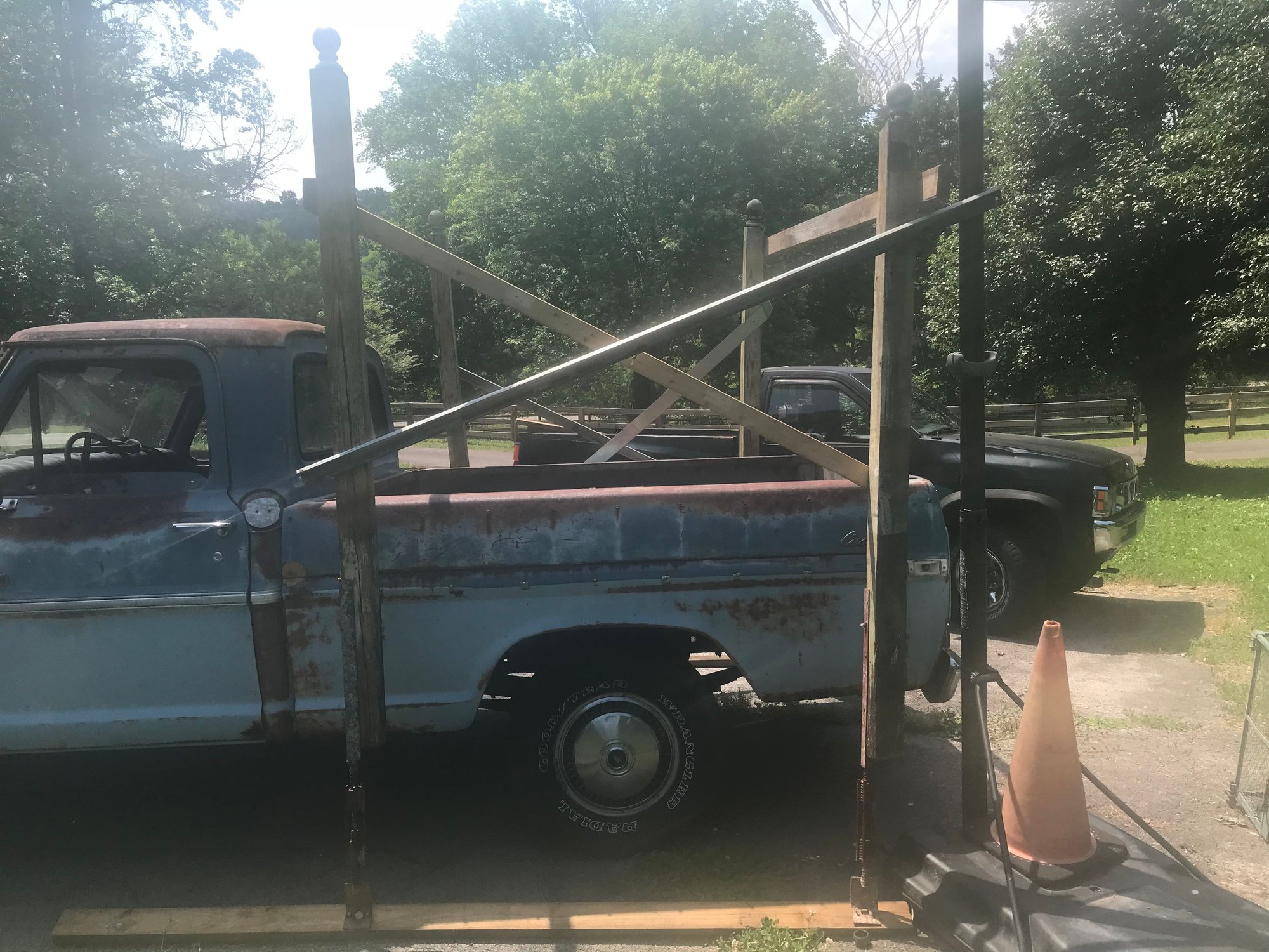

Since I don't have extra labor available, I'm planning to erect a frame from scrap lumber, back the truck under the frame, hoist the bed up, then drive the truck out from under the bed. I'll then lower the bed onto a frame where it can sit for how ever long it needs to.

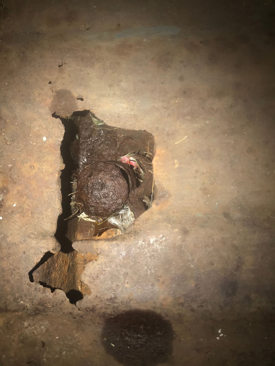

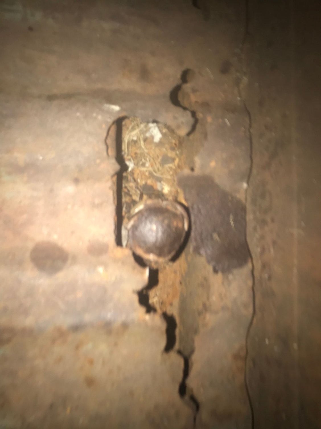

The exception is up front in the bed. Front bolts I guess I'll have to cut off since there's nothing holding the heads in place any more:
If I had a welder, I'd just weld something to the heads so there'd be something to grip. I tried to get a big vise grip pliers to hold onto the head of one while I used a breaker with a cheater bar underneath, but the vise grip wouldn't stay in place. Decided to call it a night and pull out the cutting tools tomorrow when there's day light.

If you can't get the cutting wheel under the bolt head (without cutting the bed), you might be able to cut the edges of the bolt heat off, then punch the bolt shaft down through the frame. Try cutting an "X" into the head. Then increase the thickness of the "X" lines a little. Then try the punch and hammer.

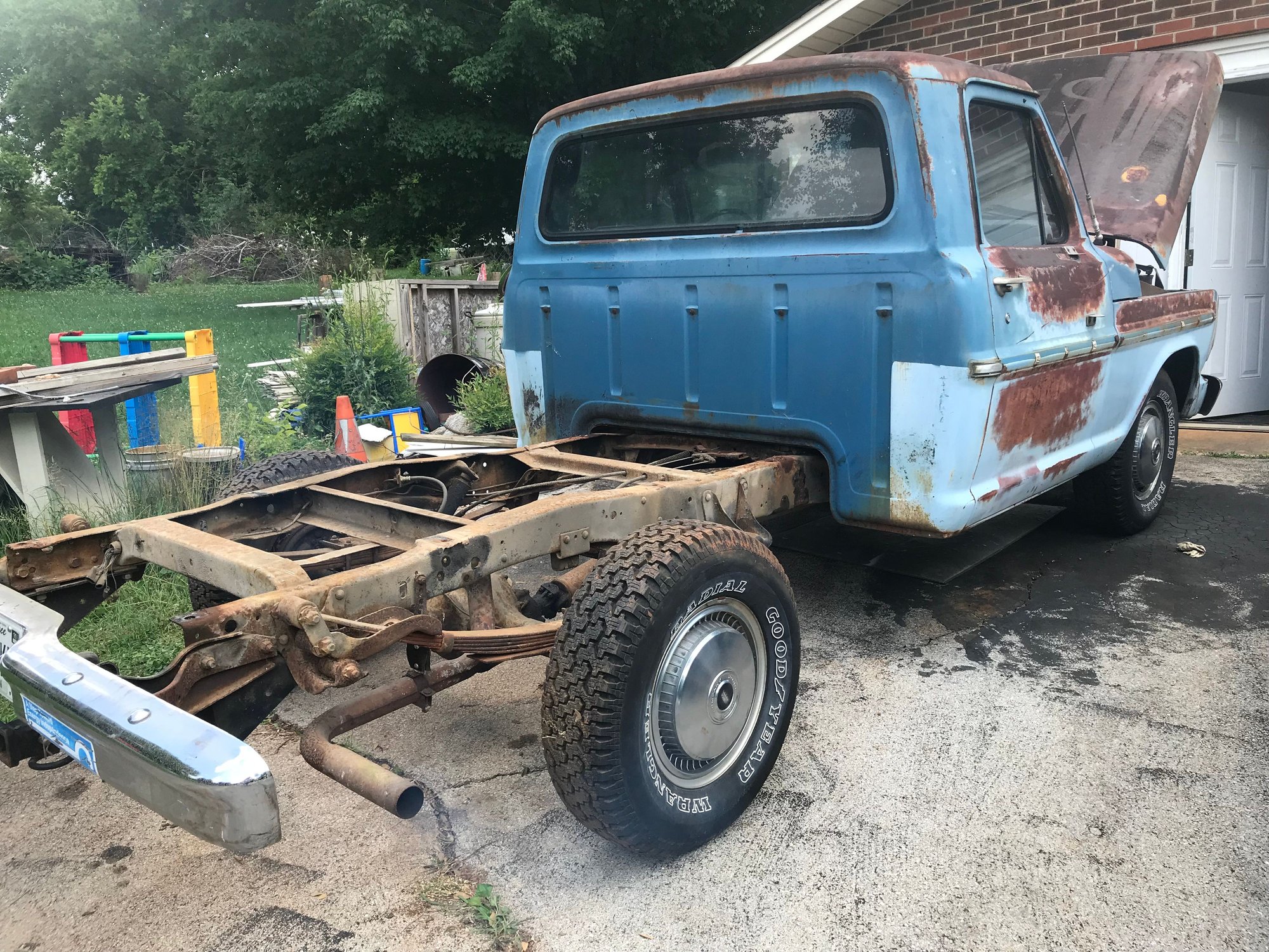

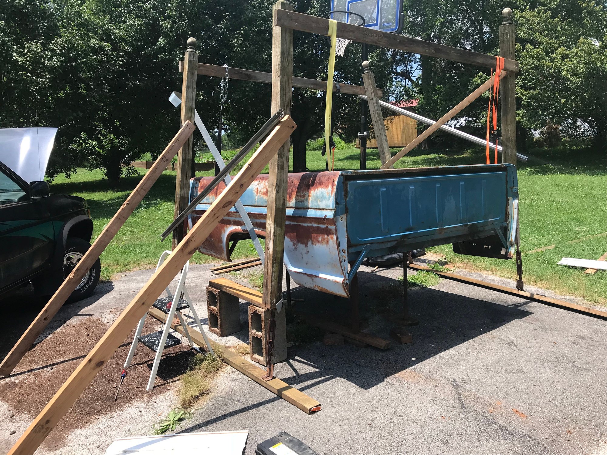

It's off! I know that's no big deal for most of you who've been at this a long time, but this was a first for me.
I slid a steel frame under it, leveled the frame, and lowered the bed down into it. The frame is long enough that the two center crossmembers of the bed are sitting on it.

Nice job on the rig to raise the bed. Do your self a favor before re-installing the bed and solder the trailer wires to the harness. Those scotch locks usually loose their continuity after a while.
