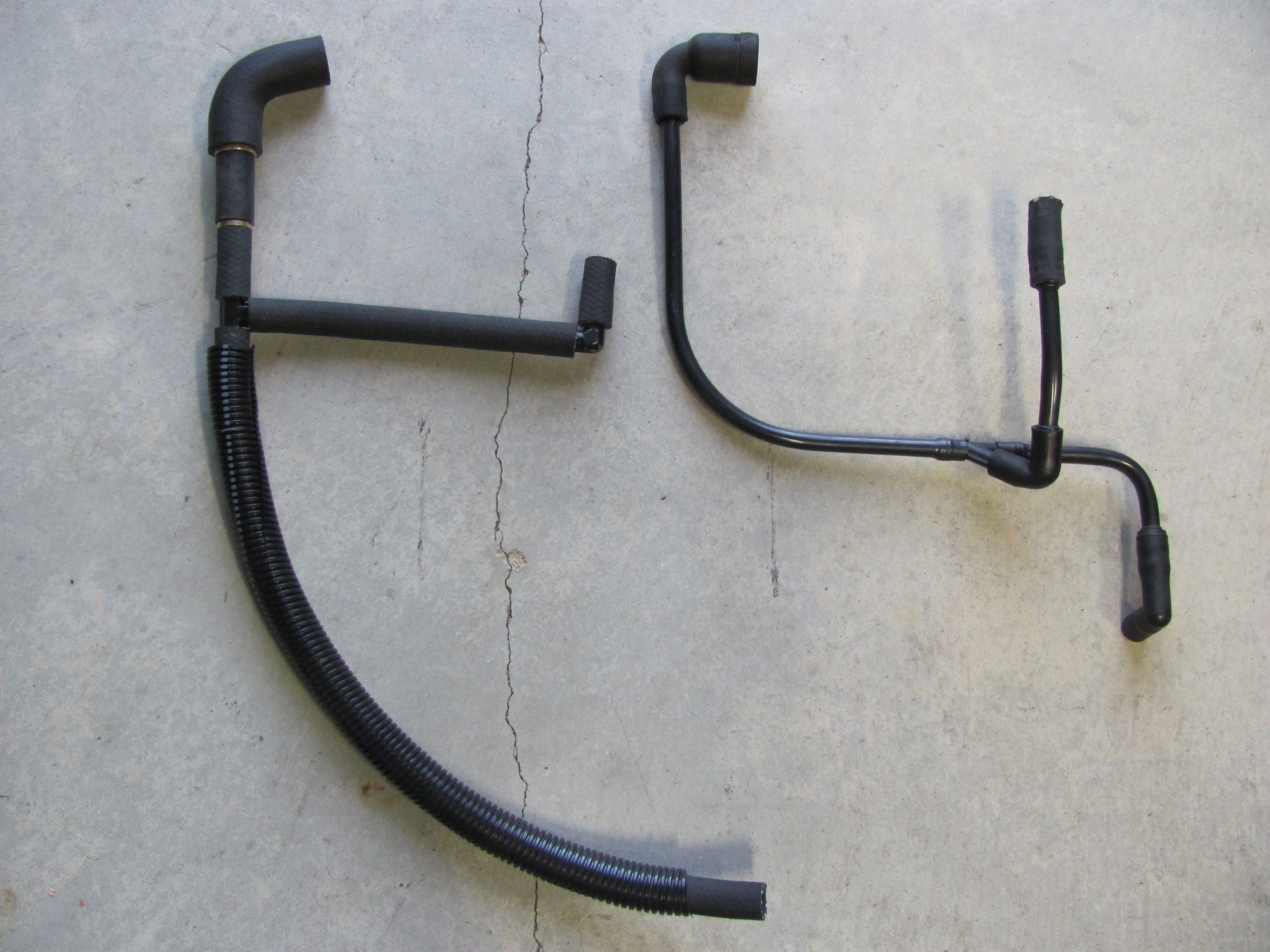

Have not had a problem making my own vacuum hose assemblies for our Exped or Excur.
The problems I've had with vacuum hoses is the non-reinforced hose used in the PCV line, plastic tubing/fittings and anywhere a neoprene hose connects to the engine.
The PCV non-reinforced hose elbow gets soft, the plastic tubing can break and neoprene hose within 1-2 in of the connection to the engine will degrade from heat.
When rebuilding the vacuum hose lines I use reinforced hoses, brass fitting/tees/reducers and silicone hose.
Don't see any reason the hoses can't be whatever length works to route them to allow easier access to the plugs, particularly on the passenger side.
Ford routes the hoses tight around the engine to make it easier to install the engine.
The pic is a rebuild of the PCV line for our Excur.

Thanks R&T Babich! The photo helps a lot. I would like to use silicone and brass fittings to make the vacuum system as bulletproof as possible. May I ask your sources for the materials you used?

I got the parts on ebay and Amazon.
It can take a couple of weeks for stuff from ebay.
I used a reinforced fuel tank vent hose to get the PCV elbow, but next time I would use a brass elbow. (3/8" 10mm elbow brass barb - $2)
The silicone hoses are sometimes listed in mm - 3/8" = 10mm, 5/16" = 8mm, 1/4" - 6mm, etc.
I rerouted the heater hose lines to make it easier to get to the plugs on the passenger side, used a couple of 3 layer reinforced silicone turbocharger hose elbows which work well.
