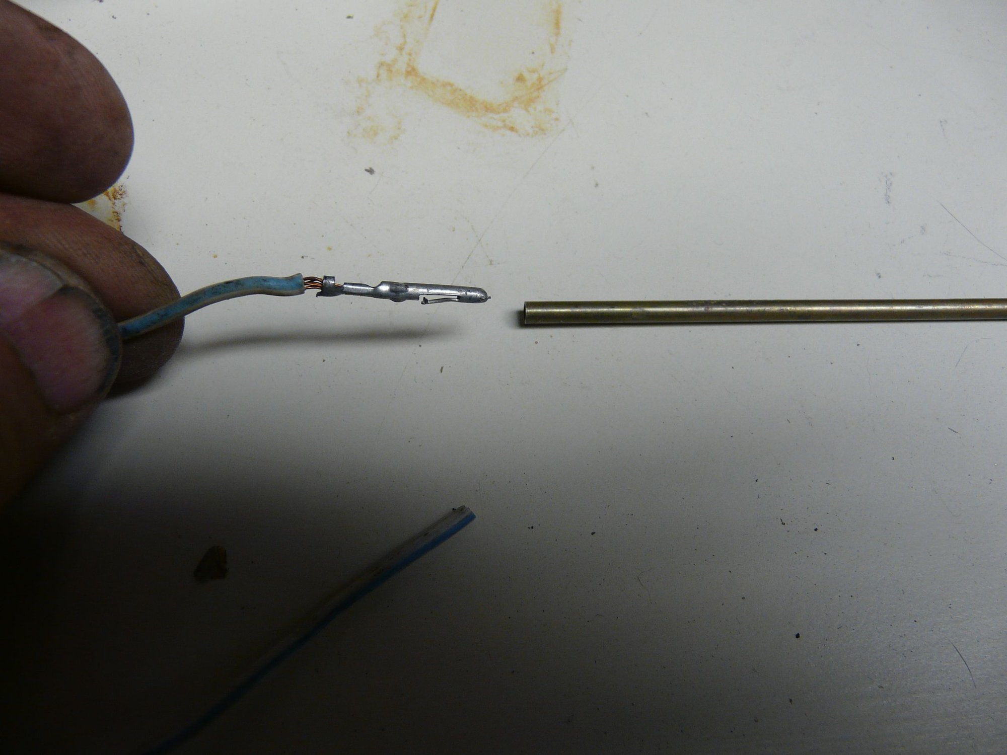

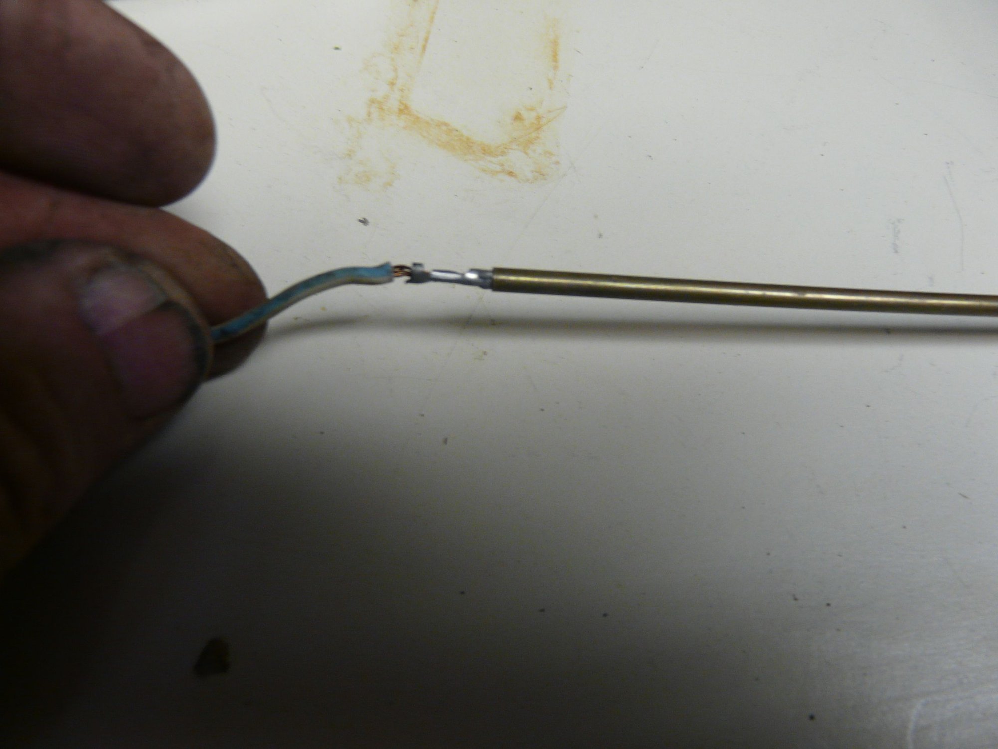

I just replaced my turn signal switch and was going to splice the new mires in when I remembered that I had some brass tubing from the hardware store. I had a piece of .125 OD tubing that worked great. Slide it over a pin and give the old pin a tug and out they came.

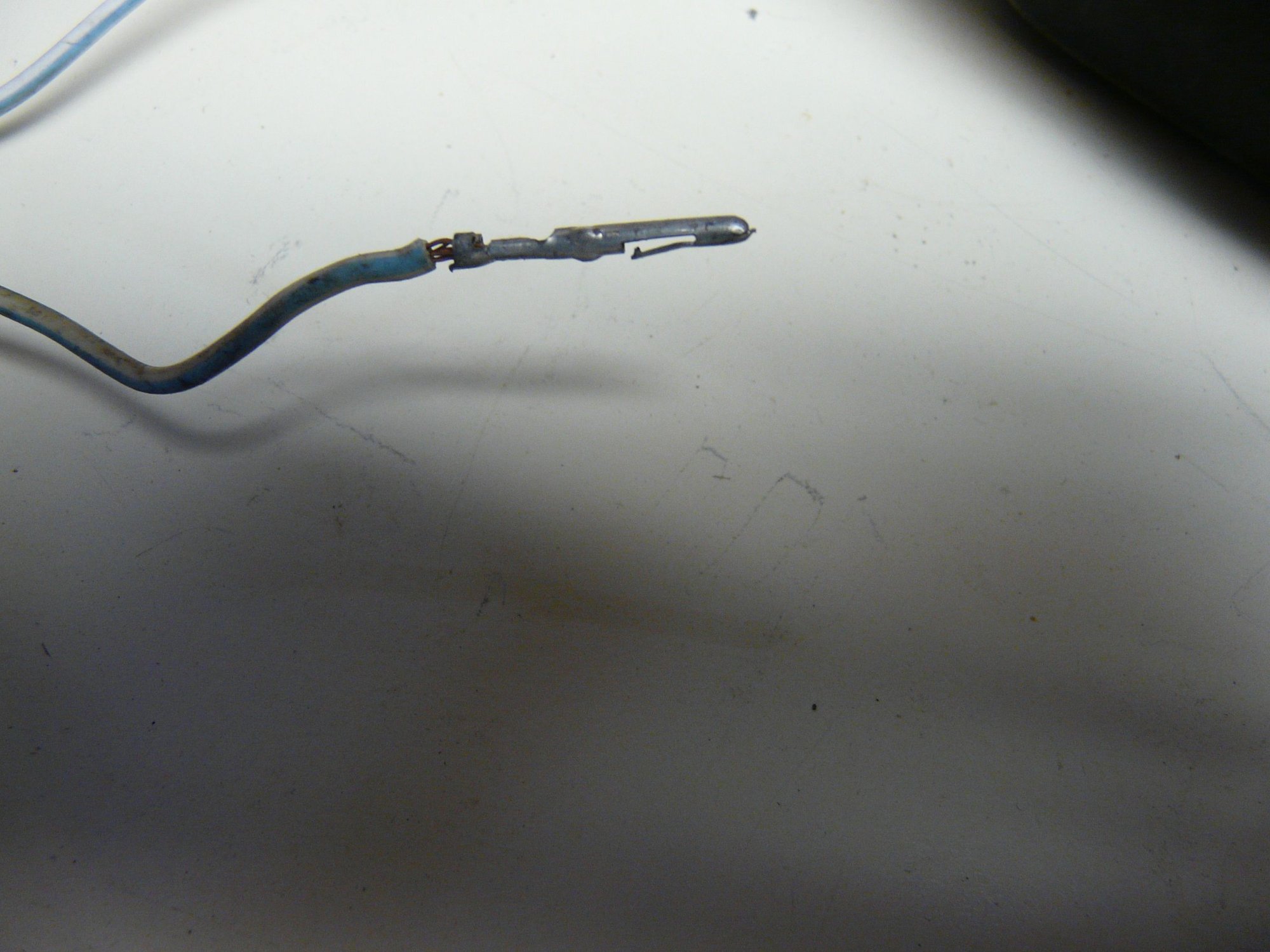

Those pins have a little barb on them that locks and holds them in the plug. Pushing that tube over the pin depresses it so you can pull the pin out. Actually Lisle makes a tool just for those pins. And you can get new Ford wedge lock pins in male or female at NAPA.

Here are a few pics with one of the removed pins. I paid less than $2.00 for the tubing 7 or 8 years ago.
