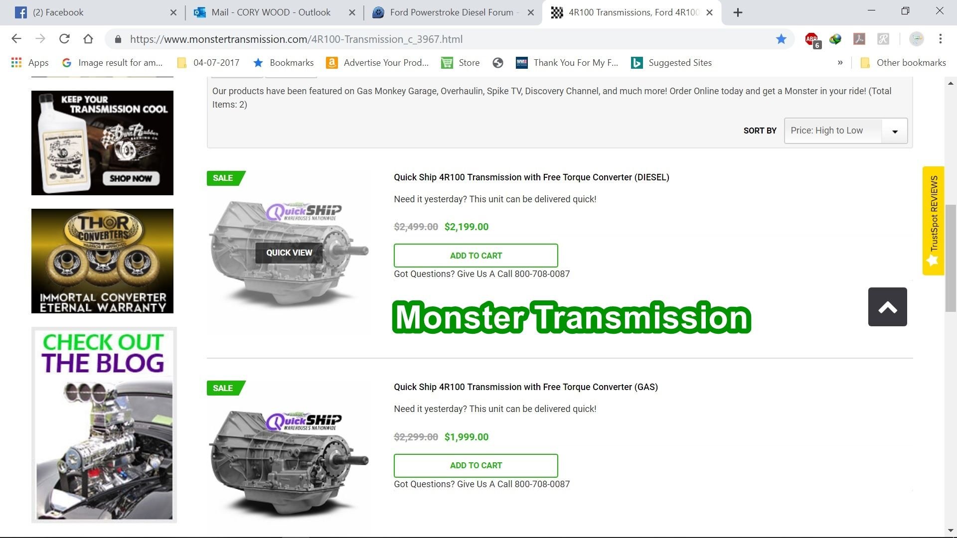

Oh Sh&T I did not know this WOW. We called several people that supposedly knew Transmissions. So yes I did OUCH" Thought about buying from Monster Transmissions. Sounds like I should be looking at the Transfer case. I am going out there real soon and will check the Transfer thanks for your help. So what do you think about Monster ??

I don't know anything about Monster.

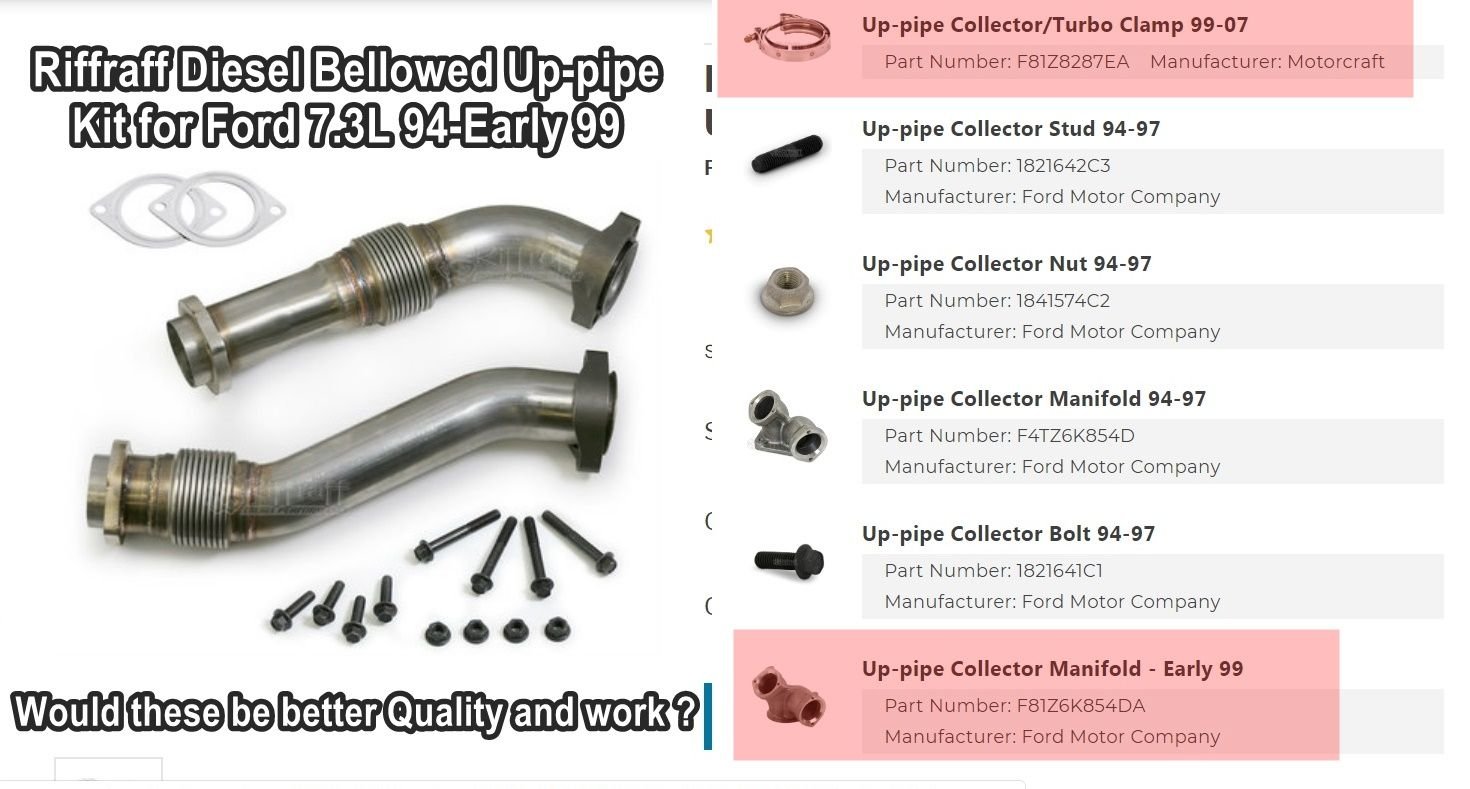

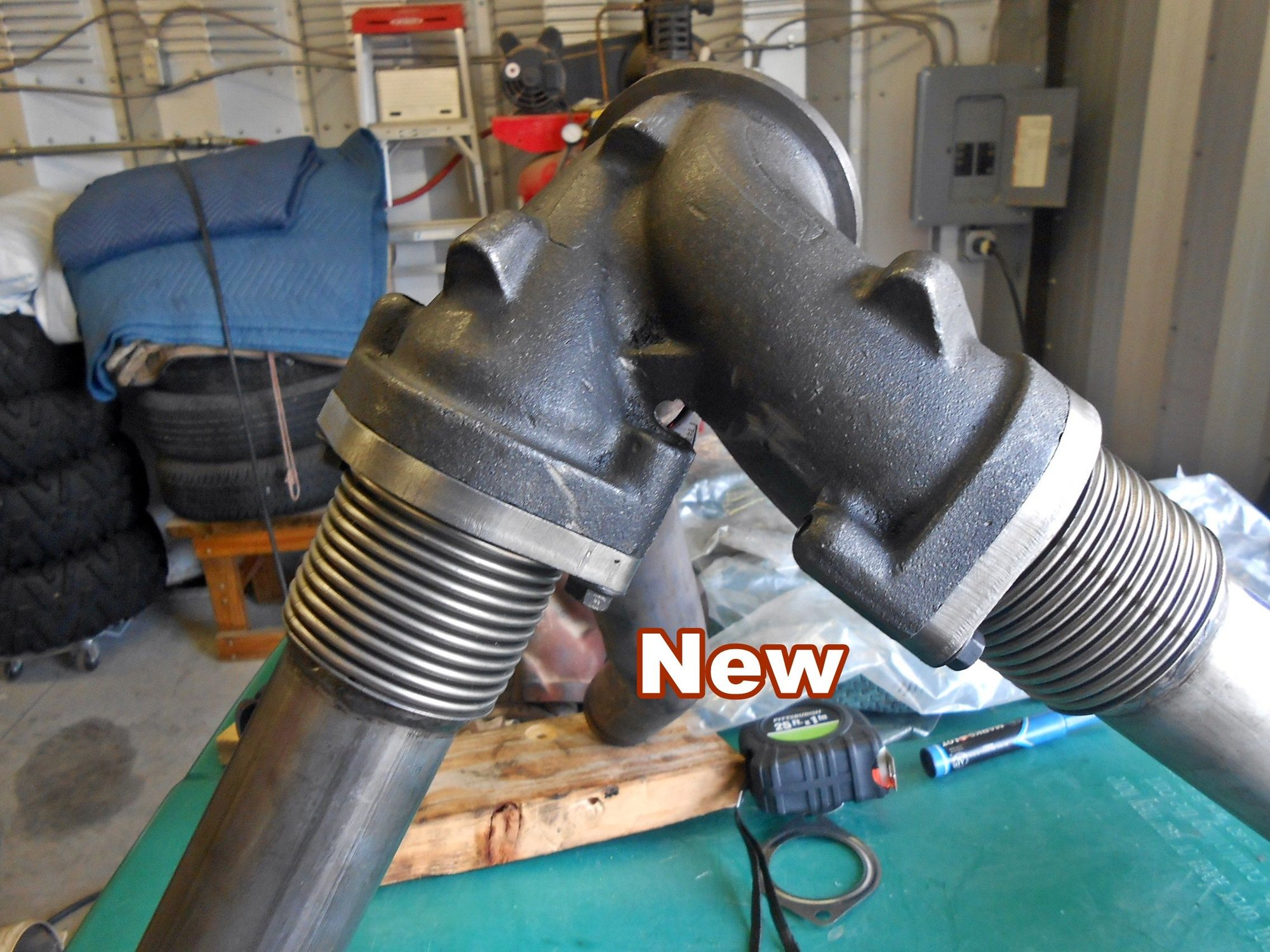

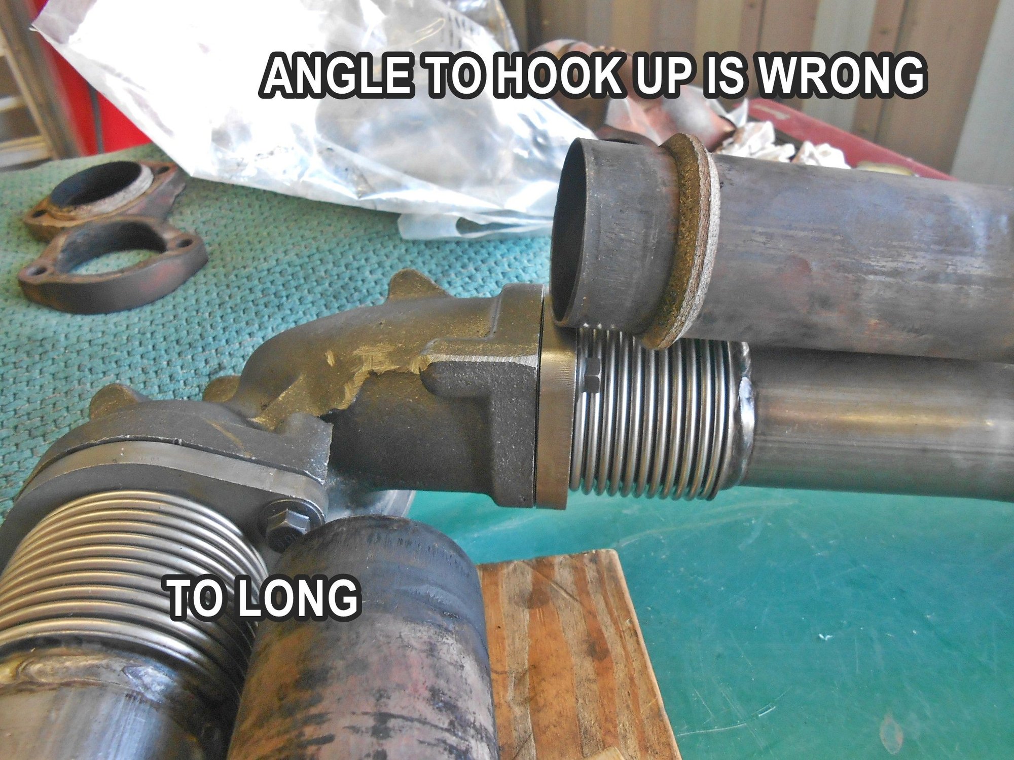

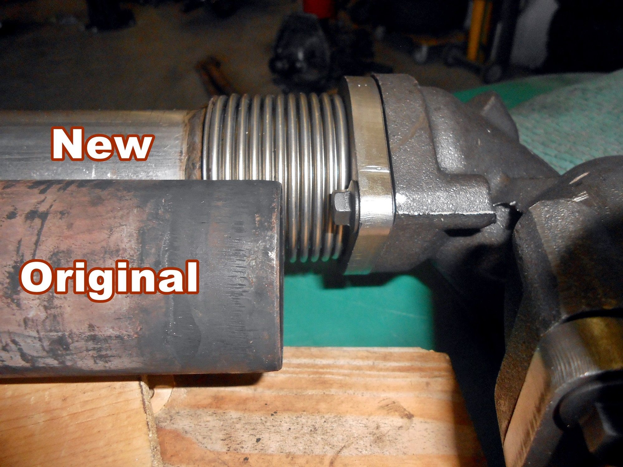

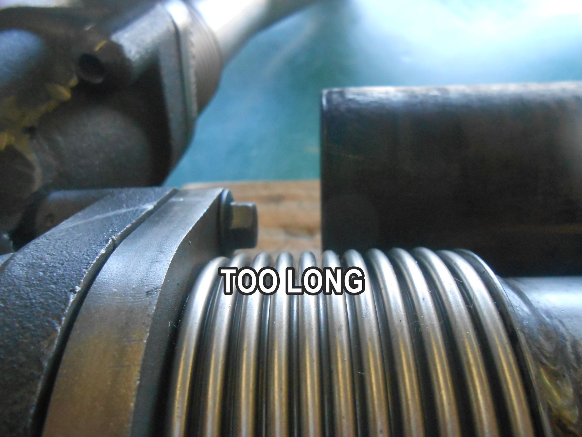

Turns out you are right Mark Kovalsky there is nothing wrong with the transmission. I believe the Transfer Case is what's wrong and do I feel stupid for pulling the Transmission wish I would have let it be. Now my friend says it is a good thing we pulled it because the up pipes are easy to get to now. So I ordered them through Amazon and paid $65.00 not impressed , they just don’t fit made in China or I am not installing them right. The Drivers seem to long & where the bends are suppose to be they seem wrong. I think I am dealing with a quality issue here. Do I need to order from RiffRaff? And should I be ordering parts for a EARLY 1999 seeing how my door tag says 02/98 ?

A truck built 2/98 is an early 1999.
