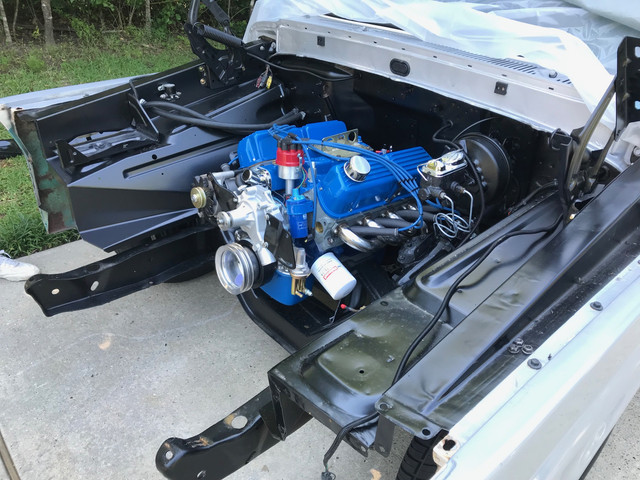

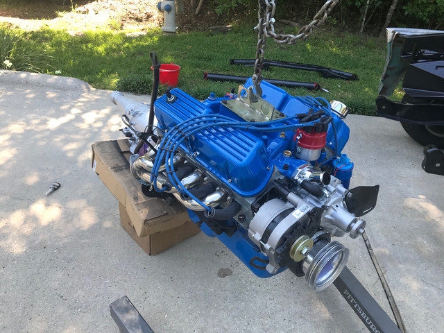

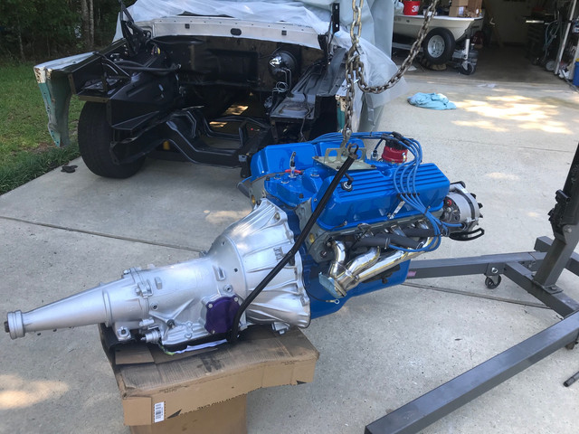

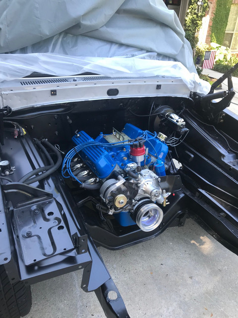

Motor is in!
Old May 18, 2019 | 01:18 PM
BayStYat's Avatar
BayStYat
Joined: Feb 2019
Posts: 243
Motor is in!
Finally
upload image
upload image
upload image
upload image
upload image
upload image
Old May 18, 2019 | 03:47 PM
Lrrr-RulerOfOmicronP's Avatar
Joined: Sep 2018
Posts: 1,223
Likes: 119
Looks great!
Old May 18, 2019 | 04:39 PM
Tedster9's Avatar
Tedster9
Joined: Apr 2002
Posts: 19,311
Likes: 97
From: Waterloo, Iowa
Wow, looks clean enough for surgery!
Old May 20, 2019 | 01:18 AM
GaryKip's Avatar
GaryKip
Joined: Aug 2015
Posts: 4,093
Likes: 14
From: Lind, WA- Eastern WA
Very nice! And so clean!! The engine bay looks so big too.
