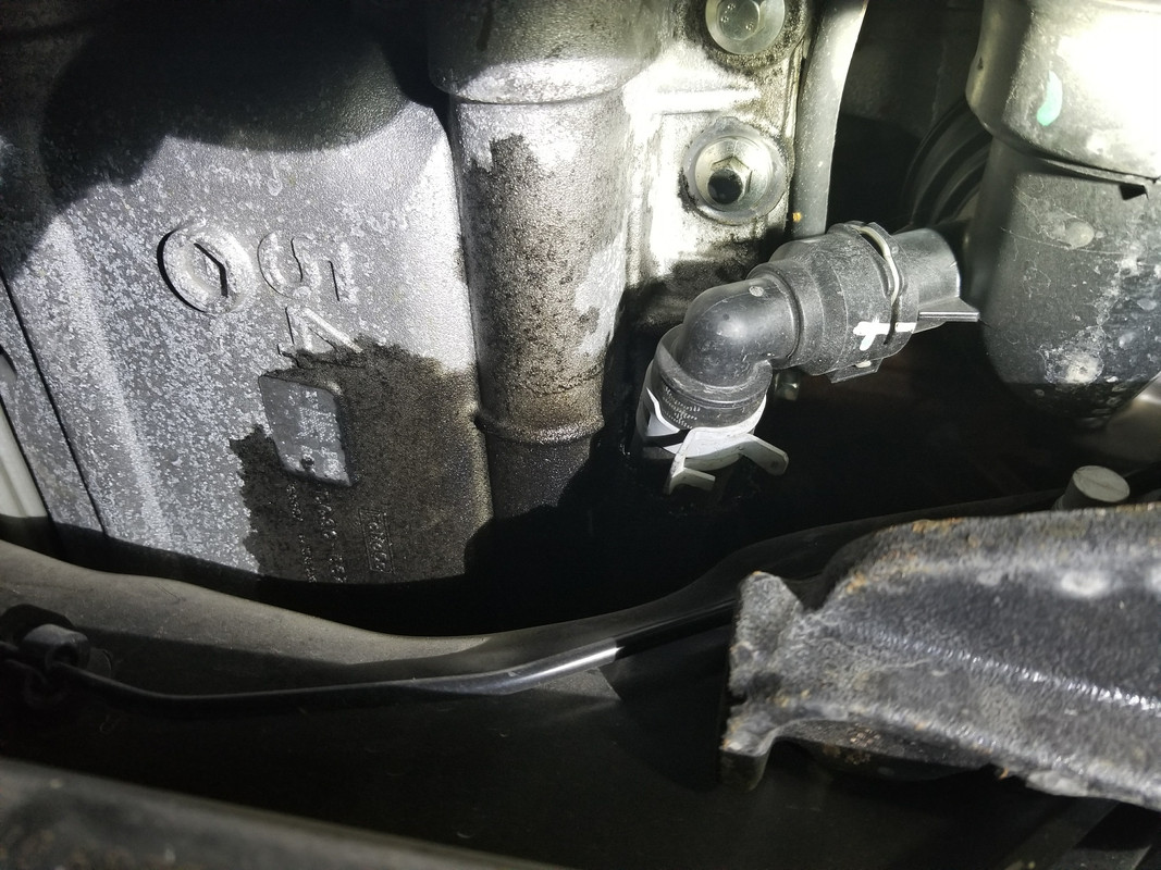

The 6.7's are having issues with leaking upper oil pans from the factory. Even the 17+ trucks still have this issue. The bots are not applying enough silicone in the corners, which is causing oil seeping. Most will be repaired under warranty. Unless you crawl under the truck and look you wouldn't notice the leak (it's not enough to drip on the ground). Only reason I mention this is because it's a rather labor intensive fix to get at the upper oil pan.....The transmission has to be removed to access the upper bolts on the upper oil pan. We haven't had enough feedback from users if this issue returns later down the road or not.
This is after 10k miles
I just went through this with 2014, I was under and looked at it and swore it was the pan but turns out it was the vacuum pump gasket, It comes comes down right at dead center of the pan in front. It cost half as much to get it done (had to go back to Alberta straight from Louisiana) and they didn't have to pull the oil pans or trans. You do have to pull the fan and upper half of the shroud along with the serpentine belt
