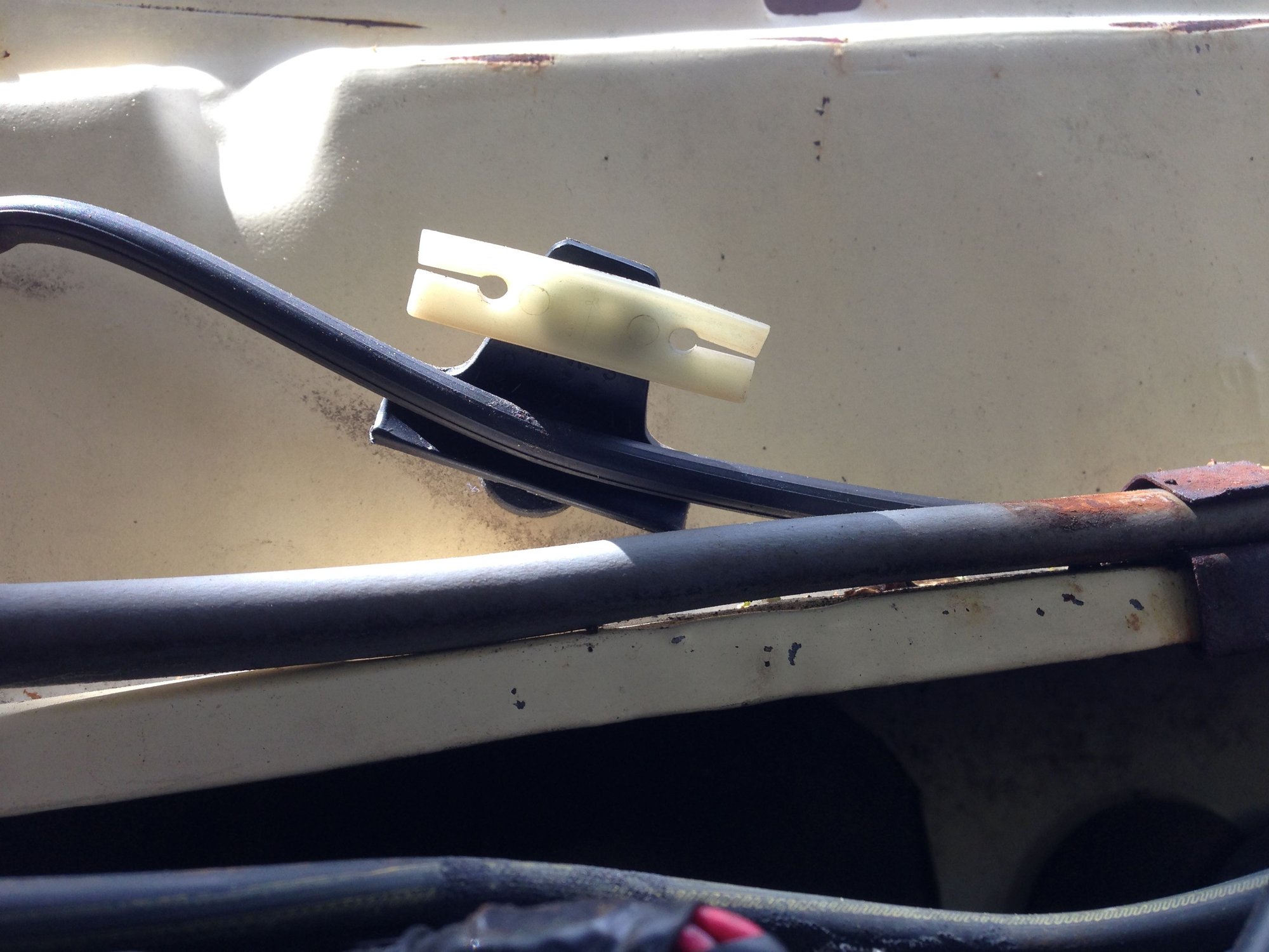

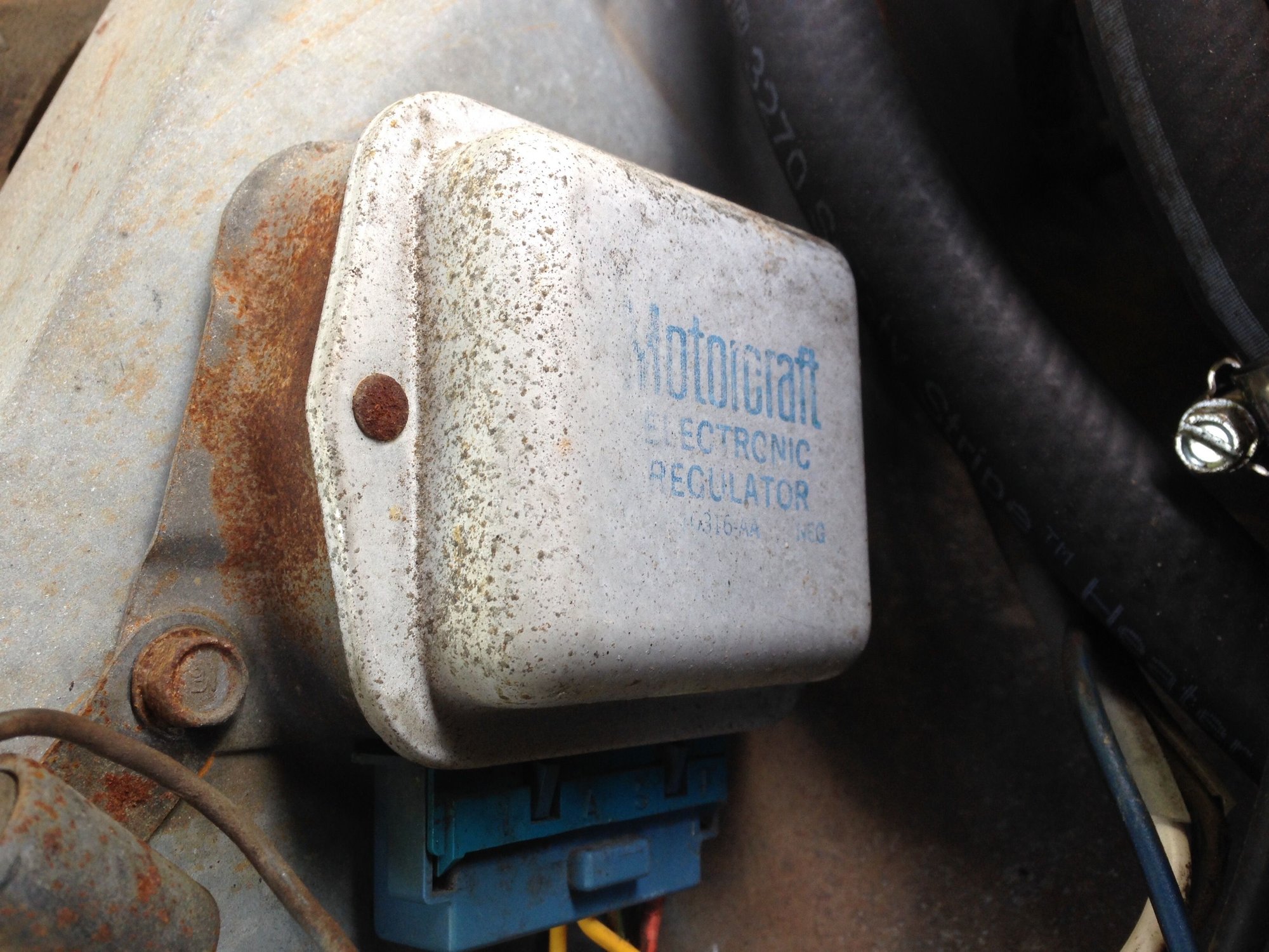

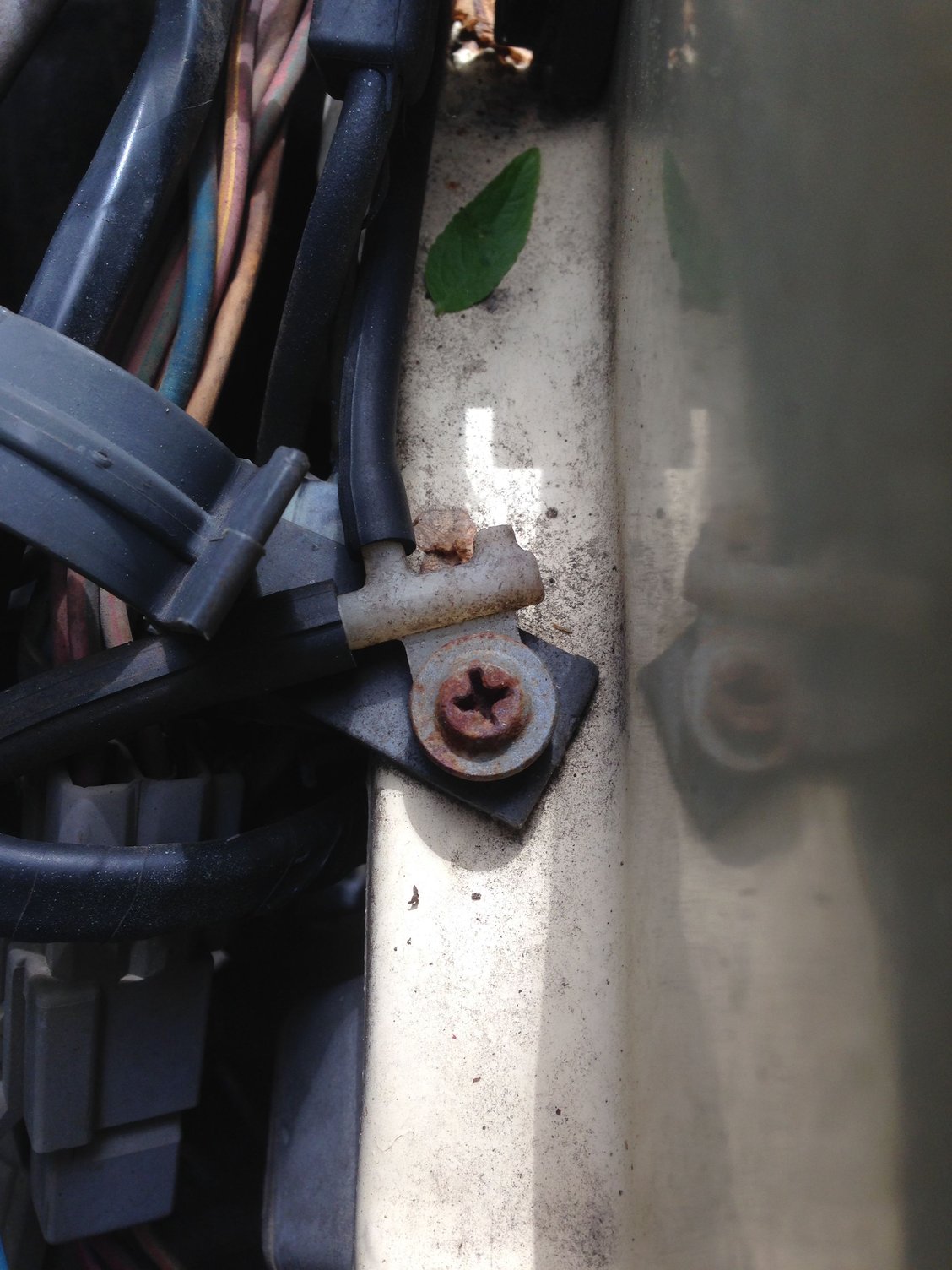

Looking for OEM part numbers for the 3-way plastic fitting the windshield washer hoses attach to below the cowl, the voltage regulator, and not even sure what the last pic is (cowl seal clip?) since part of it's missing, but it's on the passenger side windshield washer hose. These are for a '79 F-350 Trailer Special.

FOPZ-10316-A (replaced C3SZ-10316 A; D4TZ-10316-A; E2PZ-10316-A) .. Alternator Regulator-Electronic (Motorcraft GR-540-B) / Available from Ford & auto parts stores.
1963/64 Thunderbird; all 1965/90's FoMoCo vehicles w/an alternator (except those that have the regulator mounted on the alternator itself).
1982: Ford replaced the point type regulator with this electronic version, the part number was updated in 1990.

The rusty clip on the right in your pic is for the w/s washer hose. There's no clip pictured in the parts catalog for the cowl seal. So, I don't know what that clip is for, trace the hose it's attached to.
