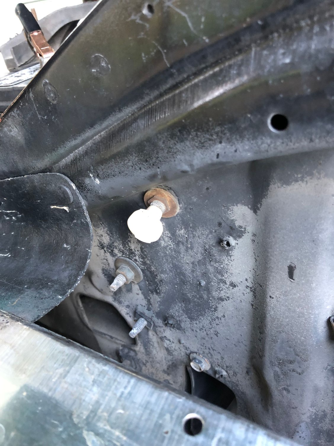

Old May 17, 2019 | 08:11 AM
Adam Woolridge's Avatar
Adam Woolridge
Joined: Sep 2015
Posts: 116
I spent hours trying to figure mine out too until one day I noticed a strange white plastic **** on my radiator support. I pulled on it, and voila! The light came on! Check around for a switch the PO May have installed. I never did check to see if my setup was factory. This is on a 79.
