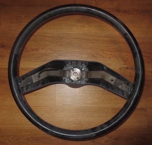

This steering wheel thread has me thinking that I'd like to switch my original 15" steering wheel for a newer 151/2" thicker steering wheel. I got the one in the picture at a JY a few years ago but I can't remember what year it came from (1985 F 150?). The number inside is D5AW-3D752. A large "X" and a "2" are also near that number. The flat ring in the centre of the metal spokes says BCF. Will this wheel fit my 1980 F 100?

Only one way to know.
Remove your wheel see if the horn rings on the under side are in the same place on both from the center of the wheels.
Then give it a try and see if it fits.
Non-Ford: I was able to take a mid 80's Jeep sports wheel, thick like yours, and use it on my 70 AMC Javelin.
I even swapped out the Jeep center for the Javelin bullseye. I never gave it a thought it would not fit.
D5AW is 1975 LTD, the same wheel was used thru 1978. It will not work on your truck.
1980/82 & 1983 F100/350, Bronco & Econoline before production date 8/83 used the same 2 spoke steering wheel.

That's weird because I know I didn't take that wheel from a 1970's truck; there weren't any in the 2 JY's I frequented. It looks like my existing wheel but thicker. Going to take the wheel off after I get an alignment and check it out.
