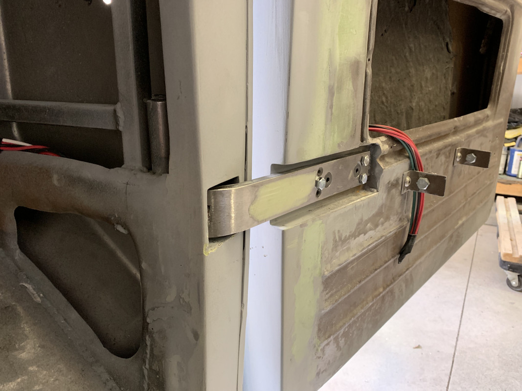

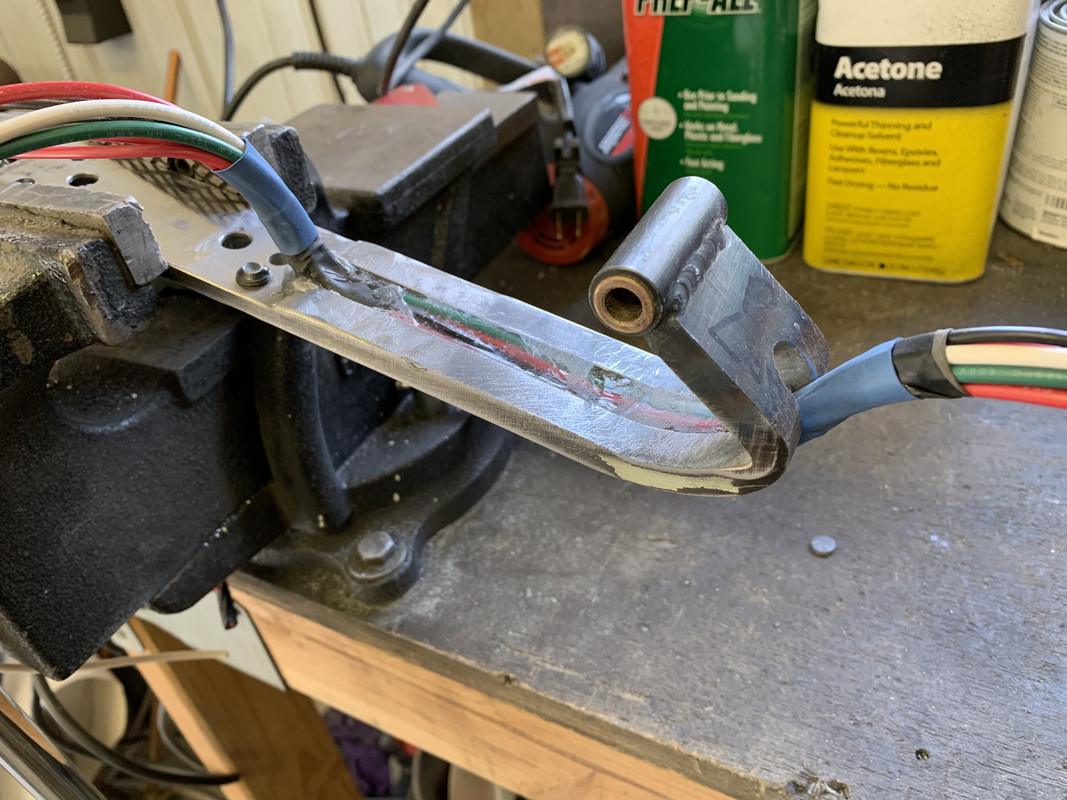

After installing hidden hinges the normal way of getting wiring into the door interior wasn’t going to work due to the angle of the door and pillar when open.
So I ended up cutting a slot through the center of the hinge and welding in a thin plate to create a channel. Then I bonding the cables into the slot.
Now all that is needed is to provide a loop in the cable where it enters the kick panel area.

Nice work! Keep the pics coming!

Great idea!

Very slick!

Nice solution! I bet that took some time?

I took a similar route but lots easier 3/8" copper tube with a tab soldered on... couldn't get my paint to flow that day... cold.
really nice work JBT... dedication !!!

Probably a couple of hours for the first one, hoping the second side goes quicker. By the way I used Marine grade flexible wire to allow for the additional flexing that it will go through every door opening!!
