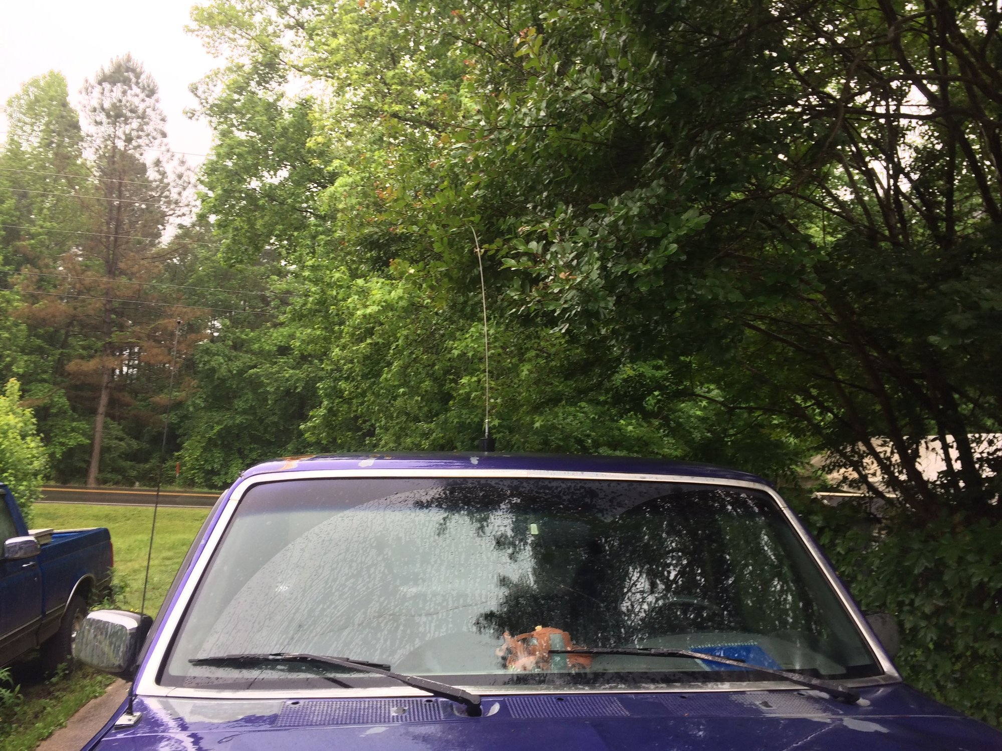

Should be good for what you want then. When I was younger everybody in the group I ran with had CBs. And were always on, hell you could get an answer fast than a phone call back then. I had an old Bearcat that the local radio guy tweaked with a big booster and a good whip, I'm gonna guess at the range between 10 and 20 miles. But I could also jack the mic button and mess with florescent lights at a gas station...
Not a good pic but heres some of the antenna lol this was the short 84 inch fiberglass one before I went to the 102" steel one
