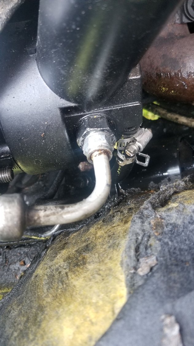

I'm leaking PS fluid out of the above fitting. It's tightened, but the hardline has play to it where it fits into the nut. What is this part called, and how to I replace it? Also, I'm not running actual PS fluid, I just use that for brevity.

Only fix I know is replace the entire hose.

Got with hitman x, who is local to me, didnt realize you just needed to replace the whole line.

Yep. Do low hose too, if truck is a keeper run a MAGNEFINE filter. More capacity for system and cleaner.
