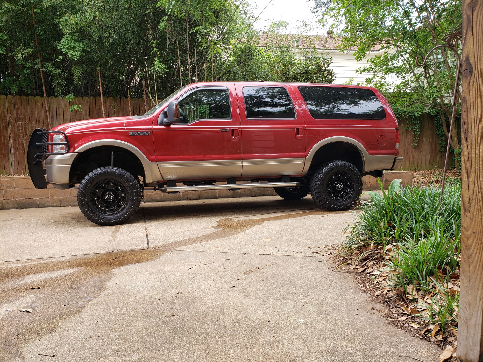

Very good point and that suggestion is worth alot. My thyroid very suddenly went bad and will soon be removed, but has resulted in me having very bad problems with my left eye after doctors speculated then rejected everything from glaucoma to brain cancer. How's brain cancer for a GUESS?! That guess heaped worry and cost alot to dispel. My vision will probably return to normal with time and possibly surgery, but for the time-being I basically have to see through my right, only. This came on in very few short months. I quickly installed a rear camera, and a double DIN stereo with a big screen for backing up and seeing that camera, but my left mirror is a big issue changing lanes and backing into and out of parking spots and other places. I also did a lift, myself, Easter weekend, that changed where my mirrors are and in present circumstances makes me nervous about hitting things for some reason. In truth, the doctors did not know what was wrong with me for some time but I was unable to drive or work normally, so I stayed home or had a driver for a few weeks and did alot of work to the truck as an encouragement to get better from whatever was wrong, thinking I was either dying (it also affects your heart and other things) and/or going blind while taking medications that gave me boundless energy and kept me awake all of the time. There, I said it; thought something was ending me. That's truth.
I have several vehicles for my own use and the Excursion is my favorite now but I also had just gotten the new truck bug early thjs year and when I test drove a couple the prices made it okay to spend money on the Excursion to just make it nicer and more modern. And I had the time and needed something to do. And in my circle putting a lift on a vehicle is a jackasssed thing to do and I never shy from those things, either. Having mud tires and black wheels and working in my own vehicles (always done that) while my peers never drive anything over a year old? Haha well let's say I am becoming a legendary jackass. Haha.
It isn't big.
