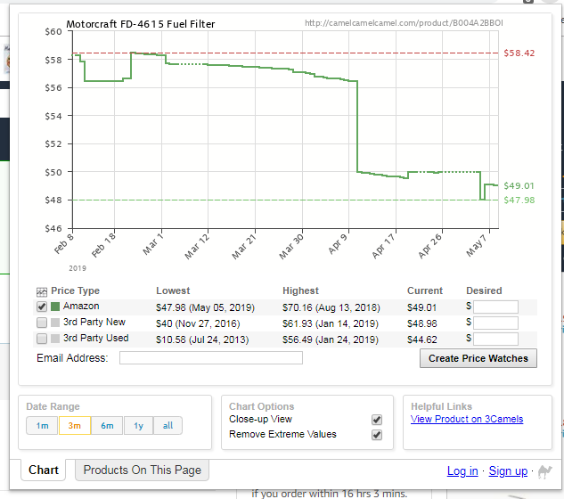

I usually buy the fuel filters here at Amazon:
https://www.amazon.com/Motorcraft-FD...s%2C178&sr=8-5
That's a darn good price. It looks to be trending downward recently. If I didn't already have three sets of filters on the shelf I would add that to my cart!

That's where I've been buying them. You can't beat the free Prime shipping deal IMHO.
