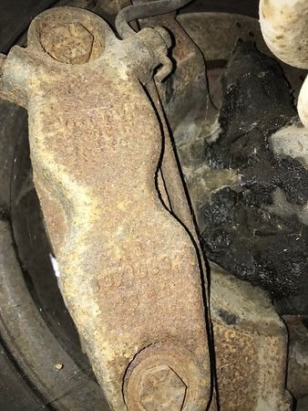

I have a '76 F250 with the 460, and need a new master cylinder. If I am looking at this photo correctly, I need the one for the dual-piston calipers:
so this would be the one?

Yes that Is dual piston, do you have power brakes?
Also, I bought a reman original last april and used it for a month before parting out truck, I will send it you, if you just cover shipping. Hate for it to go to waste.

D6TZ-2140-G .. Master Cylinder 1 1/4" diameter - Use with Dual Piston Calipers and Power Disc Brakes with or without Speed Control / Obsolete
1976 F250 2WD/4WD & F350.
