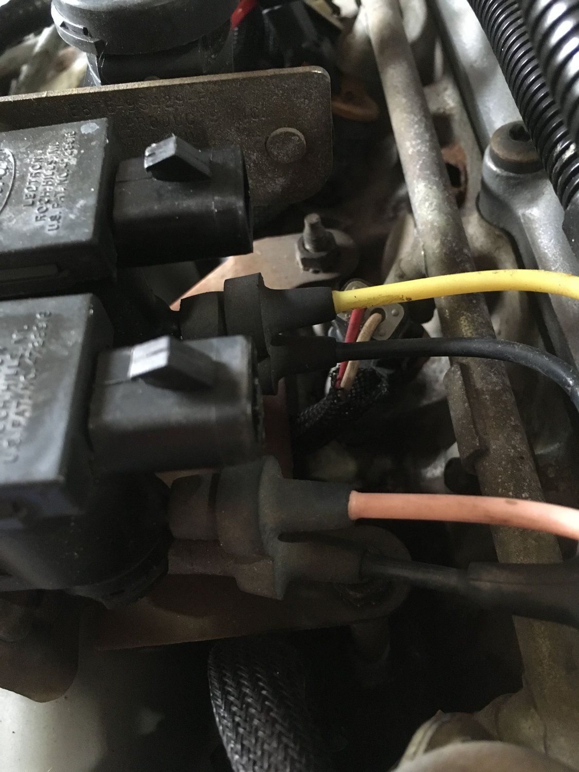

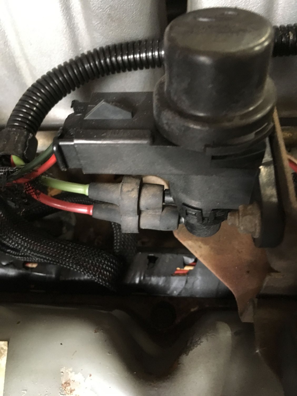

I’ve pulled my motor and I have a quick question regarding what vacuum lines I can cap since I’m eliminating the egr and thermacator. I included a few pics to help aid.

Really all you can get away with removing this thermactor air injection, smog pump, and cats. Maybeee EGR if you install the valve backwards or use a piece of tin between it.
I believe the tab tad solenoids need to stay hooked up, but just plug any lines that went to the smog pump or diverter valves/
Anything else you do will cause it to run like crap and/ or waste your time.

Thanks guys, I’ll leave the EGR setup intact and get a new hose for under the intake connector and will leave well enough alone with the other vacuum lines. I did delete the smog pump and thermactor so will plug what needs plugged. I did remove both canisters on wheel well so sounds like I need to reinstall 1 of those for a vacuum?
Believe so because the hvac and cruise control run on vacuum. The level of vacuum fluctuates when driving, so a reserve is needed.

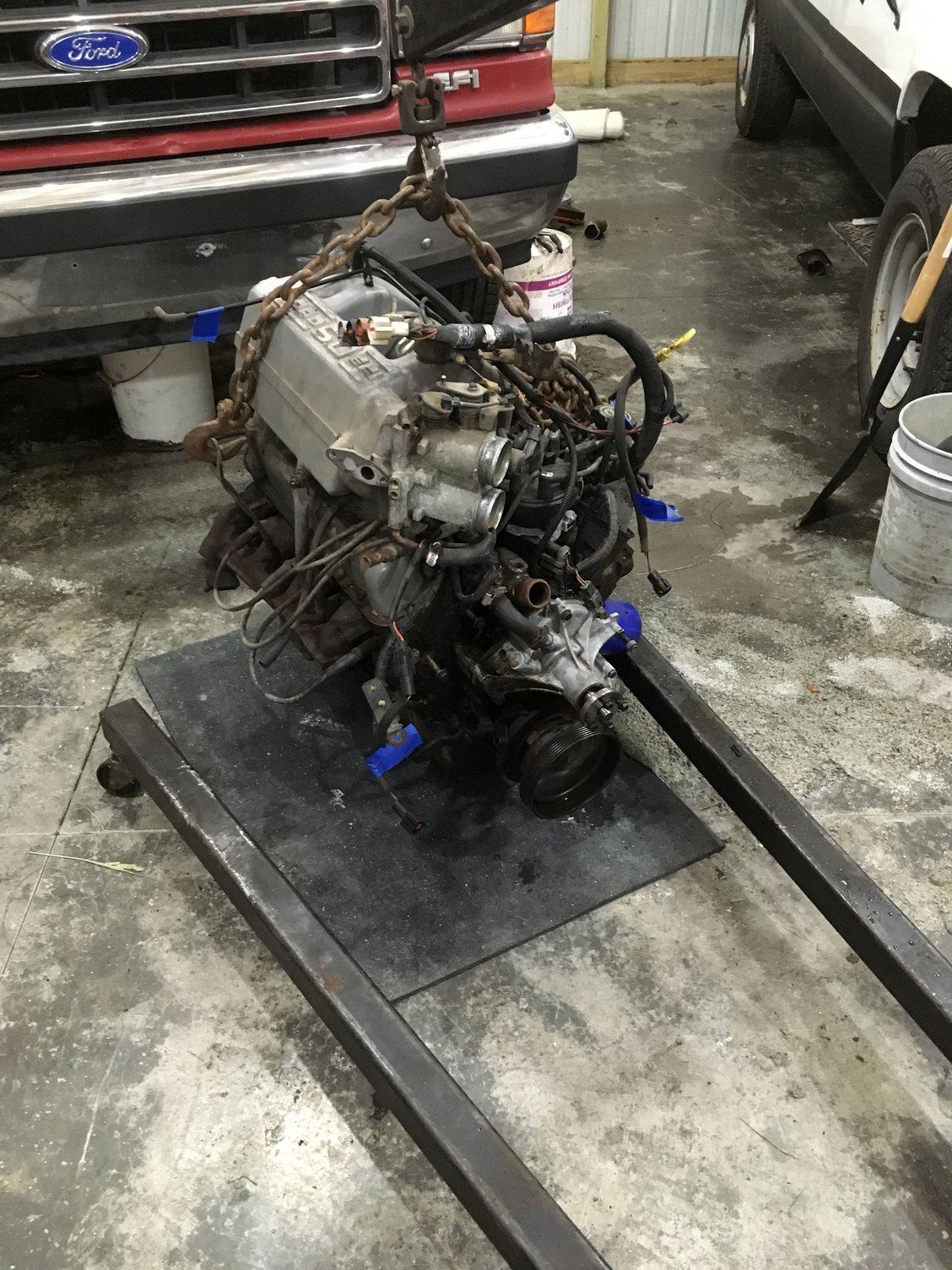

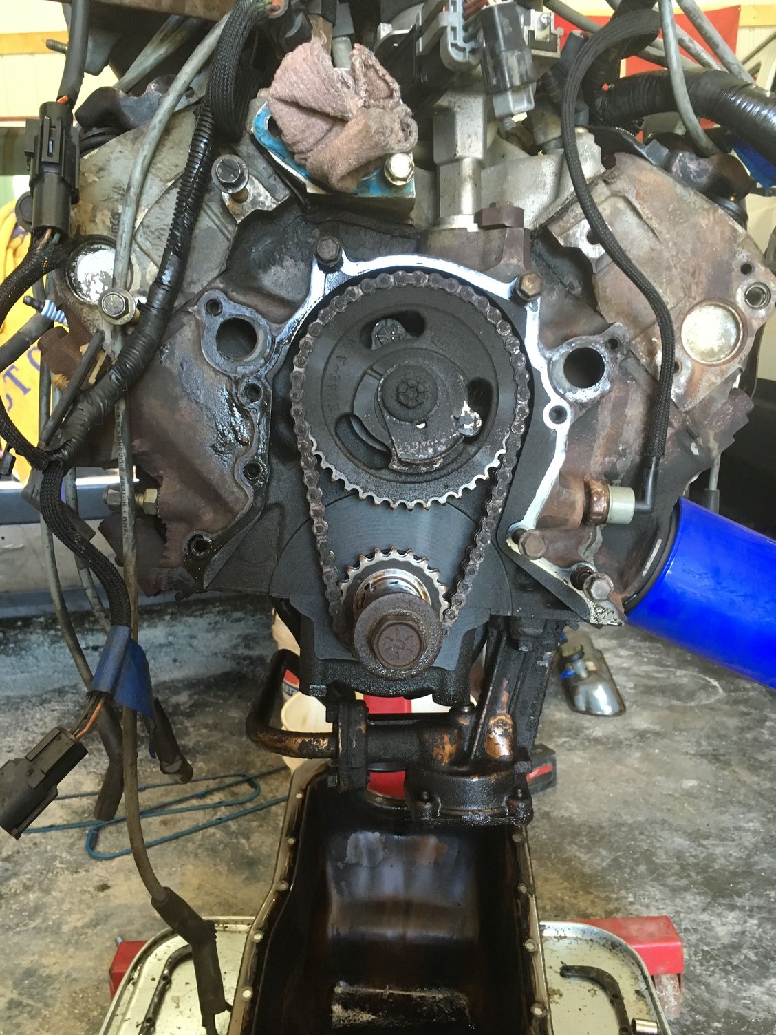

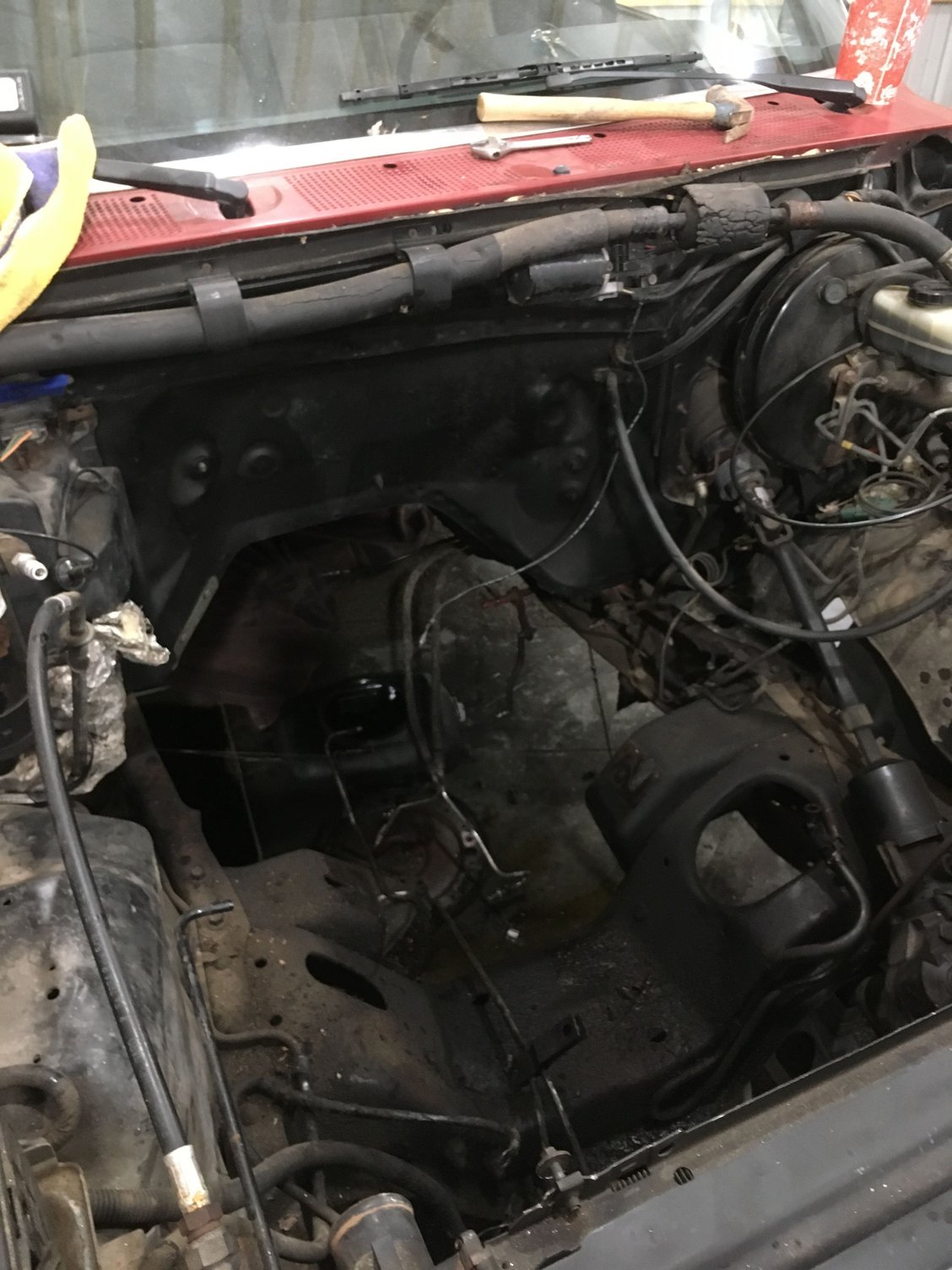

Here’s a few pics, I’ve cleaned, power washed And painted a lot of parts and areas to get it more presentable since these pics were taken. I’m on to replacing gaskets, water pump, timing chain and oil pump now.
