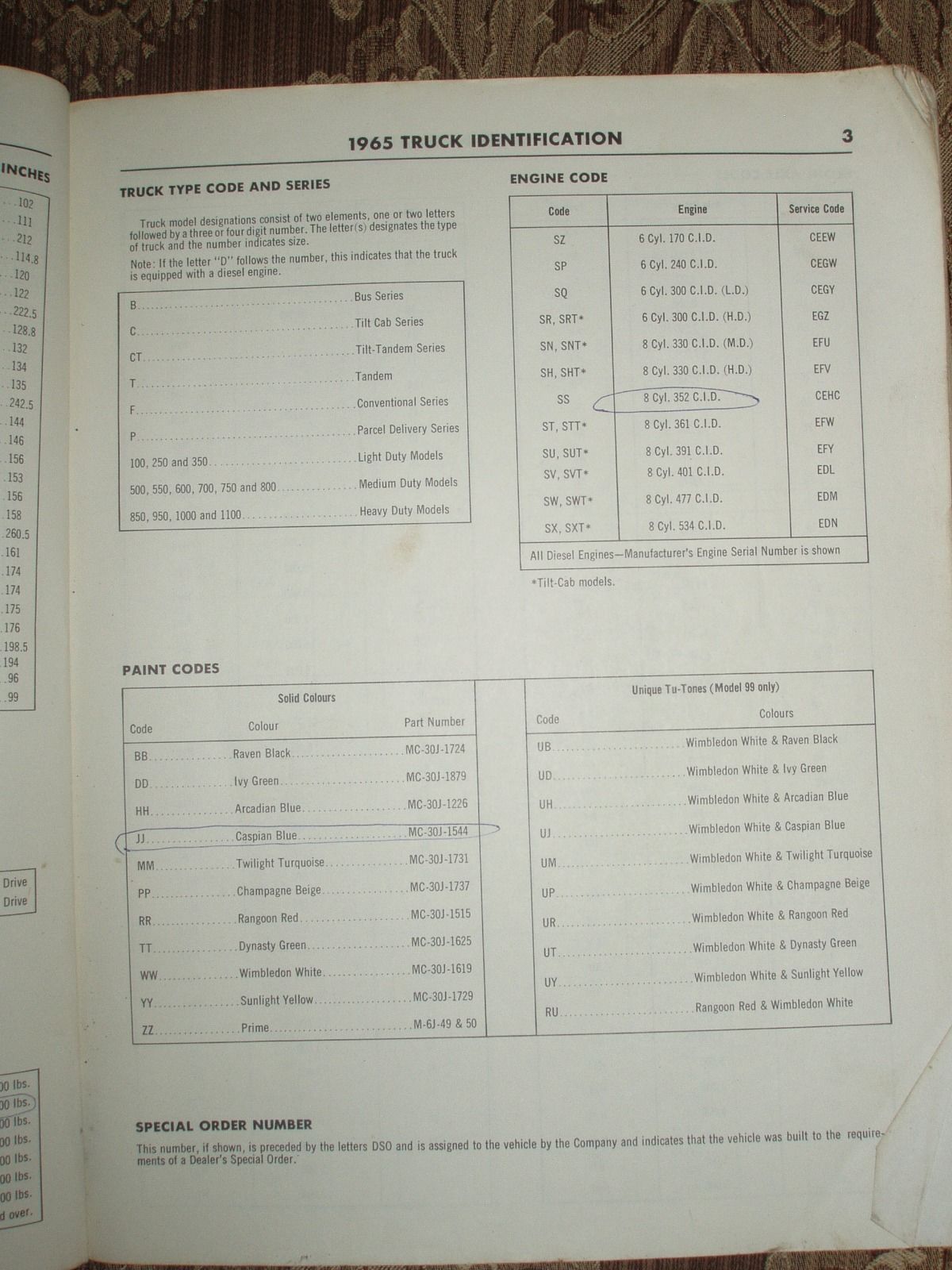

Neither the 1964 or 1965 info on Fordification seems to cover the RN or SN engine codes, but lots of easy to find info there. I have a few pages from the 1965 manual that help with the SN engine code. Or the 1964-1972 MPC also lists the engines for 1965 Canadian, but oddly not 1964.
Ignore the circled items.

Chad as I mentioned a couple posts above, for the early CDN produced Slicks, the Warranty/Data Plates and the codes/nomenclature used bare no resemblance to the US ones.....'65 was a little closer, '66 is the same.
Oh, and some of the info on Fordification is for F100 thru F350, as the heavy trucks had their own shop manuals....
