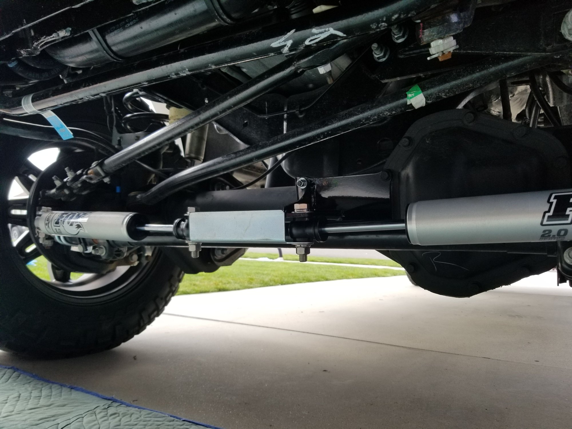

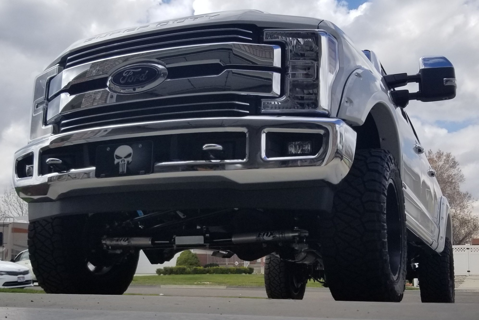

Installed the Fox Duel System and it drives as good as it did when it was stock (before level kit & 35's). Absolutely love the ride.
2019 F350 Lariat Ultimate Pkg
