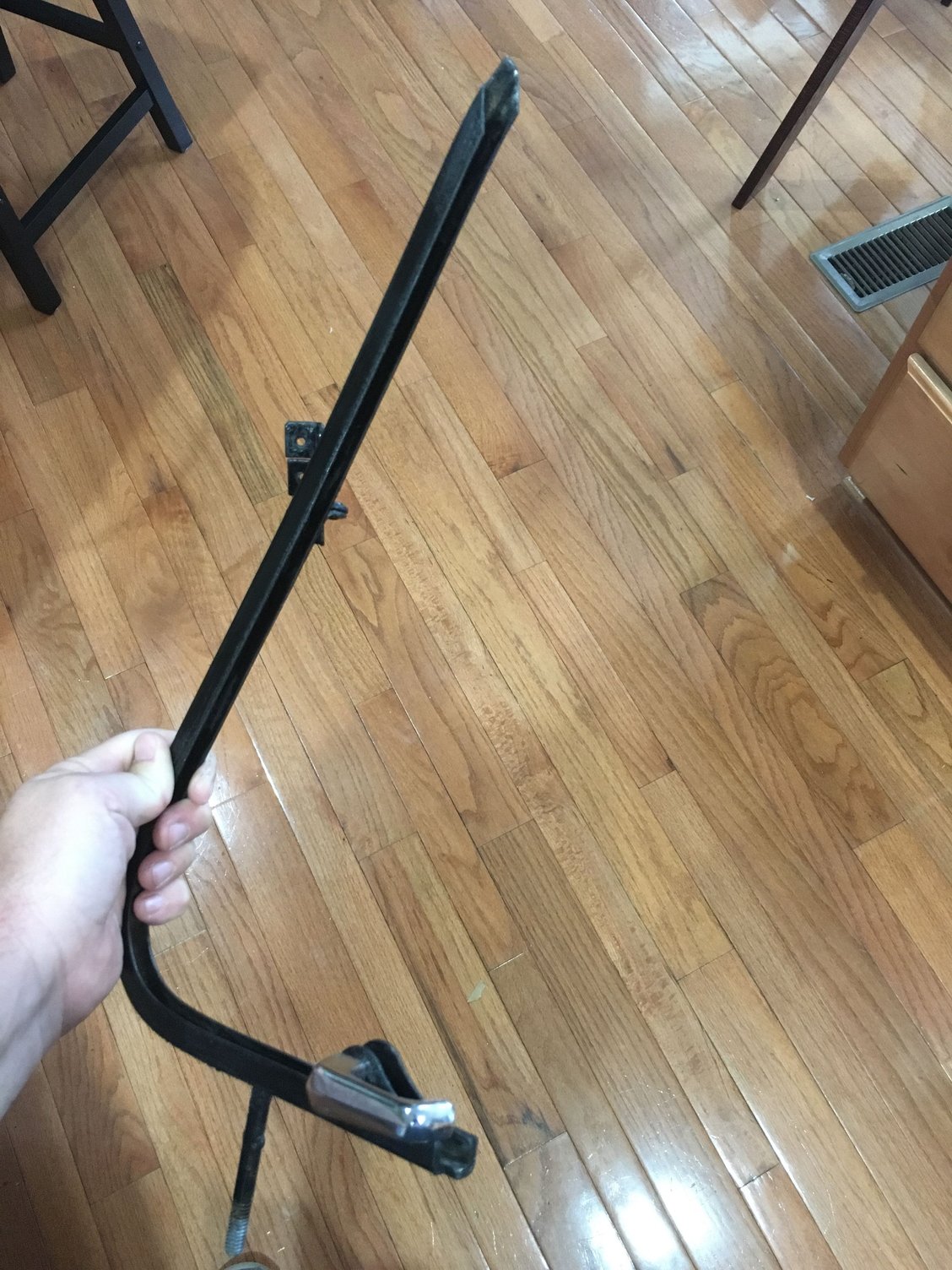

Changing all of the glass in my truck to green tint. Using a torch I easily remove the old vent window . Where can i find a replacement glass seal for the frame? LMC doesn’t have it and a google search only brings the weatherstripping seal i already have.

Glass to frame adhesive? Have you checked any local windshield/glass shops for "glass setting tape"...Check out this intensive rebuild thread. Joe talks about using that to secure the vent glass to the frame.
https://www.ford-trucks.com/forums/1...storation.html
Looking for the post # where he discusses it.
OUT https://www.ford-trucks.com/forums/1...l#post17158358
https://www.ford-trucks.com/forums/1...l#post17166938
Used "glass setting tape" https://www.ford-trucks.com/forums/1...l#post17237518
https://www.bobdrake.com/glasssettingtape

Thank you, I’ve never seen that thread… What a nice truck! I’ll use exactly what you said, some glass adhesive. Thanks, i think i was chasing a unicorn by looking for a precut fitted seal.
It's called "glass tape" available from any auto glass shop.
