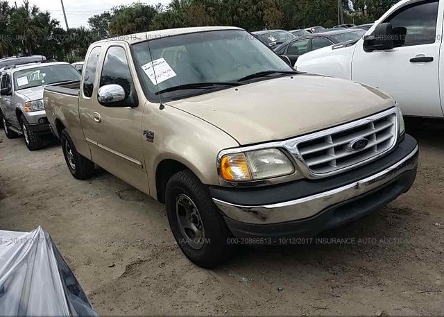

Originally Posted by Don52M3
Maybe some one can tell by this. It was a flood damaged vehicle, and yes I opened up the read to see if it had any water.
Thanks
Don52M3
1FTRX17W0XNC06628, Certificate Of Destruction (Bill Of Sale Or For Export Only) gold Ford F150 at SANFORD, FL on online auction by January 03, ...
https://www.google.com/imgres?imgurl...source=sh/x/im
This truck would have metric pattern lug nuts. It's not the traditional 5 on 5.5 that we all knew and loved.

When Ford changed the bodystyle in 97, they changed the lug pattern to metric 5 on 135mm (5.315"). All F150's 97 & newer have metric lug patterns.

Pretty cool that you could find a picture of that truck. When I first seen it at a LQK it was all there, I removed the axle and the next day it was stripped.

All I did was type the vin into the google search bar, and the interwebs did the rest. I do this all the time looking at used cars to see if there's any salvage activity on them. It's amazing what you find that dealers say are "clean, one owners."
