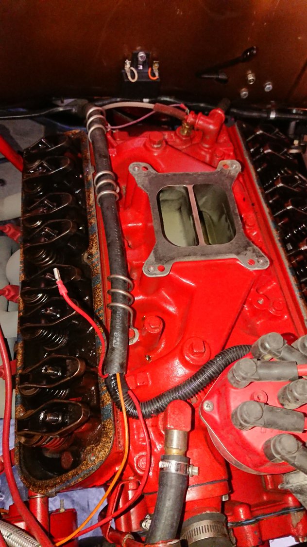

I have a 302 year 1973 I thought it was hydraulic lifter, but I don't think it is so. It seems like the rocker arm is tightened completely, and there are no adjustment options.

I can't see much in your pictures but if there is no adjustment it has to be hydraulic. and yes they'd be tightened all the way down because the lifter does your adjusting. .
Hydraulic lifters require a preload , if you're having problems you may have to check it and correct it.

Yes, most likely a '73 302 was a non-adjustable valvetrain. Kind of nice actually, as long as everything is in good shape. Just turn them down and set to something minimal like 28lbs of torque (but don't quote me on that without verification!) and done.
They still recommend you do it in a sequence so that there is less stress on the simple pressed-in studs (not the best idea, but it did work for millions of engines over bazillions of miles.
There is still a "check" you can perform when doing this. You turn the nut to zero lash then count the number of turns to stop. It should fall within a small range, but if so, you're gold because there's quite some leeway in most hydraulic lifters.

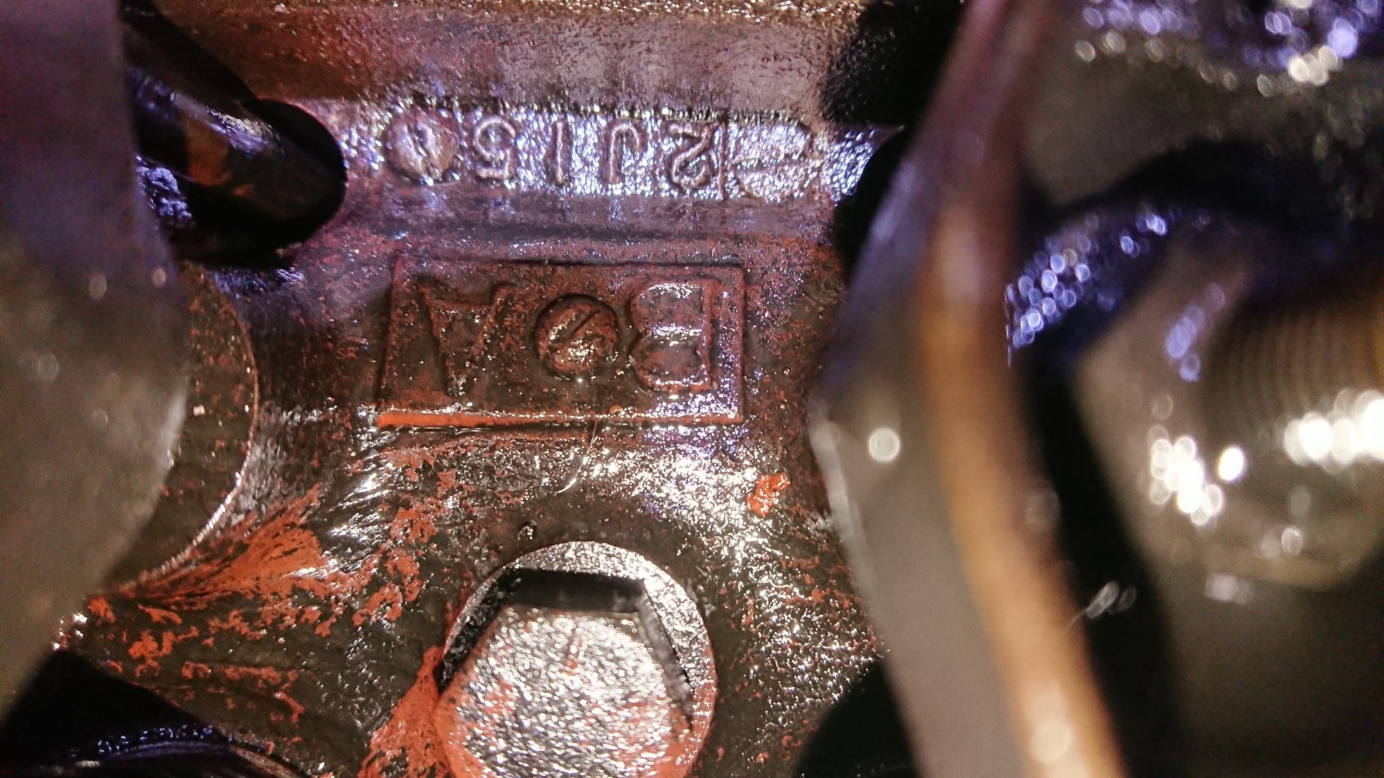

Oh, and thanks for posting up the casting codes for the head too. I don't know anything about them, but someone will be able to decipher to make sure they're '73's and are indeed supposed to be non-adjustable.
But you can tell just by looking at the pedestals and rockers.
Paul

No 302 had adjustable rockers except the Boss. Just wind them down till they stop and torque to spec. The engine can be in any position to do this. That's all their is to it.

If the parts are stock and installed valve height is stock preload was done at the design stage when pushrod length was selected. There is no adjustable preload, torquing to spec is the preload.

2J15 = Head cast September (J) 15, 1972 (2).
Since historically new vehicles are introduced in September of the previous year, this head would have been installed on a 1973, possibly other years after 1973 as well.
