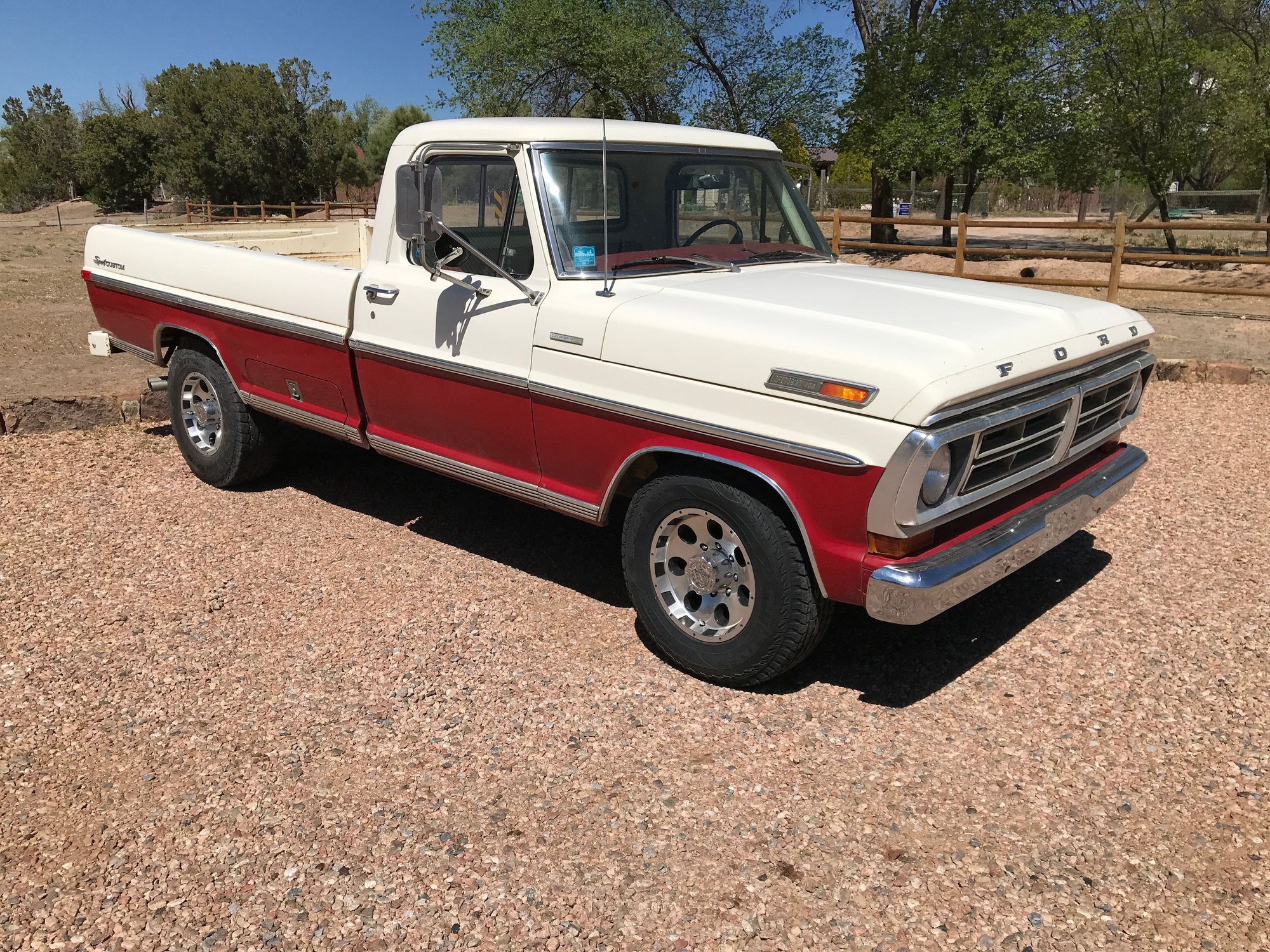

So I'm starting to tear into my 71 F-250. I figured I'd start a build thread to document all the work I'm going to do to this thing.
What it looked like when I brought it home.

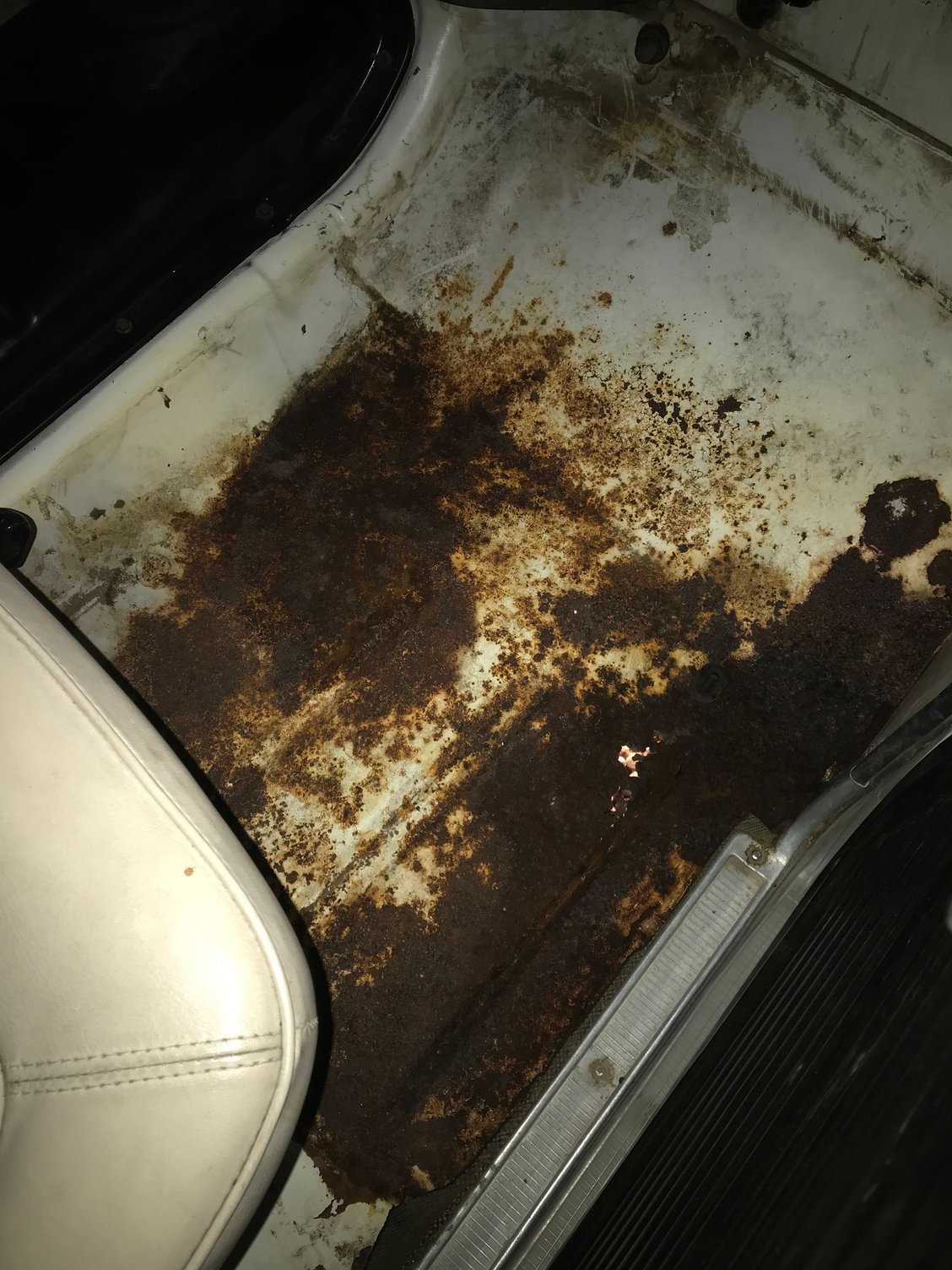

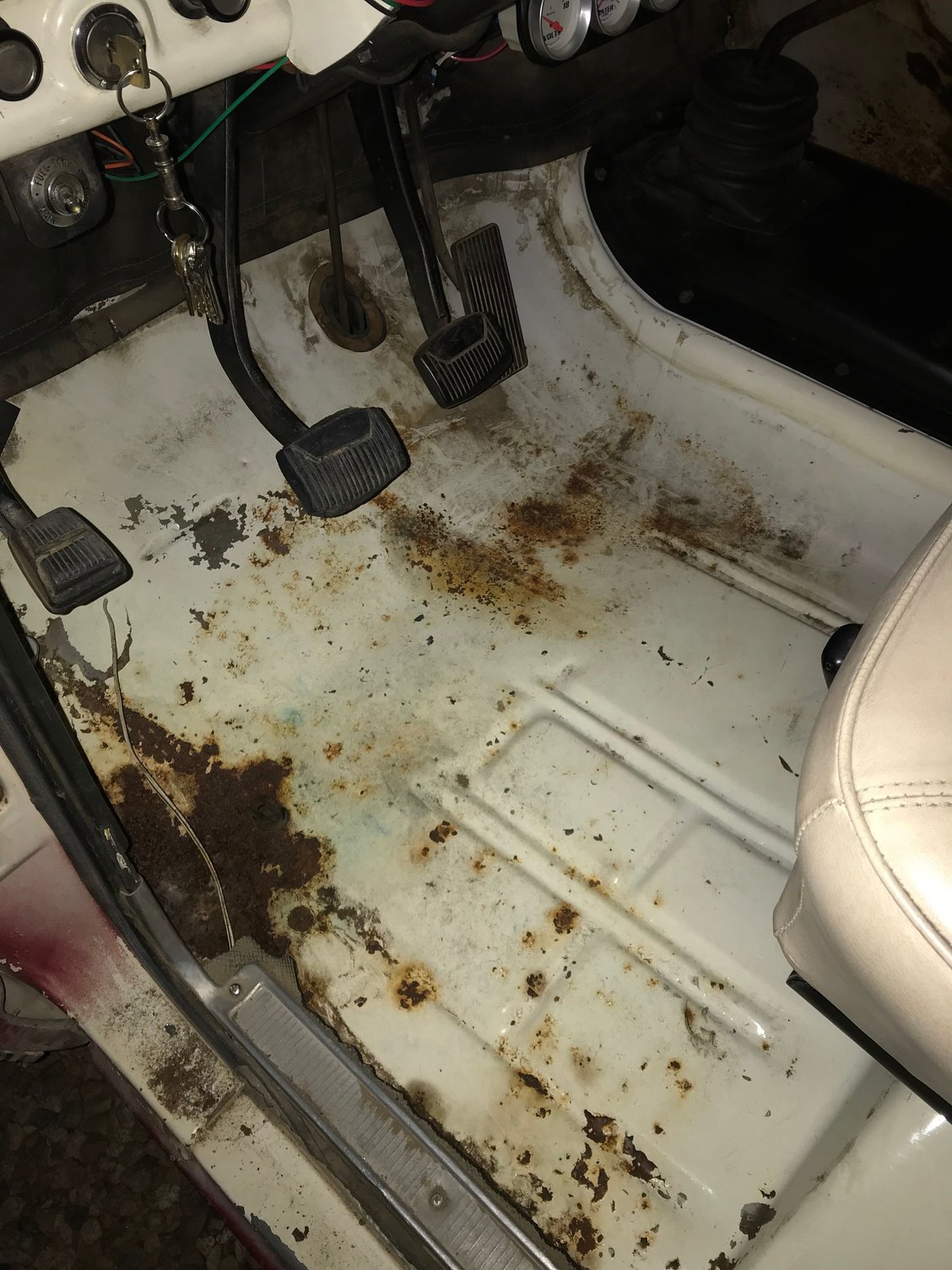

Well, I started tearing into this thing and it looks like the floor panels are bit worse off than I hoped.
Driver side. Not too bad, but you can see light coming up from underneath and the kick panel needs some work as well.
Passenger side. Lots to cut out along with some of the kick panel.

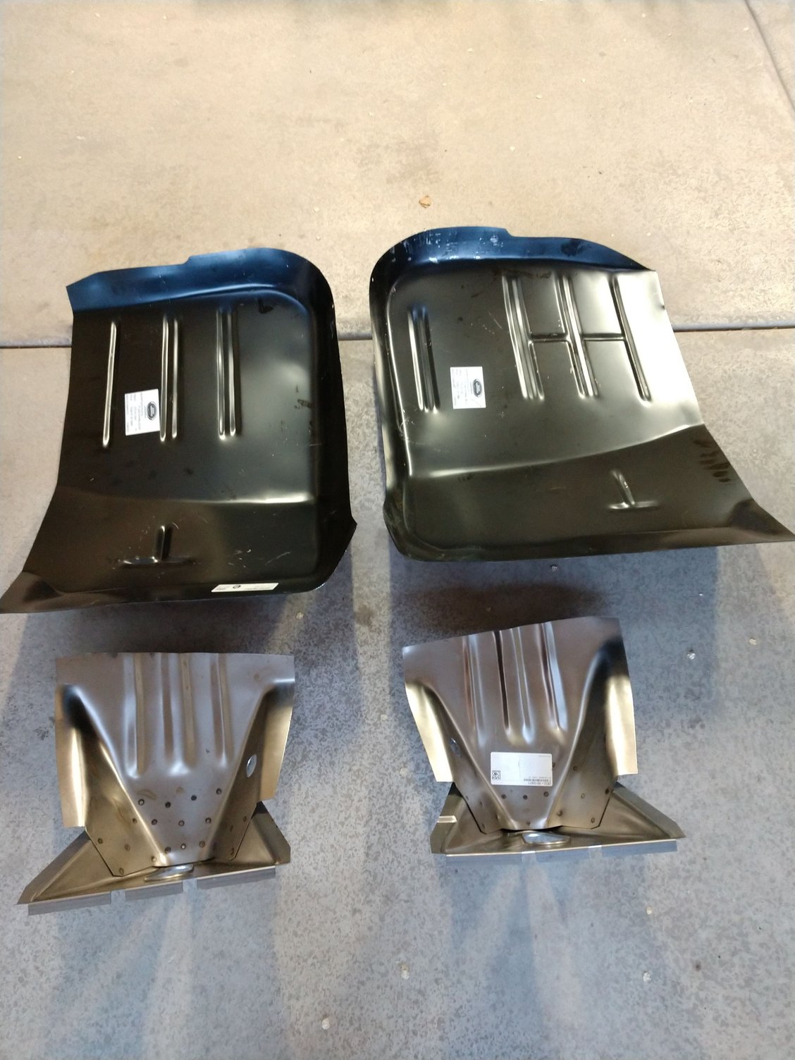

So I've already ordered new cab mounts (OEM type) and floor pans from Dennis Carpenter. Hopefully I can get started on replacing these in short order.

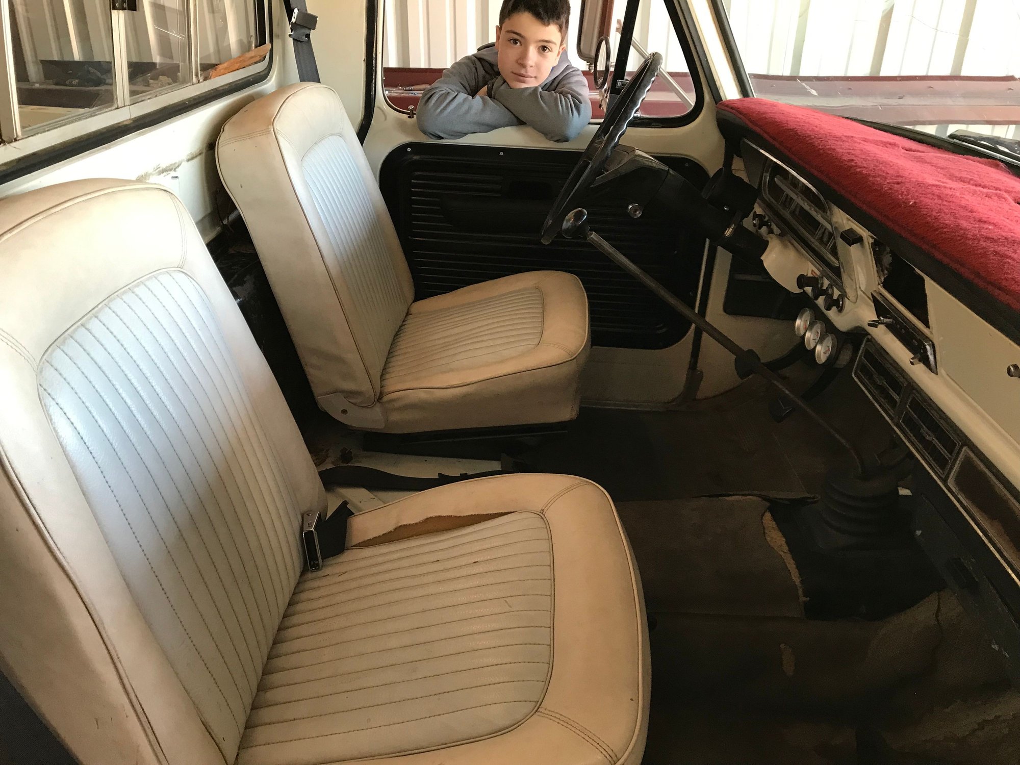

Does that truck have bucket seats?
It sure does. They weren't original as my nephew and I put them in last summer.
They sit up a little higher than I had first anticipated, but I'll get used to it. I'm 6'2" so the more leg room is nice. When I re-upholster them I'll be adding head rests as well.
I also used my nephew to add the 3-point seat belts. His arms are small enough that they fit up the side walls of the truck so I could bolt them in. Will be easier once the in-cab fuel tank is permanently removed.

Nice, I've heard that the bucket seats don't give any more room but I didn't think about them sitting up higher. I'm 6'4" so more room is good. I have a set from a 68 Ranger that I would need to have recovered.

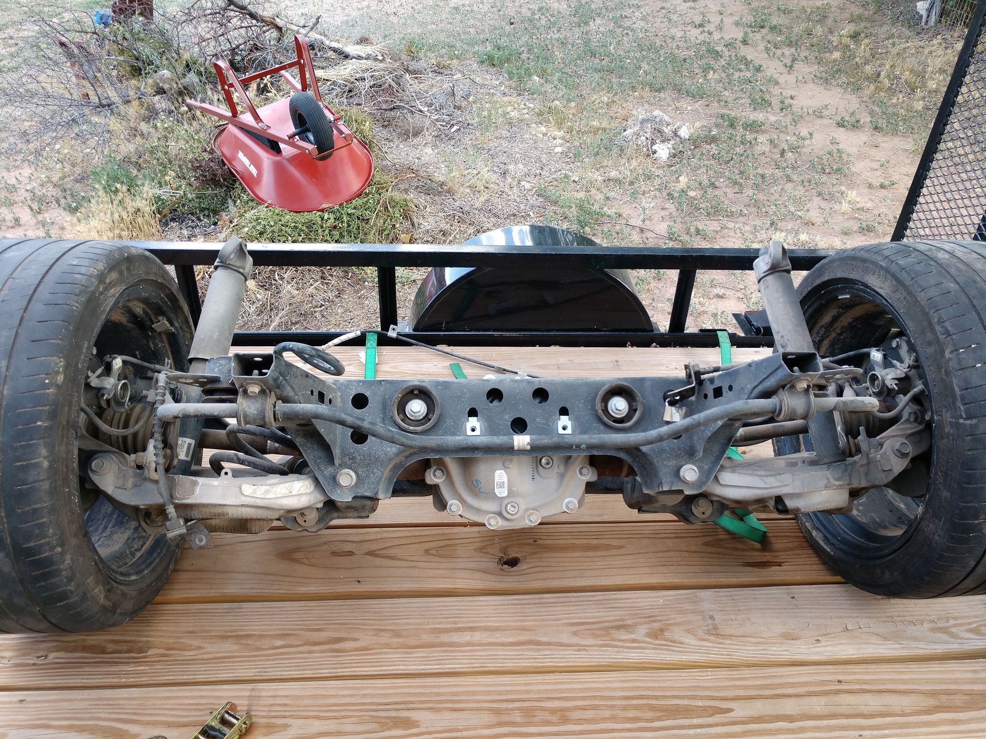

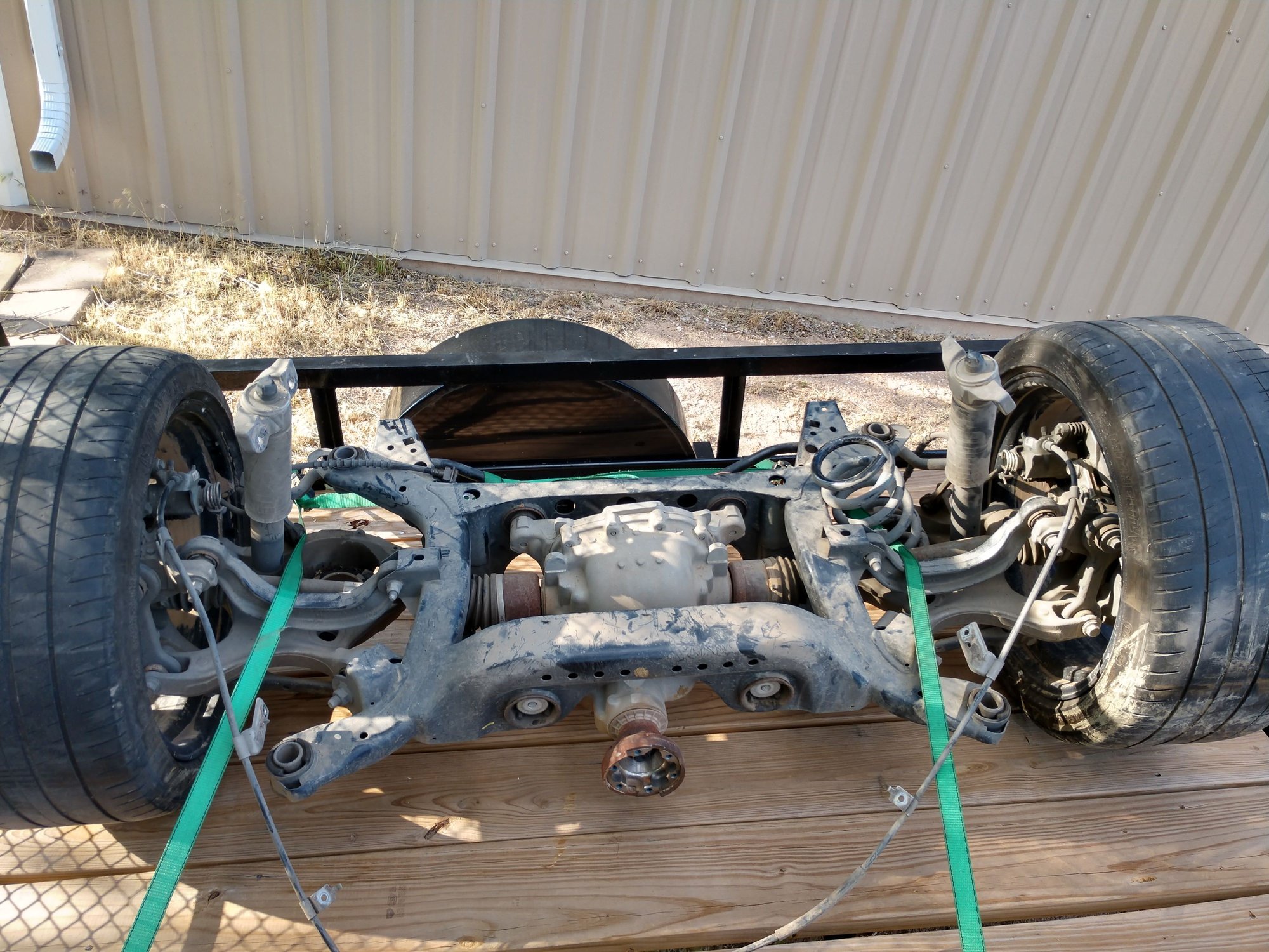

I did; however, end up getting the rear suspension for my build: 2015 Ford Mustang GT IRS...

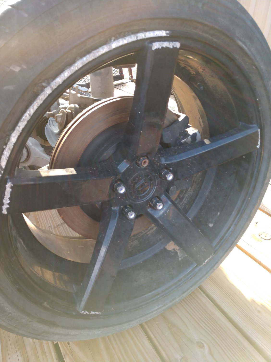

For a whopping $450 I can't complain. I found it locally (if Albquerque to north of Santa Fe is local) so I didn't have to worry about shipping and everything on flea-bay was $550+. Wheels are a weird brand and I can't find them anywhere online... searched quite a bit. Logo says ZR Alloy Wheels... One has a lot of rash on it so I'll just replace both of them... I'm thinking of OZ racing... in 18x8.5 all around. cheaper than the wheels I found that look similar to the ones shown below.
ZR Alloy Wheels, 20x10 on 5x114(4.5")
Wheel has a lot of rash, If I keep these, I'll need to replace this one.
So once I get the truck in the garage, I'll start pulling it apart. I'll be selling quite a bit off of this thing so when I pull things off, I'll let people know what I'll sell and put them in an add on the for sale section of this forum.
