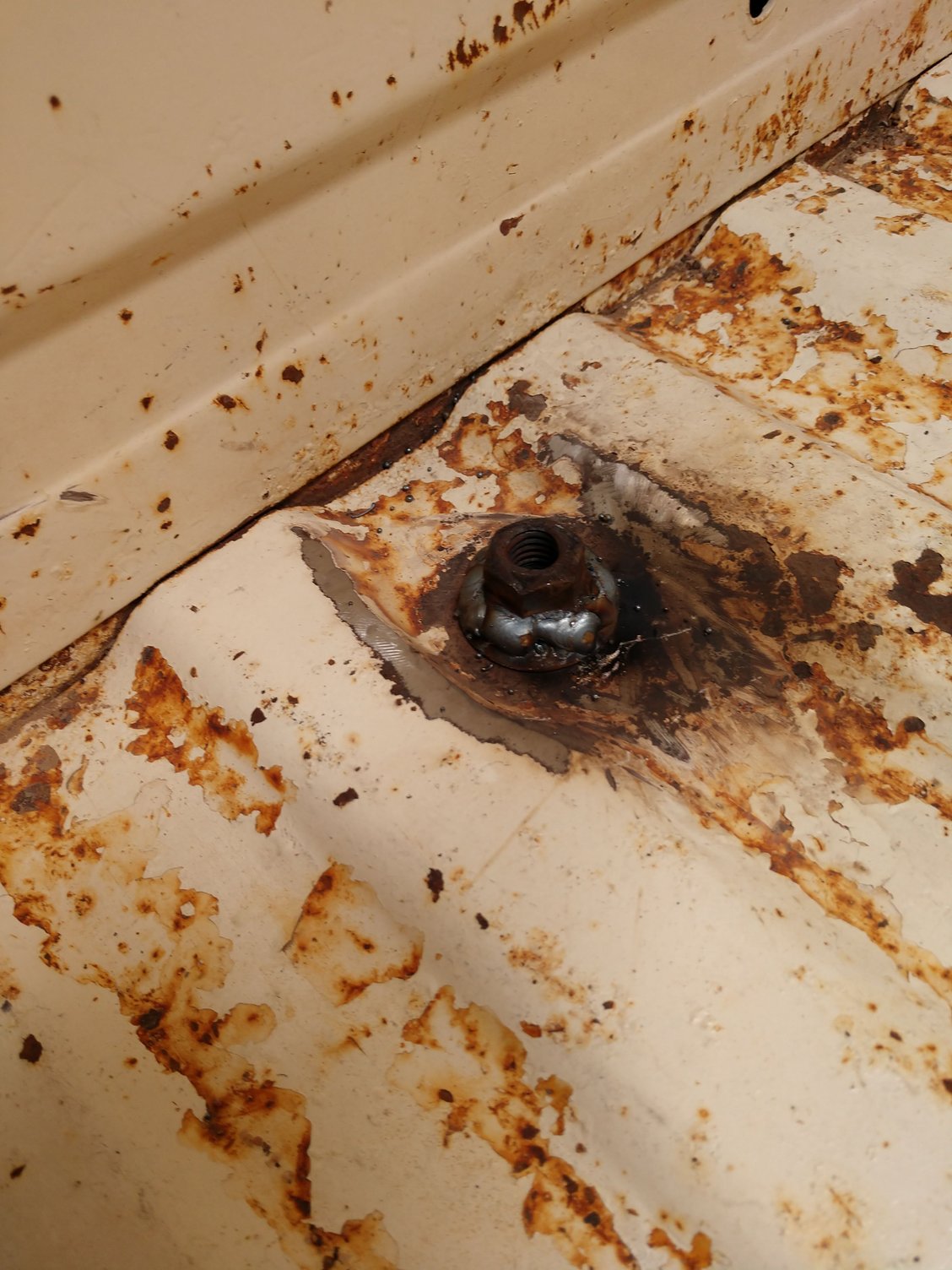

After the rear bumper I decided to remove the bed to start the LWB to SWB conversion. Only 8 bolts to remove and it's off. Easy, right? Nope... The auxiliary fuel tank was right in the way of the last carriage bolt. "Fuuuudgge!" Is one word to describe what I was thinking. So I got after it and disconnected the rear light harness and then removed all but the last carriage bolt to hold the bed on. Next was removing the fuel tank fill hose connections and the fuel line and sending unit connection. Got on to the skid plate and all those bolts came out pretty well. One bolt that had me stumped for about five min was the bolt that held the e-brake cable. Had to scrape a bit of crap off of it and it came out pretty easy. Then on to pulling out the tank. Unbolted the tank straps and a bit of pulling, tugging, and VIOLA! Tank was out. That was pretty simple... on to the final carriage bolt.
22gallon aux. fuel tank removed. Time to get to that final carriage bolt. I'm hoping I can re-use this in my build. I think there's just enough room for it so I don't have to worry about a 70's mustang tank.
Ah, the final carriage bolt. This should be easy. Just like the rest of them. Grab my cheater bar and 3/4" socket and pull. "POP", unscrewing easy. I grab the ratcheting box-end wrench and notice the darn bolt is spinning. UGH... Out comes my welder. I'm not messing around with this. I welded a nut to the bolt. Just a few tack welds should do it. "POP" Nope, tack welds snapped. Okay, let's weld the darn thing on there good. So, I did. As shown below. Bolt will have this nut on there forever. To my surprise, this wasn't a carriage bolt. No wonder why it just spun. Well, it's out. Time to get the bed off the frame.
Final carriage bolt. Or so I thought it was... nope, just a standard bolt that spun as I tried to remove the darn thing. So out came my welder and I welded a nut to it. That worked great!

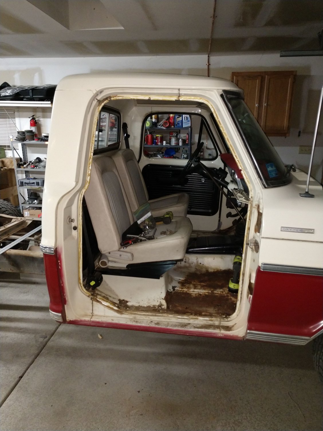

I got all of the trim removed and got the door off. It came off easily with only one screw rounding off so that had to be drilled out.
Tool box removed. Wow is that side flimsy now.
tool box door removed. Gotta figure out where to cut this thing down to keep it's functionality when shortening the bed.

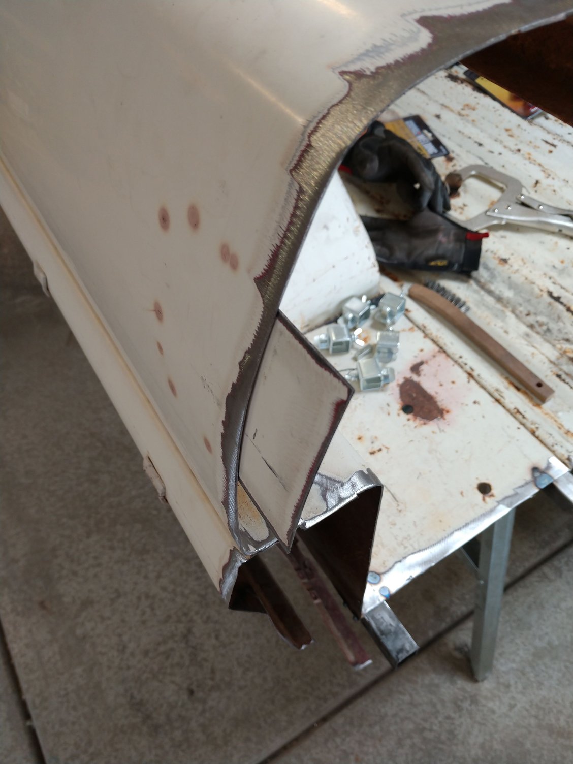

In order to lift the front of the bed back up and to make the edges, I ended up cutting out some square pieced of the 16" section of the bed and tacked them on to the side of the bed.
Pieces cut from the side of the bed for alignment of the front of the bed to the back portion. I this this on both side of the sectioned part.
Sides tacked in for alignment of the front of the bed.
Sides tacked in. These are just for alignment of the bed and will be removed later.

Interior fitment of the bed. Not too bad. I did have to cut a few areas again in order to keep a 1/16" gap all the way. nothing a grinder with a cutoff wheel can't handle.
So now, it's tacked into final position. A few of the clips are still in position, but I should be able to get those out soon. I'll be working on getting this part finished by this next weekend.
In it's final configuration. Still needs to be fully welded up, but that should be able to be completed by next weekend.

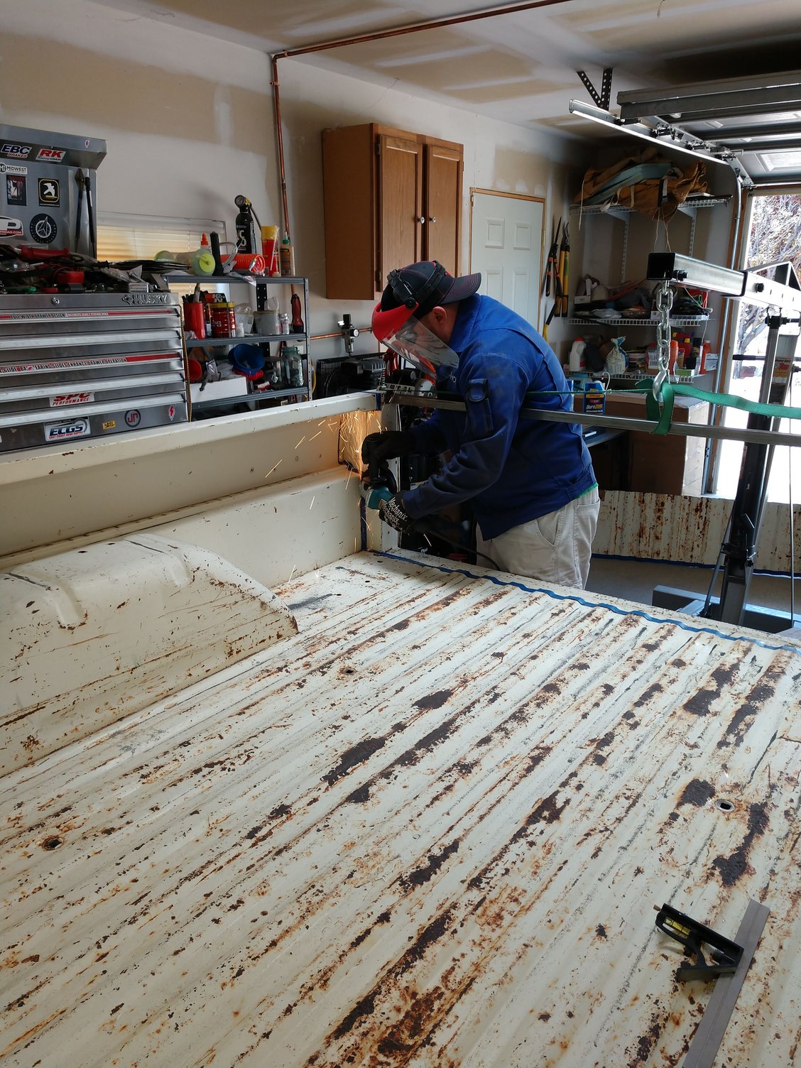

Today, I had a friend come over to shorten the rear of the bed. It took about 5 hours with a break for lunch in between. I started off by taping about one inch from the seam. I also added a brace since I took the tailgate out. I'm getting a new tailgate as this one has several dents/dings in it and I can't really say I want to do the body work on it..
All taped up and brace tacked into place ready to be cut off. Cuts to be made on left side of tape.
Taped up ready for cutting. In this image I'll be cutting on the right side of the tape. It's about 1" from the seam where the ends are welded on. This allowed me to be far enough away from the brace underneath the bed.

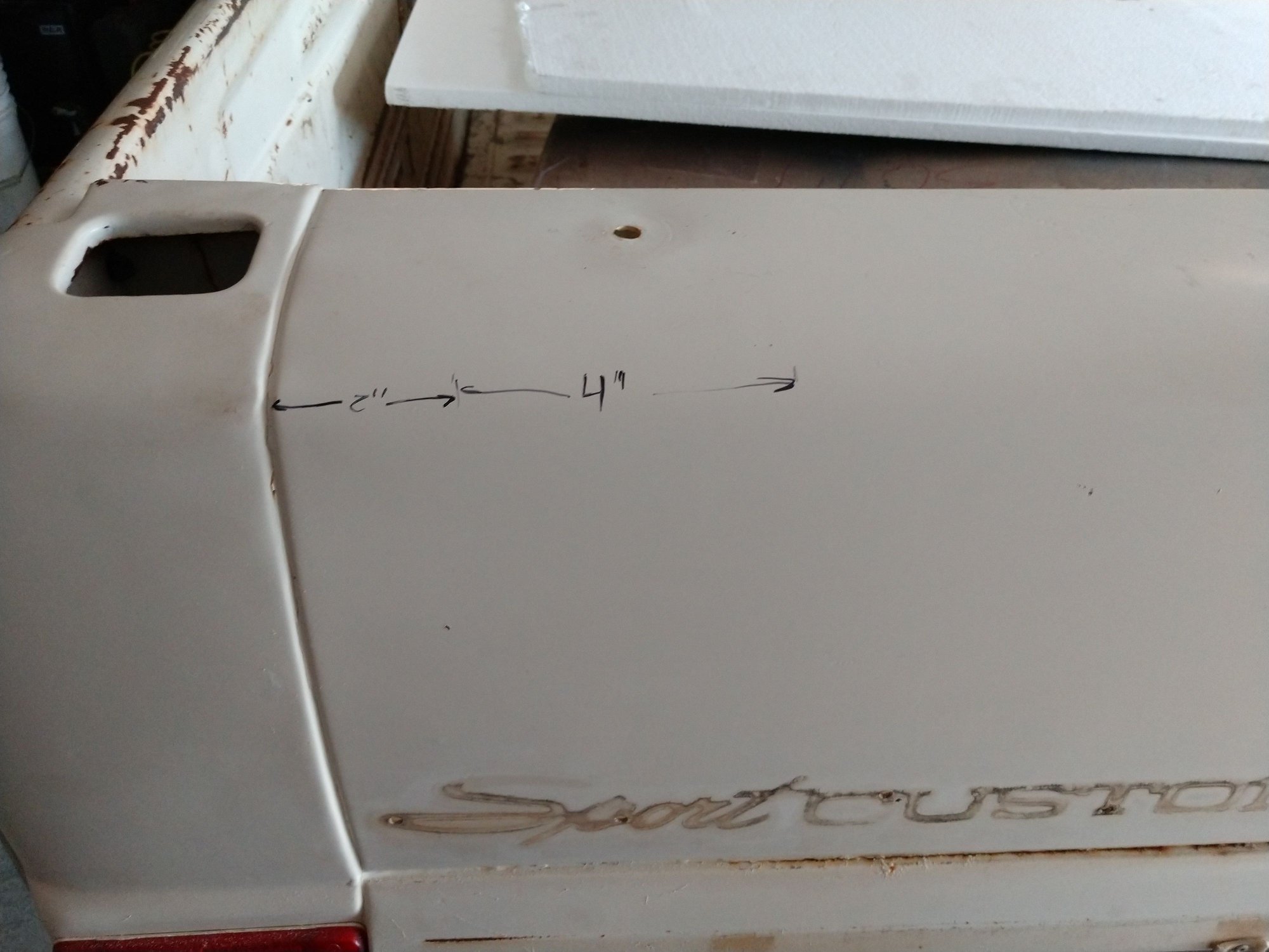

As shown above I have it marked out for 2" from the seam. I decided on 1" as the seam made a great line to mark from. This also allowed me to make sure I wasn't going to cut off the brace underneath the bed.

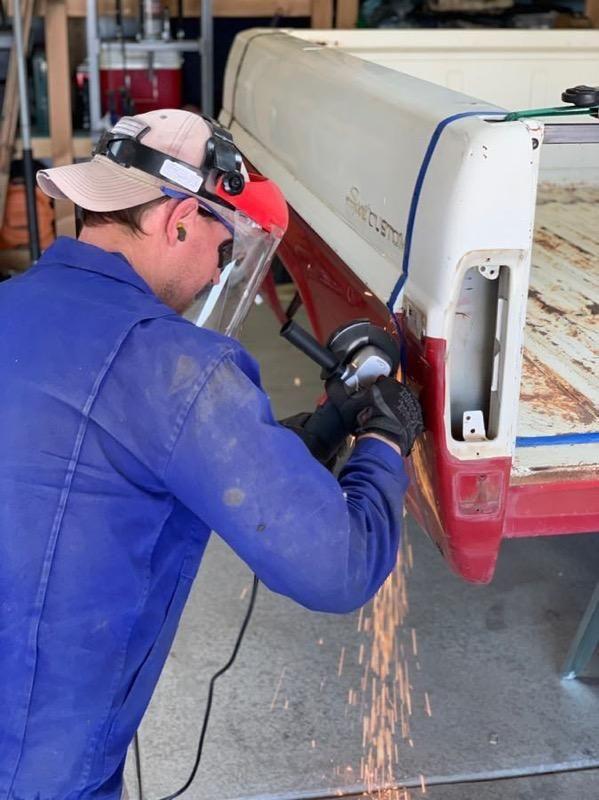

I started cutting using a 4 1/2" grinder with a cut off wheel. The corners were still a PITA, but a lot easier the 3rd and 4th time doing it. We ended up taking the guard off the grinder and using a fresh cut-off blade to really get in there. Then I went in from underneath and finished the cuts on the seams.
Here's my friend cutting away at the bed.
Here I am doing work. With all the PPE on I was sweatin like two rats in a wool sock... But I'd rather sweat than loose skin or other things.
And Viola!!! end is cut off.
Rear part of the bed is off. WHOOOO!!!
After cutting the end off we got to measuring and taping again. We then cut 4" out from the end of the bed. The temperature was about 90 F outside and cutting with a shop jacket, hat, gloves, safety glasses, face shield, and ear plugs got rather hot. At least we both walked away with all of our skin!
4" cut from the rear of the bed.

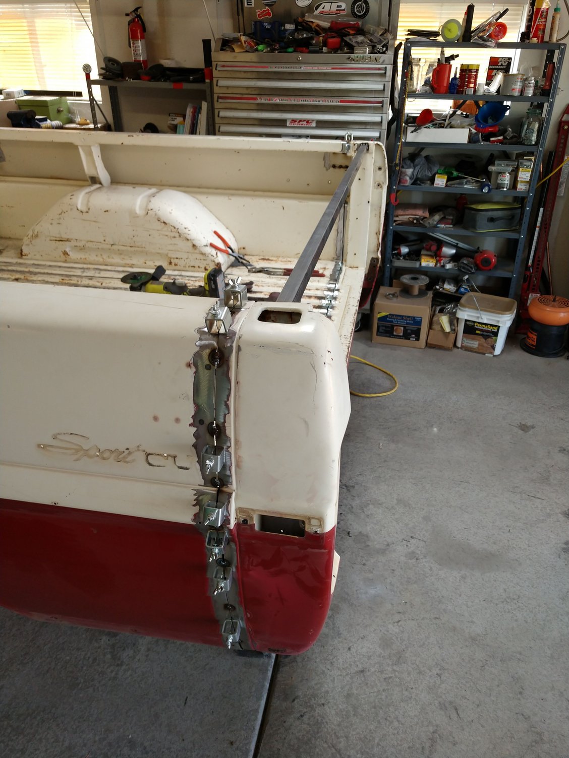

In order to place the end of the bed back on, I did the same thing as an earlier post where I tacked some supports along the bottom of the bed and used parts of the side walls as guides. I didn't take pictures of those as it can easily be see above. We ended up getting it all aligned pretty well and then I tack welded it up. Here she sits... An almost finished short bed!
Here she is, sittin pretty!
Side tacked on.
One of the sides tacked into place. These but weld holder clip things are amazing!

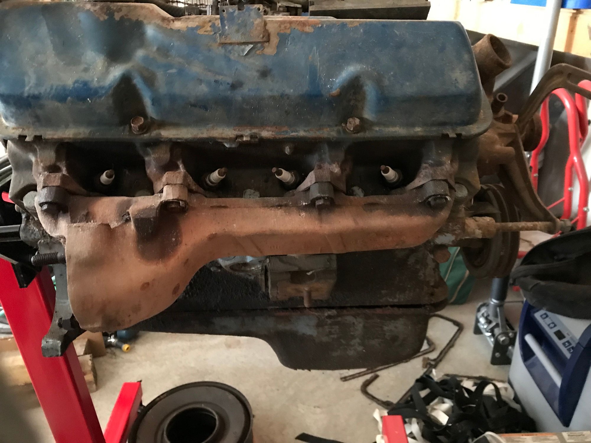

I did some more work this last weekend. My nephew is in town so I decided to switch gears and get him acquainted with engines. We started with this engine... I was told it was a FE 352. The block shows that it's a mirror 105 block so we'll see what we find when we start to dig into it.
Top of the engine that we started with. It was sitting in a guys yard for several years. Guy only lived 10 miles away from me so I got it for a great deal... I hope.
Side view of engine.
Prior to my nephew getting here I sprayed the exhaust bolts down with PB Blaster... Thank goodness too. Only one bolt broke off! YAY!!!
Once we opened up the valve covers we got to see a bit more into the engine and how it's life was. One rocker was off to the side. The spring holding it in place was broke. Probably due to it rusting through with the moisture in the heads. Loads of sludge, but mainly on the back side of the engine.
getting all the ancillary stuff off. Carb, carb linkages, valve covers, and Water pump all removed.
Driver side head. Doesn't look too bad with the exception of the rust. This was probably due to the moisture in the head when the engine sat for so long.
Passenger side of the engine. Notice the intake valve rocker for Piston #2. It's a little off its rocker... Pun intended!!! Doesn't appear to be any damage to the valve so it seems fairly new. Most likely due to the spring rusting through and failing.

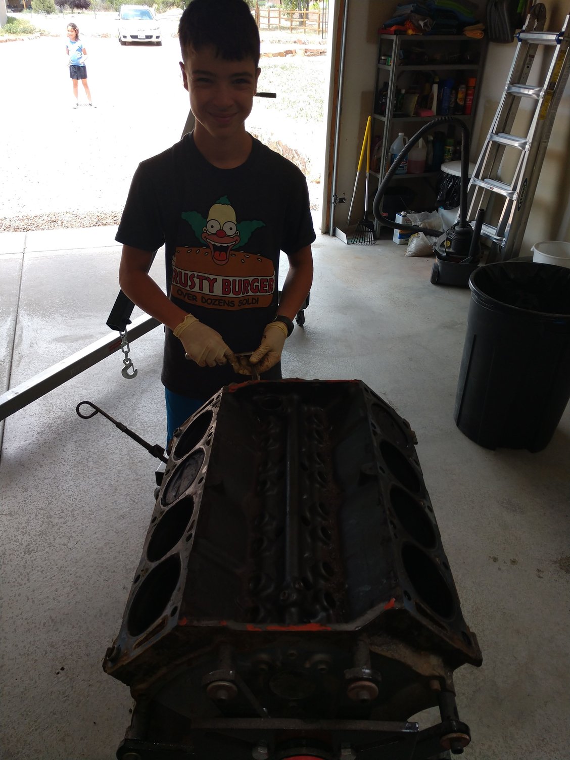

My nephew helping out.

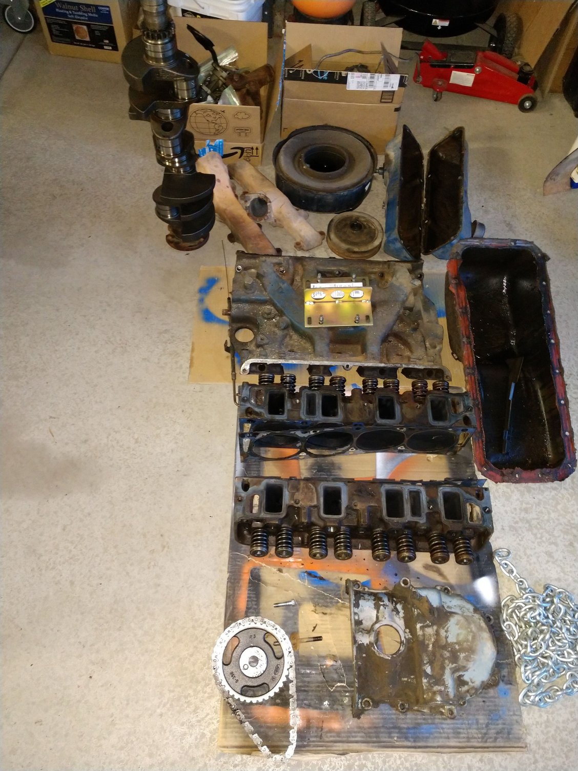

After getting all the ancillary stuff off it was time to start tearing into the long block.

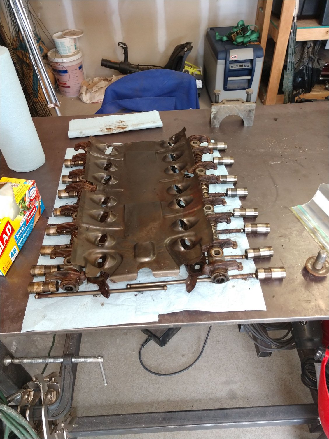

rockers, lifters, and pushrods all lined up as they came out of the engine. Only parts I may be re-using is the oil galley pan thing... Heck, I forget the name of it, but I'm keeping it for the build.
Manifold and heads removed. I used an engine lift for removing these things. I didn't want to chance dropping them on anyone's foot. You can see the boxes at the top. All the bolts went into labeled bags so I can re-use if need be.
Manifold and heads removed. Ready for the shortblock!
We flipped the engine over and started getting the timing cover off. Well, I need a new gasket for the timing chain cover. When we were trying to get the Timing chain cover off, the spacer that the harmonic balancer was touching didn't want to budge. I removed the key and still, nothing. I"ll need to purchase a gear puller to at least break it free.
Short block most of the way taken apart. It doesn't look too bad. Some of the mains were worn down to the copper and some show some marring. Probably due to me rotating it without oil.
And it's apart! I made sure to keep the pistons together in the way they came out.
Everything's out now. Now to get a gear puller for the crank shaft spacer for the balancer (I think that's what it's called).
So most of what you see in these pictures will be sold, given away, or used a boat anchors (manifold...) After getting the block wiped down we started taking some measurements of the bore. As I previously mentioned I was told this was a FE 352 engine; however, after measuring the bore with a bore measuring tool I'm getting 4.078ish... Which means this is .030 over for a 360/390. HMMMM... maybe I only need to get it re-honed!!! Sweet! I'm gonna keep my fingers crossed. Otherwise I may need to go .060 over and get a custom stroker kit from Scat. We'll find out. First things first is to get this block cleaned, magnafluxed, and to see if I can get away with just a hone with the torque plate.

I did manage to get some work done on the bed this week. I ended up cutting and started welding the toolbox together. The first thing I did was determine where the best place for the first cut would be.
Taping off for the first cut on the bedside toolbox.
I noticed that I'd need to either cut the crap out of one of the supports so I decided to see how to remove two of them. I ended up drilling out the three tacks on it and prying up on it easily so as to not bend it much. It popped right off without any fuss.
Removal of two of the rear supports. Just drill out the tack welds on it and pry up easily. Don't pull too hard or you'll bend it.
You can see the toolbox is angled a bit. I made sure to start the cut where it was flat and would mate up to the other side easily without much fabrication. After making the first cut I went and measured 16" for the second cut and marked it out.
Measuring out 16" for the cut line.
Taping up for an easier sight line for cutting with an angle grinder.
After marking up the cut line, I started cutting and viola... two parts to weld together.
All cut up and ready to get welded together.
I ended up using about six buttweld clamps to hold it together to tack it all together prior to welding. It worked a treat. Here is how I left it as of now. I'm hoping to get the rest of the welding of it done this week along with the door cut and welded. We'll see how that goes...
in process of getting welded together. This is where I left it. I hope to get the rest of it welded this week.

Got some more work done on this thing. I was able to finish welding up the toolbox. After re-connecting the leads on my welder, it made the welds so much better. I then started on the toolbox door. I started out by drawing a line along one side of the door and then using painters tape as a cutting guide. This cut line started just on the outside edge of one of the end hinges (there's three). Prior to cutting the door, I drilled out the tack welds on each side of the hinges so I'd be able to pull them off without damaging them. I want to re-use them after welding the door back up.

After pulling the front grill and valence off I started on the passenger side of the cab. I pulled the door apart and then took the door off. In order to pull the door apart, windows and all, I followed the following thread: https://www.ford-trucks.com/articles...-window-68-72/ It helped quite a bit on how to pull things apart. I still have one of the tracks to pull out, but that shouldn't be too difficult if it comes out like the window felt does.
One thing to make sure you do is put all the nuts, bolts, and screws into a bag. This way you know where to look when you need to put everything back together later.
Door completely disassembled. It should clean up nicely. Man there's a lot of dirt at the bottom of the door.
Door parts.
Door is off the truck.
Yup, the floor will need to be replaced. I have the part in my storage area waiting to go in, but first I need to pull that outer fender off. about 9 bolts total and viola! It's off. It'll clean up nicely once I get to body work. That'll be later though.
