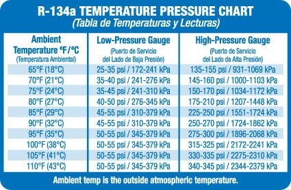

thanks for all the advice so far gents, especially for the chart. Is there truth to the fact that the system had dye in it from the factory? Obviously I have a leak somewhere because I’m low, but it must be slow and I sure can’t find it so far.
I’m gonna see how long it holds this 20psi before I decide about vacuuming or just charging it up. Tempted to vac it and change the accumulator and orifice tube as stated above but this refrigerant is crazy expensive and it’s a rough couple months for me wallet-wise.
