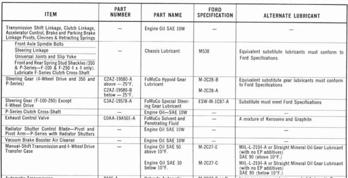

As the title states, I'm curious as to what you guys run in your 3 speed trannys. The ford manual calls for SAE 50, but also lists SAE 90 as an alternative. While searching the forums and google, I see various opinions on what to use, but the common factor I see is to not use synthetic oil. What do you run in your 3 spd?

Perfect, thanks everyone. I went with the Valvoline 50w. Oddly enough, the owner's manual I have for the truck calls for 3.5 qts in the transmission, however I was only able to put about 1.75 qts back in. This is also about the amount that came out when I drained it as well. Is the 1.75 qts approximately the correct amount? I dont see any other fill plugs that would allow me to put more in, so I assume the 3.5 qts is a typo in the manual (or possibly referring to a different trans all-together).
