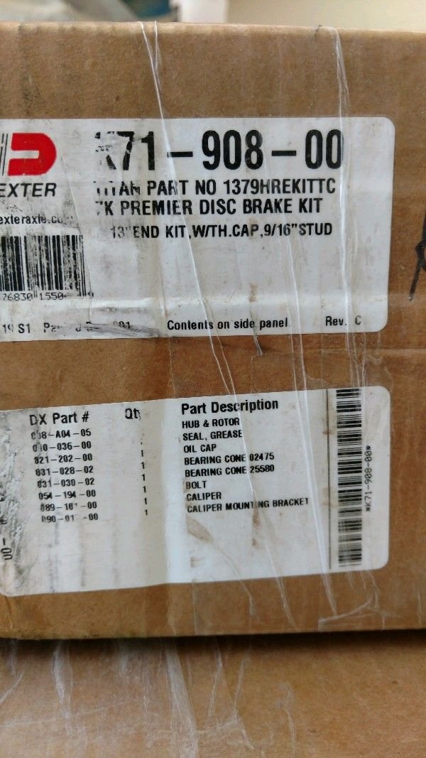

My disc brakes came in Tuesday and I'm waiting on the 8k axles to be delivered so I can start the conversion. I bought mine from Performance Trailer Braking. Most people don't realize that the 7k/8k disc kits have the same size bearings and the only difference in the kits is the caliper brackets. The brackets for the 7k kit have 5 holes in them and the 8k brackets have 4 with larger diameter holes. Now, IF you wanted to order just the discs now and then decide to upgrade the axles later, all you would need to do is to order the 8k brackets which are around $40 each. So around $200 with shipping you can then upgrade the axles at a later time. This is what I had planned on doing but since I have a Dexter plant about 30 miles or so from me, the shipping was cheaper than I anticipated and the deal for all of it was better than I had anticipated. So, for around $3300 I got the axles and discs. really anxious to get started but I have to have the axles and better weather first. The 8k axles have one more spring in the pack and each spring is thicker than the 7k pack leafs.
