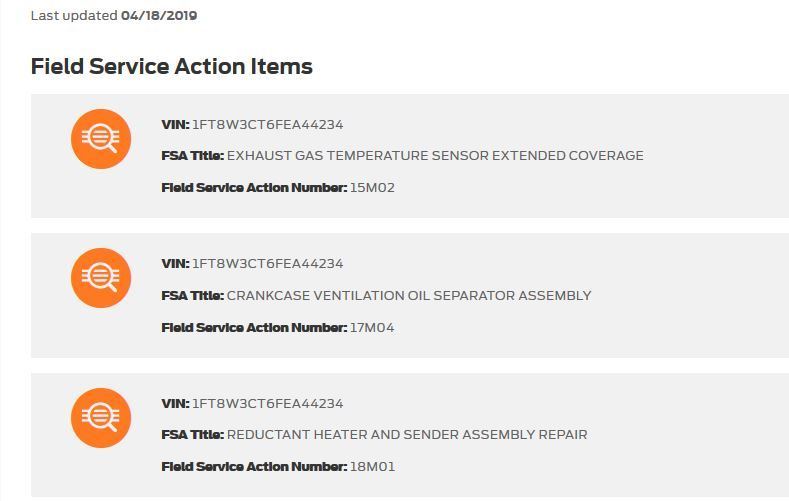

Ford extended the warranty on the DEF heater/sender assembly with CSP 18M01 but it does not cover the 2015 pickup model. However, since this is a $900 dealer repair and there is a labor code (18M01G) for the 2015 pickup in this CSP, it's still worth asking about your VIN. See attached.
I believe the letter has a typo on the years for the 2015 F350 trucks. I received the 18M01 letter and Ford Owner and Ford Pass shows my 2015 truck covered by the 18M01
