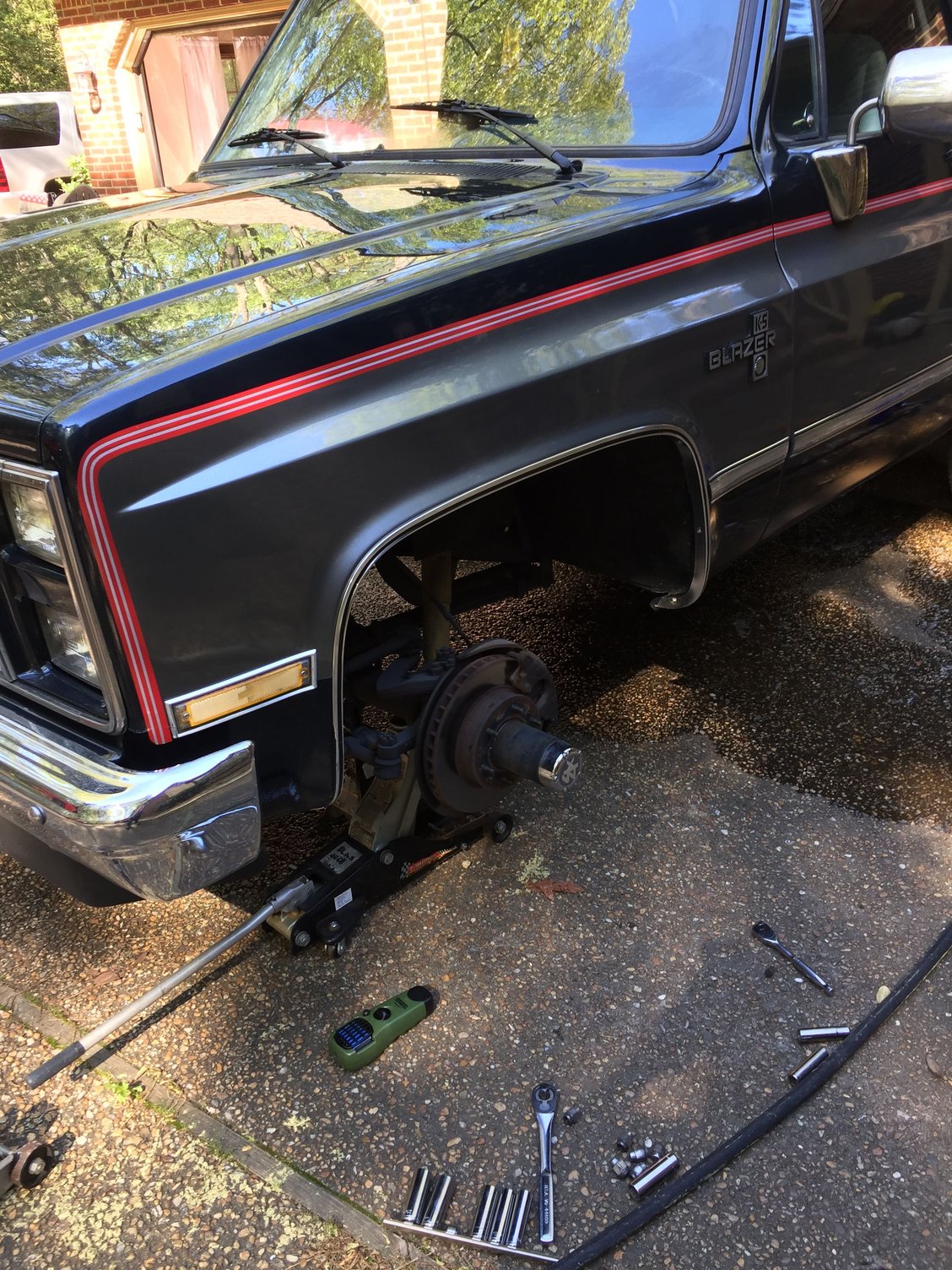

My dad was a big off-roader he drove his rigs on the beach in NC every weekend (when you could go from VB to Corolla via Sandbridge). He ran “huge ballon” tires... 31s and 33s back in the 60s and 70s. I observed him do the chalk test....worked back then. I also remember him getting stopped because of his “big” tires....crazy how small they are now.
I spoke with a good friend of mine this week who runs a couple of tire stores he stated that your more likely to wear out the centers fully inflated and not towing. He suggests 45 or 40psi. Sees it all the time on 3/4 and 1 tons. FYI he’s also a big off-roader so he wouldn’t steer me wrong.
I wish my dad hadn’t turned me into a motorhead I’d have way more money this is what I’m doing today. Re-painting rally wheels for new tires.
