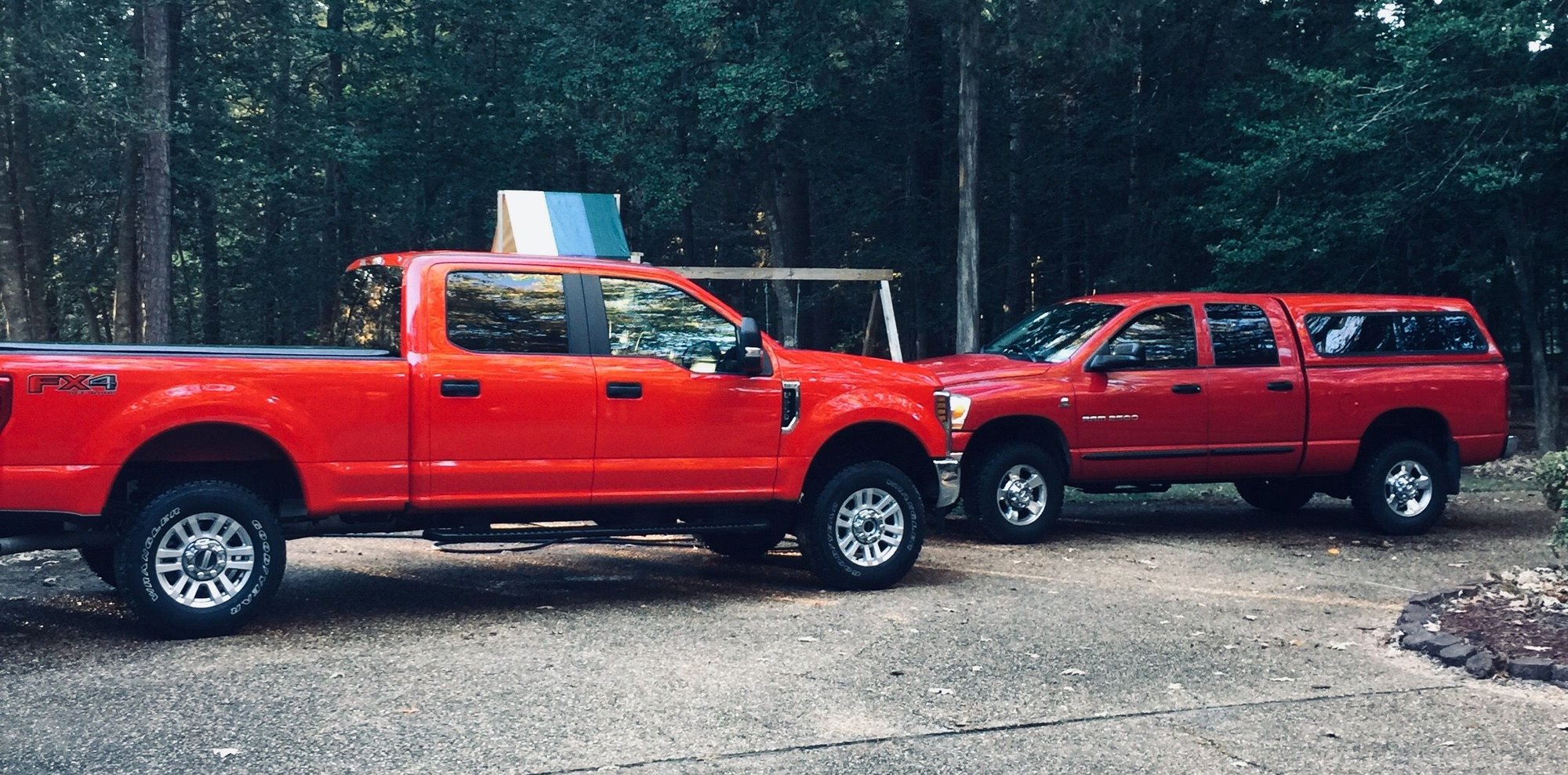

So I don’t use forums much.... I have a 2018 F250 4x4 STX FX4 crew gas. Best driving truck I’ve ever had, however it rides terrible. Great in the straights but bone crusher on the potholes. I bought it new and yes it has the snow plow prep.
Just a background I also have a 2006 Dodge 2500 with snow plow prep (also bought it new). It rides bad but not as bad as the ford (fords a better truck but I can’t sell the Cummins). I also have owned countless solid axel trucks, Jeep’s etc and currently have a 87 K5, so I’m no stranger to bad riding trucks. Also for background I use it as a trip vehicle and occasionally DD, but I also drive some pretty rocky roads when I’m at my cabin in WV, it 4wd access only and one of the roads reads 19 degrees on the incline-o-meter. So I do I good bit in 4x4 and low range over rocks and run 75ish over the highway there and back to VA.
So here’s the questions:
Can I swap to 4800# springs and a leveling block and get the same ride height (I like the extra lift in front almost level)?
Or will lowering the tire pressure make a big change after fixing TPS settings? Might try it tomorrow.
Or does anyone know of an aftermarket spring for gas that would put me at or near my current ride height (I searched to no avail)?
Thanks for any help.

Yeah I don’t plow heck I don’t even tow more than a few atvs or a side x side with it. I just wanted another HD truck for 4wheeling as I hate a-arm suspension. I bought this thing because it was perfect in every way (for me) minus the plow springs...no carpet, 373, rear locker, FX4, manual seats, gas and RED....I should have been a firemen I love red.
