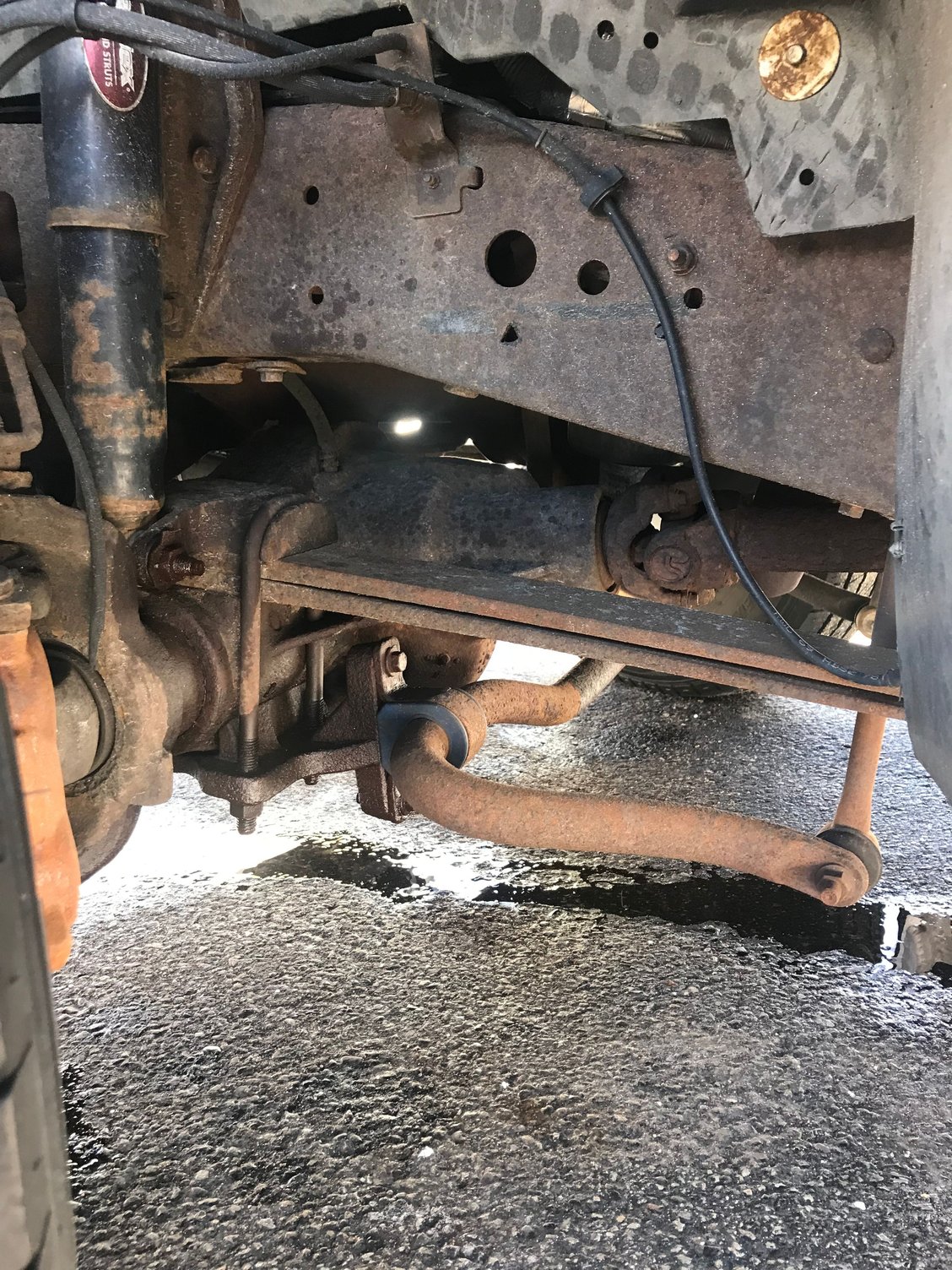

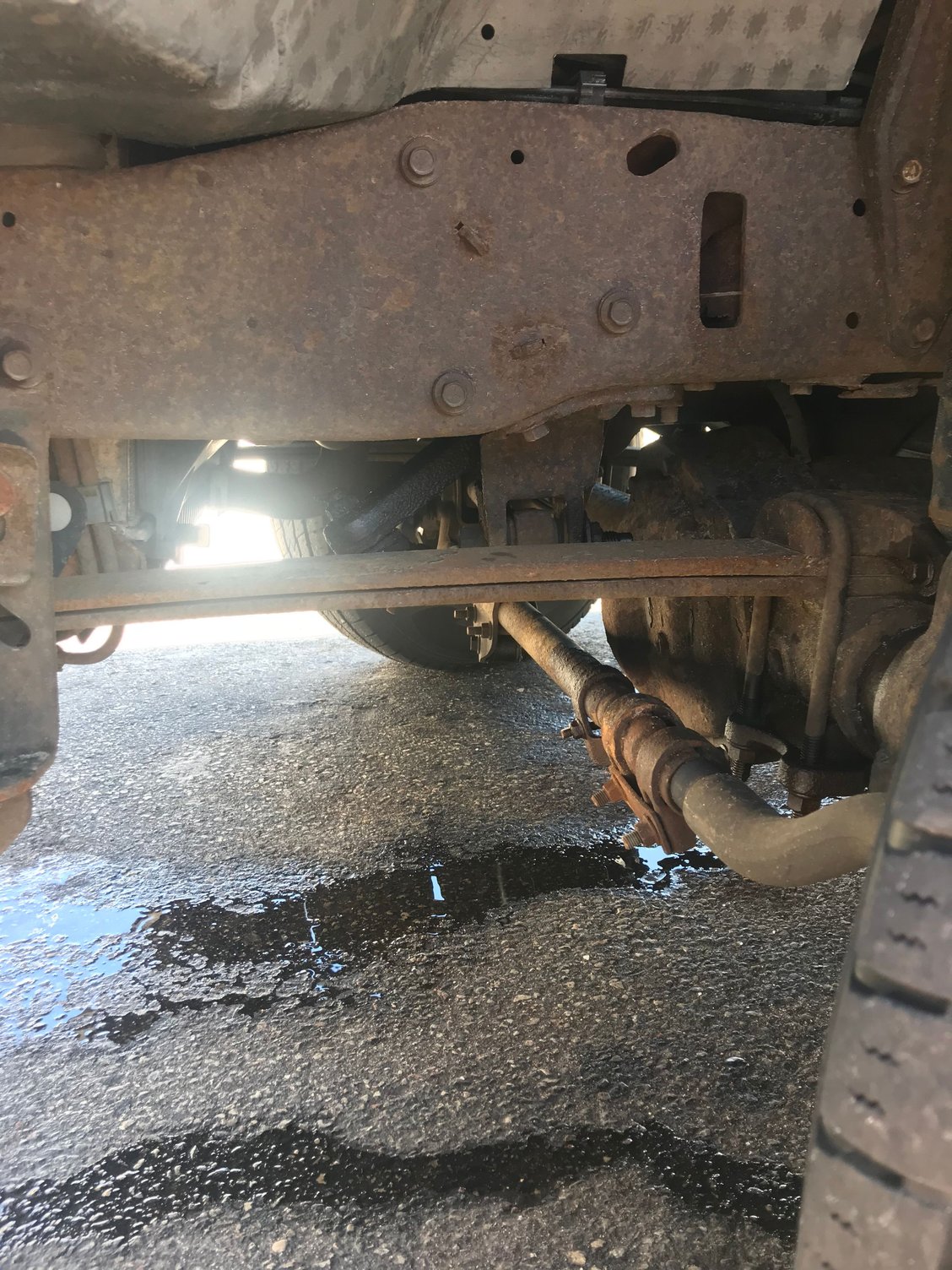

I think my 2000 X front springs are gone. They are flat and the bumpers are gone. There is a 3” front to back difference from the ground to middle wheel well. 36”/39” I ordered some SumoSprings to replace the front bumpers. I would appreciate all recommendations for spring and shackle replacement. I am not looking to modify the back. I don’t tow anything but a small snow mobile trailer. I am leaning towards a V spring. Will this raise the X so it will be more even or will I need some kind of adjustable shackle? I welcome all thoughts.

standard measurment is from the center of the hub , straight up to the bottom of the fender arch.
get those measurements since it is how we discuss and knoe them.
pics of the front and rear springs would also be helpful

Your front springs springs are sagged about 1” from when they were new, the rears are fine.
right at where your front ride height is at now we start to see so bad handling traits start to appear, namely Wander at highway speeds on flat and level ground and of course bottoming out which is evident by the missing bump stops.
you have a few decisions to make and options as to how you want to fix it.
1. Stock ride height stock suspension travel at 23”front and 24” rear.
2. Increased ride height and suspension travel to either 26-26 , 26-27 Or 27”-27”
If you follow my recipes it will ride, tow and handle better then stock
Either way you need new shocks,
Motorcraft stock replacement front springs run about $200 each
increased ride height springs x 4 $600 + adjustable track bar $200 + ubolt s and shims add another $150 or so.
i can link all the part numbers and vendors but it is all available online if you are interested
