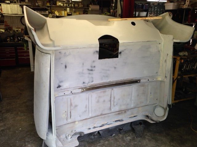

When I tipped my cab back to paint the floor and firewall, I put a piece of plywood on the frame and a piece of carpet on that to help distribute the load, rather that the weight just being on the frame rails like you are concerned about.

That's exactly what i had in mind. So no dents, no deformation of the cab`s structural ribbing?

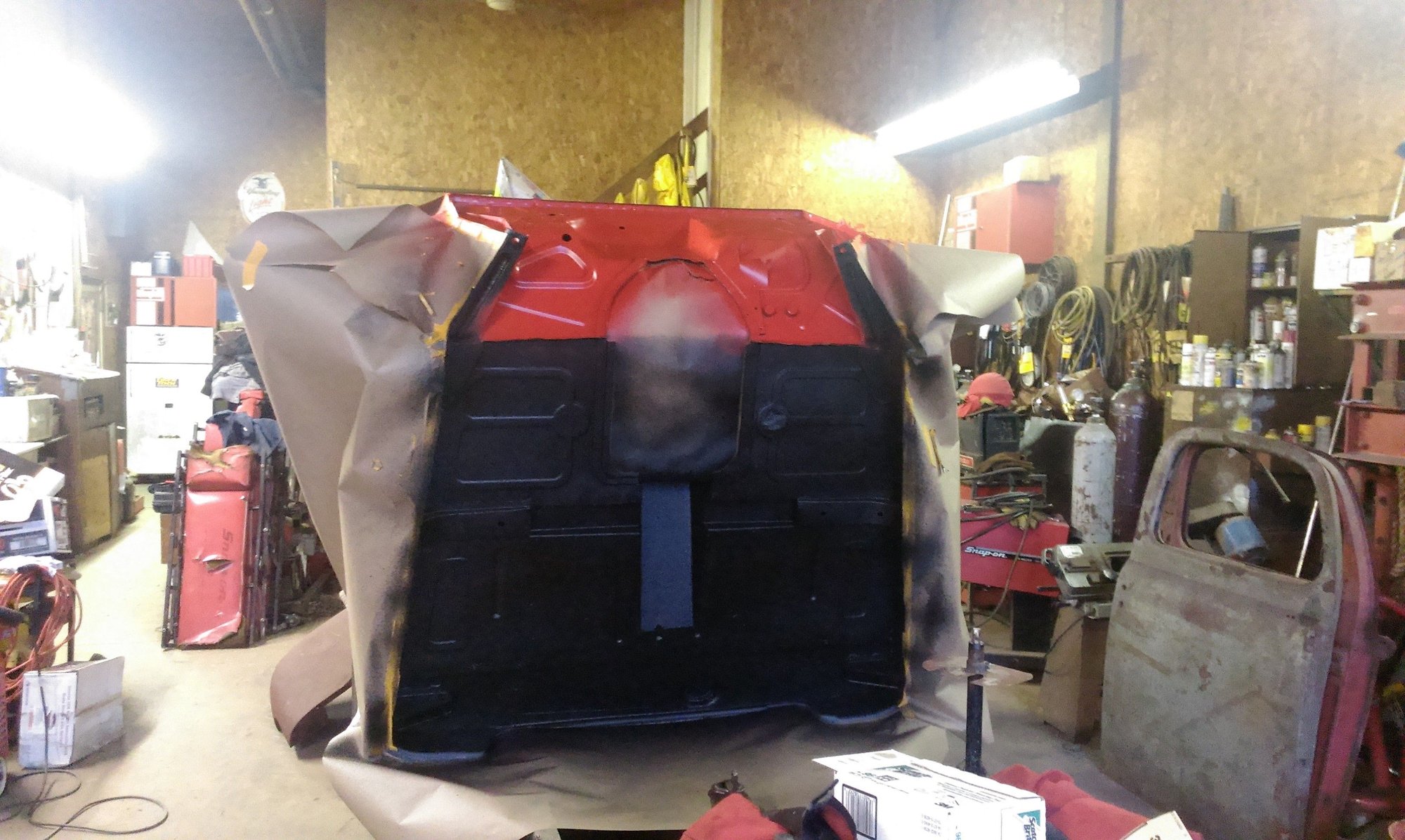

If you are going to be grinding and welding (think fire) with the cab tipped forward or back something a bit more fire retardant would be appropriate. I just painted the cab bottom with it rolled forward and soft padded.
