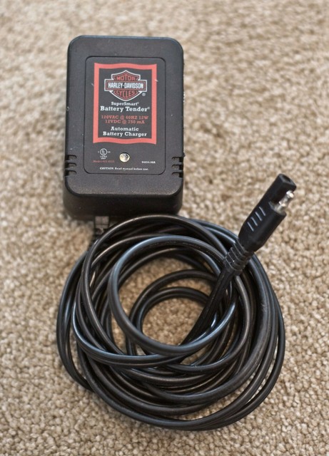

Relevant to the original post, Harleys used to come with part no. 021-0123 charger.
That was a rebadged Deltran Battery Tender 021-0123.
Harley now sells Part Number: 66000304.
It's a rebadged NOCO Genius 1 with an SAE connection.
