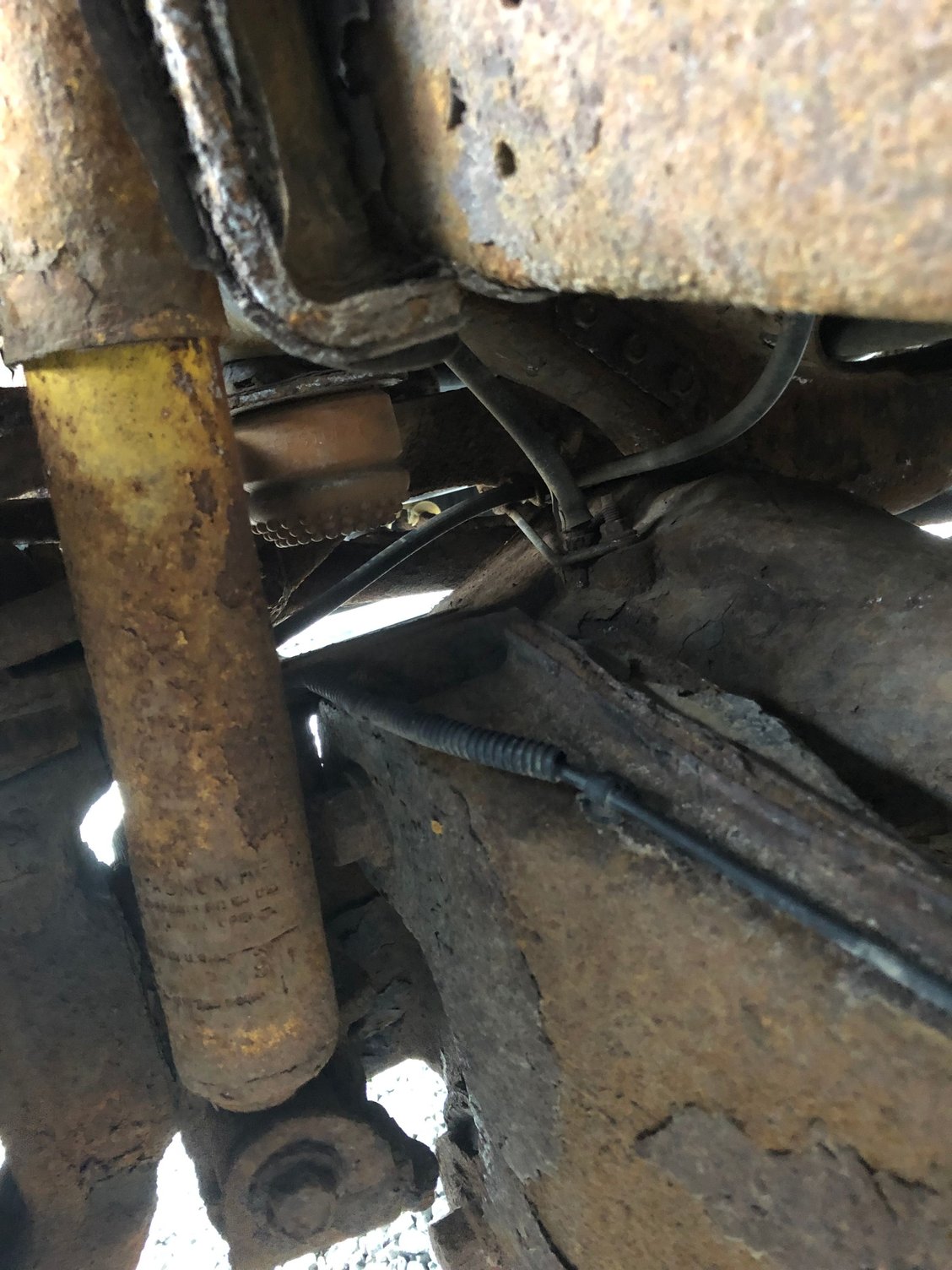

Do the coil spring trucks (2005-2007) have front bump stops? I’m having trouble finding them if they do. I’m thinking about adding a dual steering stabilizer and Superlift says I may need to “slightly limit the compression travel with bump stops”. I assumed I’d need to get taller bump stops. Now I can’t find that the truck has ever them or that anybody makes an aftermarket version that’s taller. Any advice? Thanks.

They do.....drivers side of my stock 2006 F350....view from bith sides of driver side tire

That looks aftermarket to me. I think I saw one just like it on line. It also looks like it doesn’t have a natural place to bump into. I suspect it’s there because of a problem, rather than stock. I could be wrong...

You are wrong
I’m the original owner.....it’s stock as I said
it bumps into the axle if it comes up too much, hence “bump stop”

Well (hat in hand) I stand corrected! Here’s a picture of where mine used to be. That flat surface just below is it’s landing pad. It’s maybe 6x6” or so, plenty of space to do a good job. There’s another similar one (equally trashed) on the other side. So now that you’ve squared me away (and helped greatly, thanks) the question changes: why is there not a readily available replacement part for this? Nobody I’ve found thus far make any front bump stop for the coil springed trucks. The 99-04 (leaf spring) bump stops are made by several companies. Have I missed something?
