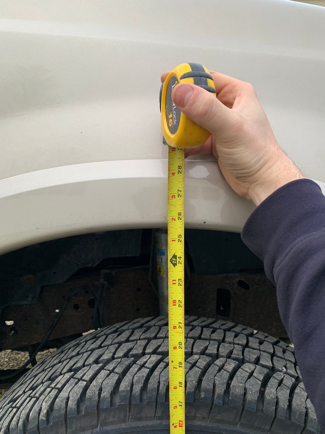

are those the stock front springs ?
did you happen to measure the distance from the center of your hub up the the bottom of the wheel arch before you lifted it ?
if so what was the measurement ?
if you didn’t can you go measure it as it is now and also measure the height of the blocks you installed ? ( we can subtract the block height from the current hub to fender height to determine how much you front springs have sagged) This is important because it adversely effects you alignment caster setting.
The spring doesn't look to be too sagged by way of distance between the bump stop and landing pad but I’ll guess it puts the before lift blocks measurement at 22 1/4” And then your caster at somewhere just south of 3.5* I’ll guess 3.1 on the driver side and 3.3* on the pass side.
I didn’t measure it but I can in the morning I’m at work now so I’ll post measurements in the morning. I was thinking caster too especially with the larger tires and added height.

25 3/8” ?
minus 2”
23 3/8 before the blocks, either those are not the stock front springs or your blocks are a bit more then 2” tall.

Anyhow, I suspect at some point in the past somebody changed your front springs and my previous caster guess is null.
If you can get your current alignment specs we can go from there.
if you want to know if those front springs are stock get a measurement from the frame to the bump landing pad ( the blue distance between the red lines ) And post up.

Still no luck on the alignment specs called the ford dealer and once again they said they’d email them still nothing. Starting to think they don’t even have them. I got some pics of rear suspension and measurements on front.
