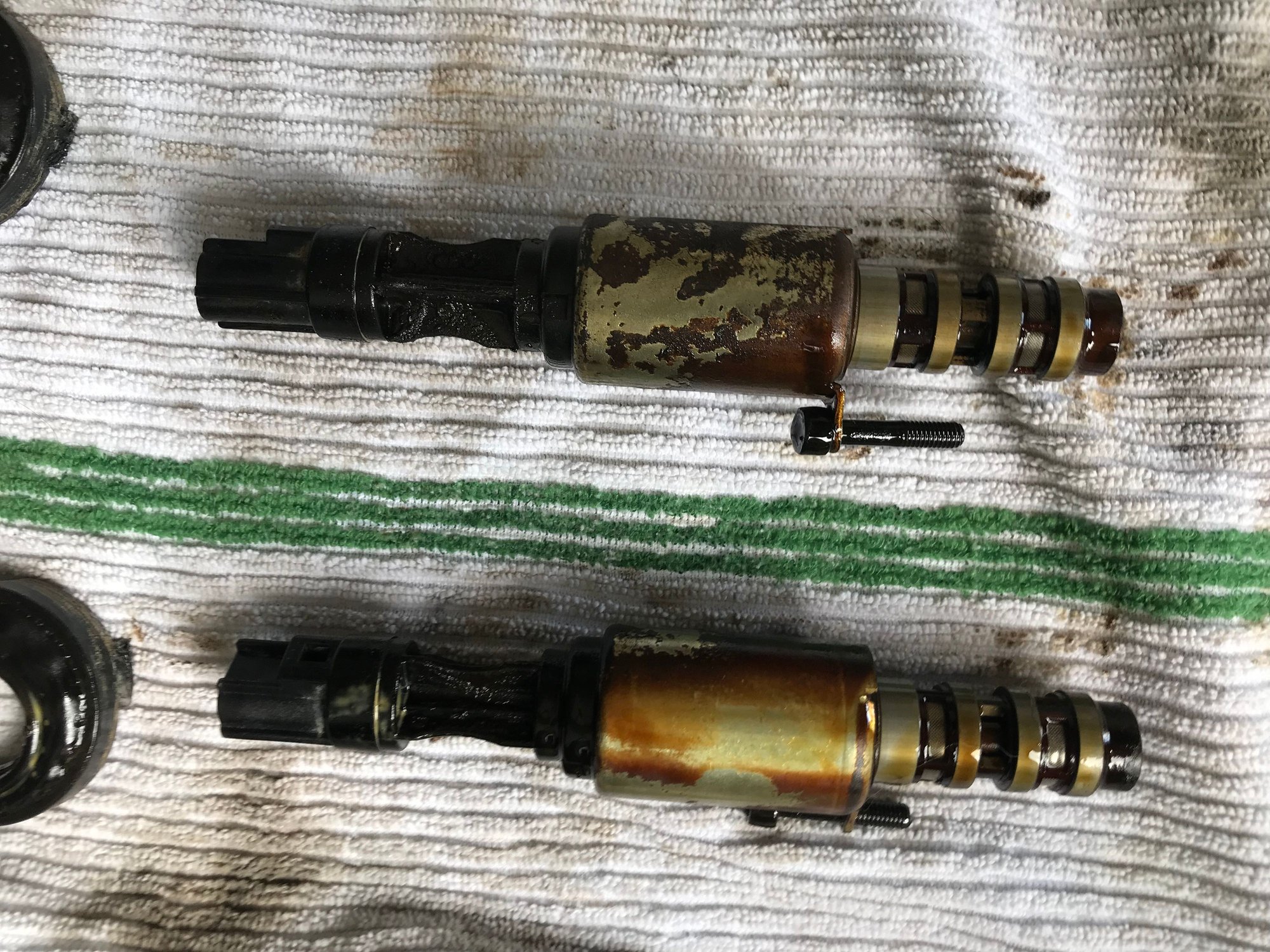

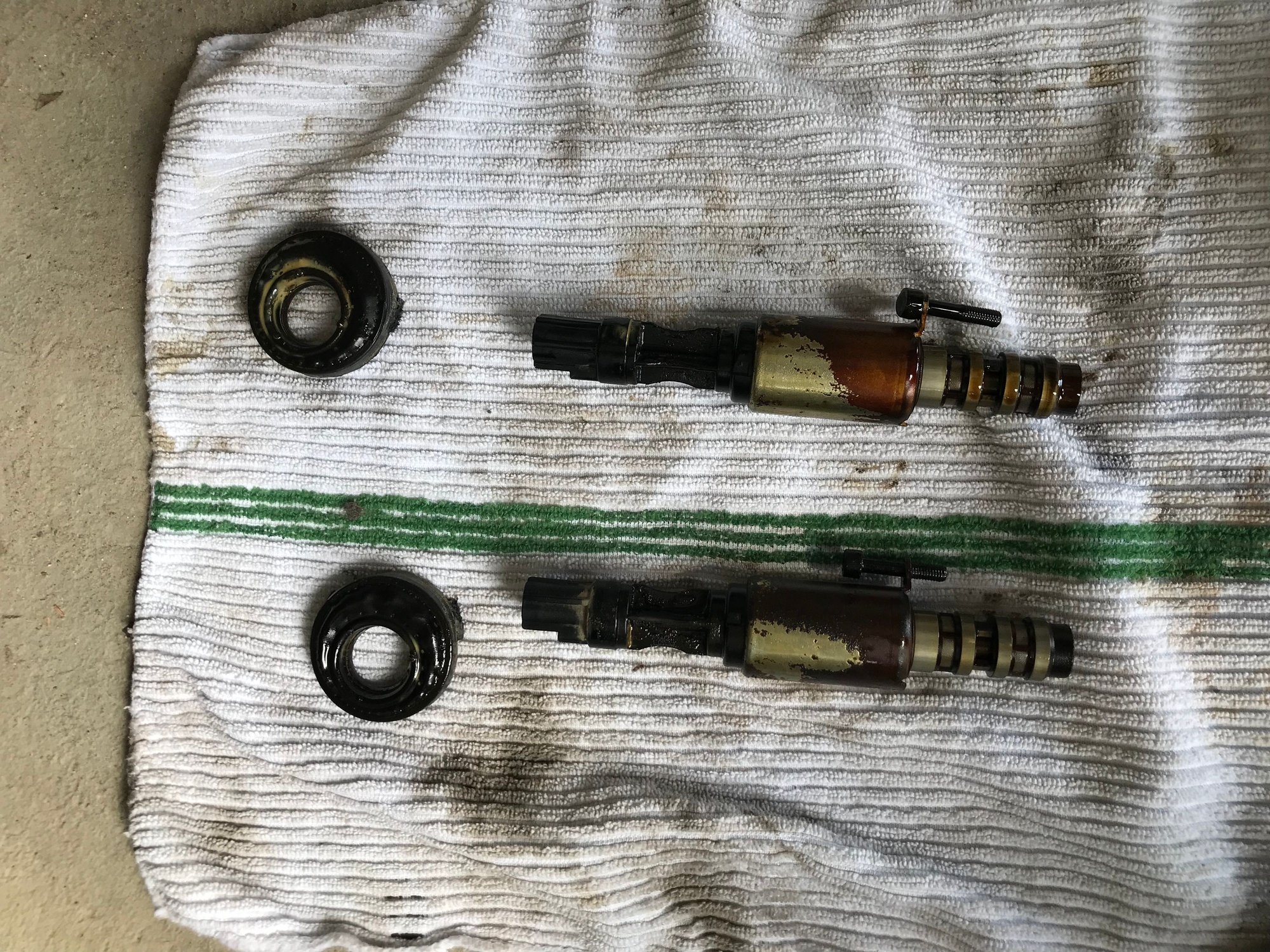

Update:
Was finally able to go and pick my truck up from the shop today. Mechanic said that the code was a “cam sensor”(didn’t write down which code it was which frustrated me). Told me the same ole 5.4 talk about the timing be bad but that they don’t do those jobs anymore as they don’t have the tools required. Only place in town that does them is the dealership which is not happening��. Two new solenoids and seals arrived today along with a single piece t27 screwdriver. Time to finish up some school work and get to the first part of a long and costly run of maintenance to get the truck back to good.
Old Apr 12, 2019 | 03:49 PM
Tate Langel's Avatar
Tate Langel
Joined: Apr 2019
Posts: 11
From: Dillon, Mt
Out with the old
