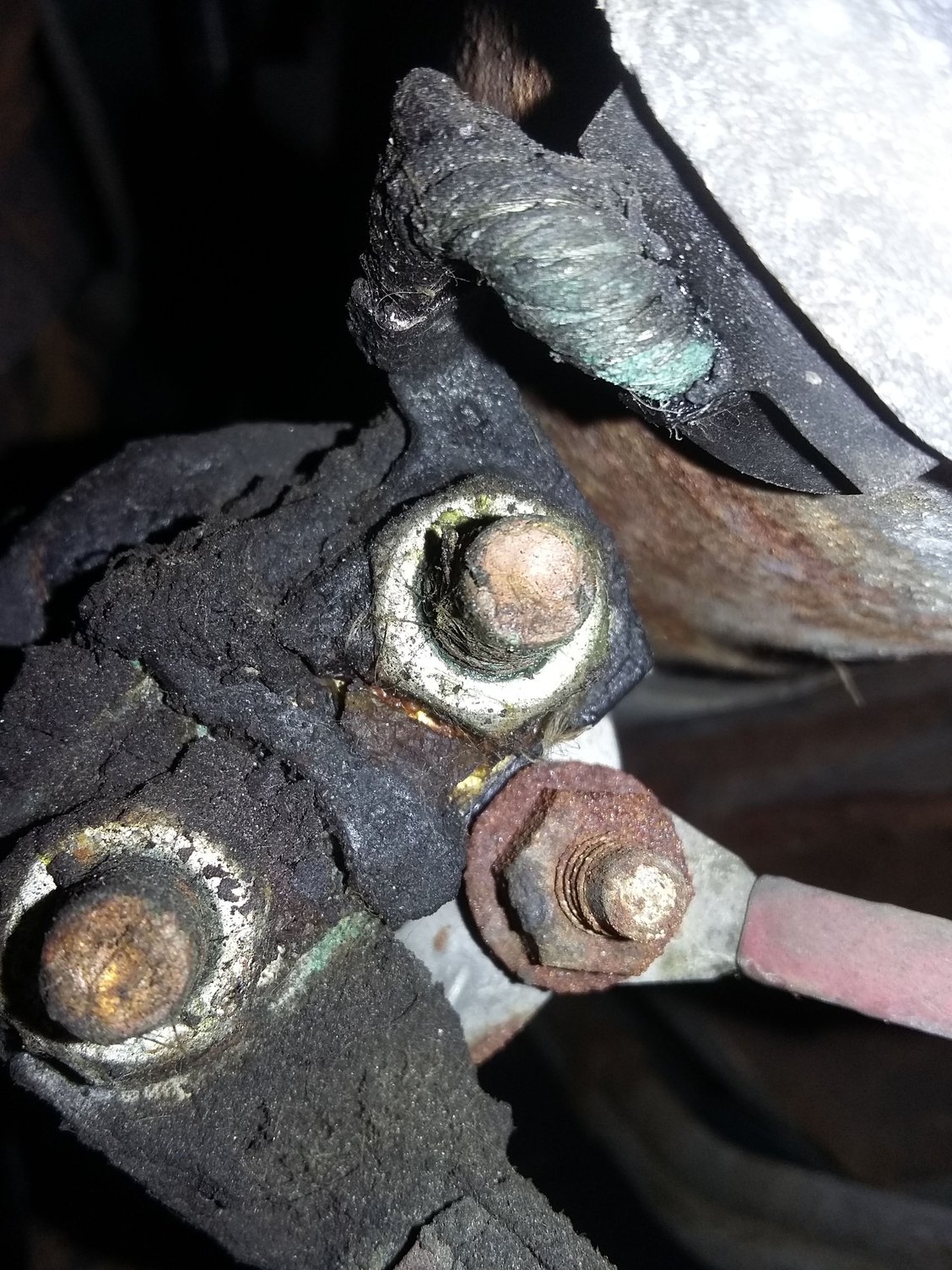

The starter, this looks bad, but would it be able to make power cut?
Bad photo of solenoid. That nut is rusty and a little green... the one under the rubber cap is still shiny.
Top of battery, both posts are on solid and I see nothing wrong...
Any help? I am 99% sure that the click it makes is coming from the starter solenoid. It's got 200k miles of Midwest roads, and the starter solenoid/starter are original. It has never done anything like this before, nor have I ever had a vehicle do this before, I am in the dark

Could be the battery cable itself as you say.
I had a 99 Expedition that had a random no start/no power issue. Dealer put a new battery cable in and problem disappeared

I think you answer is your positive terminal.
I'd loosen the POS battery terminal saddle and clean the lead connector, and metal/copper(?) saddle plates with a dremel brush ,or steel wool. It never hurts to do the same for all questionable connections. Then add an anti corrosion product to all connections.

Those clamp-style connections are well-known to corrode where they touch the bare wire, and worse, they allow moisture to travel up the wire and corrode internally. You can try taking the clamp off the positive wire and cleaning as mentioned, but if it were mine, I'd price the OEM positive and ground cables and replace them if affordable (!) *regardless* of whether that is the actual problem or not.

It can also be the battery itself. The same thing happened to me once where the terminal became loose inside the battery. Everything was tight but when I wiggled the post, weird stuff happened. New battery and no more issues. But yeah it could absolutely be the cables too.

With that many miles and corrosion it's probably time to go thru all the battery/starter cables.
Especially those open ended cables, they can corrode up inside the casing.
I like the marine battery posts which use cables with lug ends.
