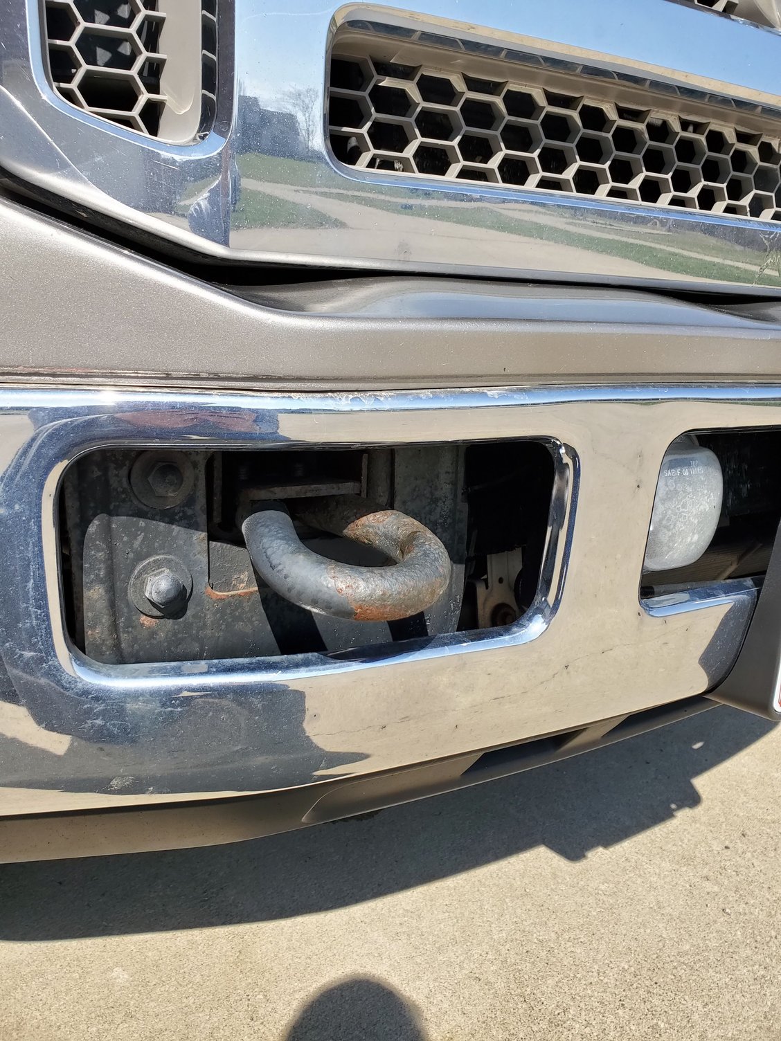

Went from cold weather mode to warm weather mode.
