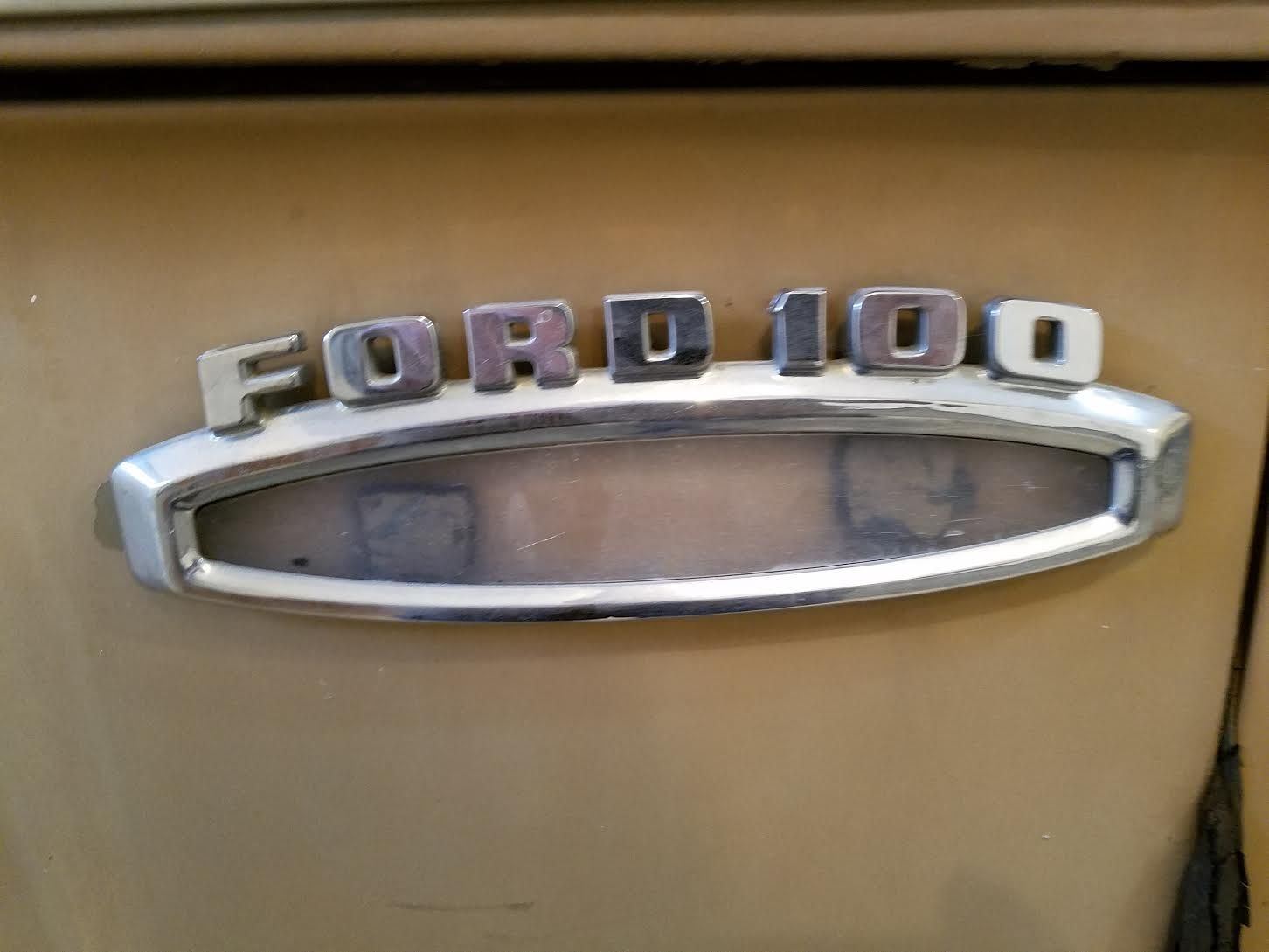

So I just popped off the Ford 100 emblem and look what was behind it. Kind of funny really.

Is that overspray or paint fade?

Your guess is as good as mine. But I'm thinking faded paint. It lived in southern california its life

If it matches the colour under the seat, on the firewall and gas tank then that is likely the original colour. Post close ups in the sunlight and maybe a member here can identify it
