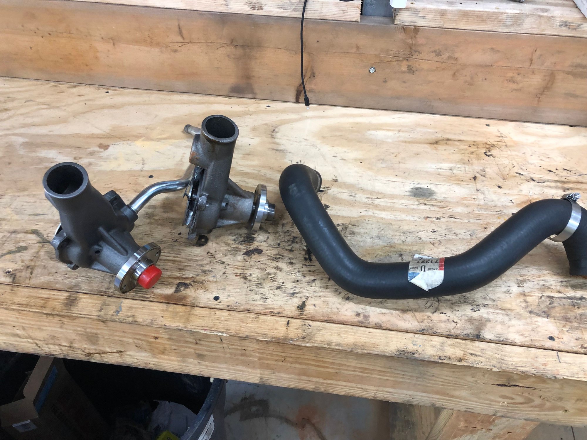

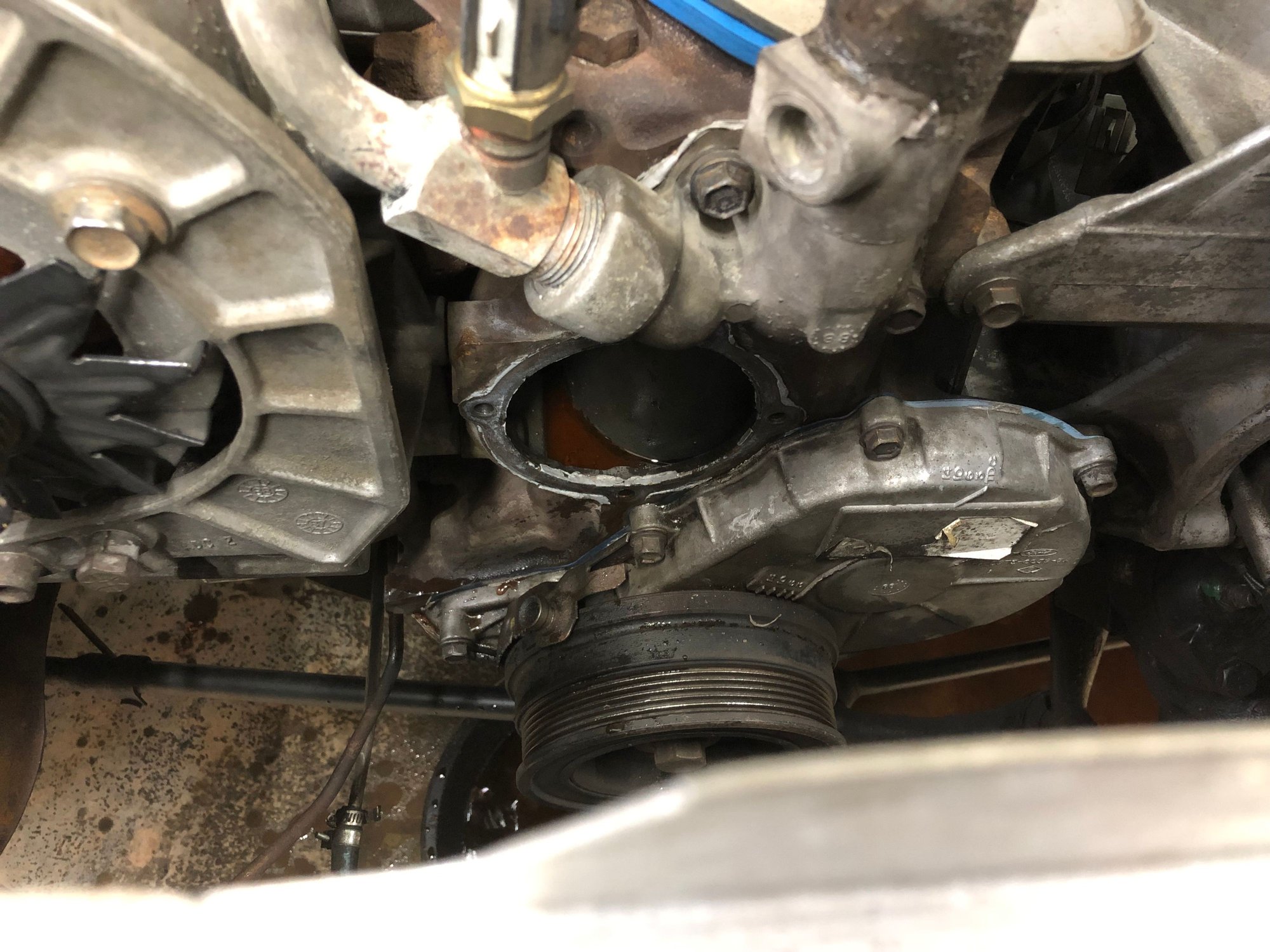

stupid new cardone water pump started leaking out of weep hole not long after install. Got a warranty Gates new pump, spent the time to install it......less than 1 month later its leaking out the weep hole. Guess im going to install another warranty gates unit. I wish you could buy decent non chinajunk parts. I wonder if id be better off with a reman?

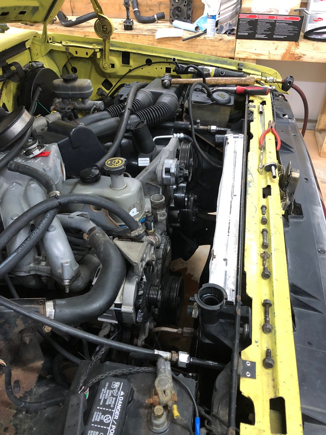

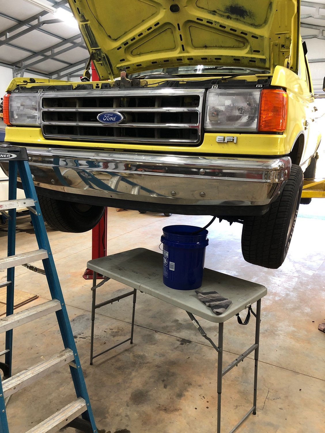

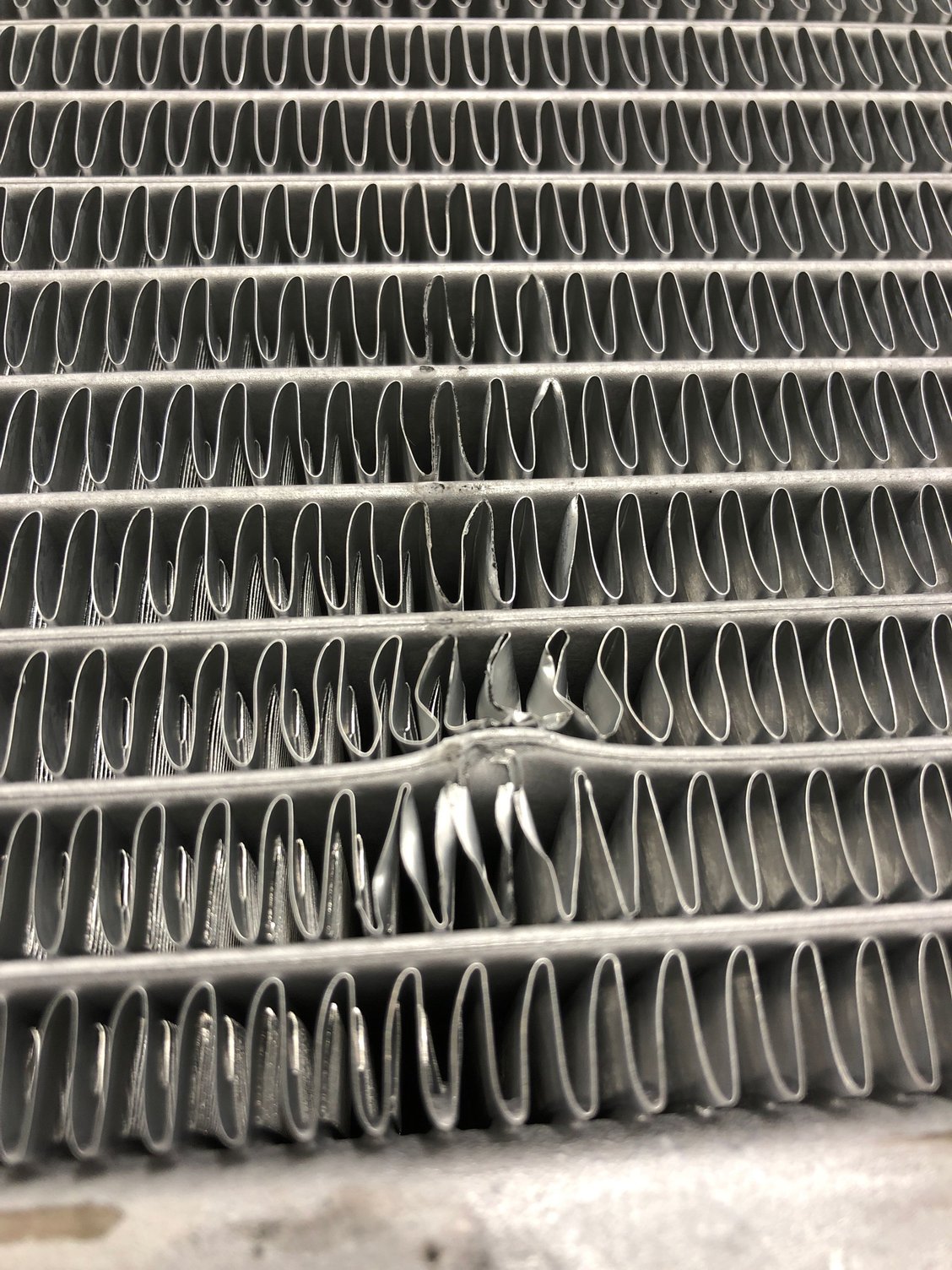

Draining coolant to reuse ....again
Another new chinajunk
Easy peasy
Sprung a leak, my dumb azz hit radiator with wrench tightening water pump pulley bolts

Im not gonna screw with trying to plug hole on a daily driver, maybe if i had aluminum welding capability...

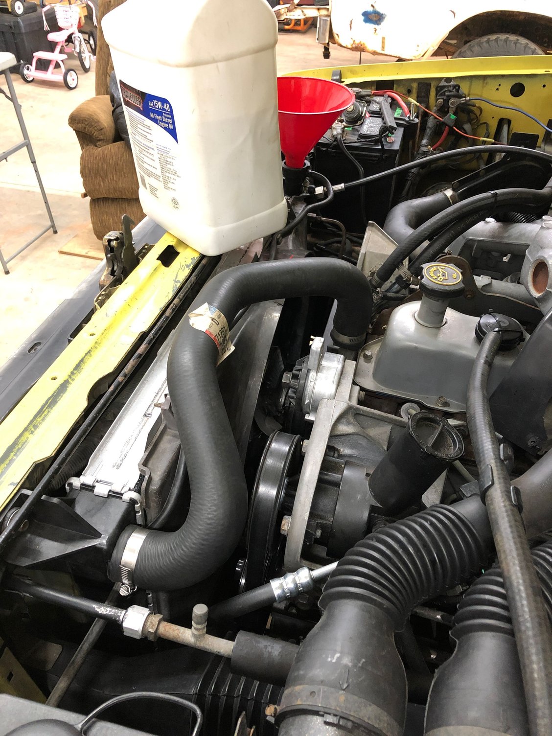

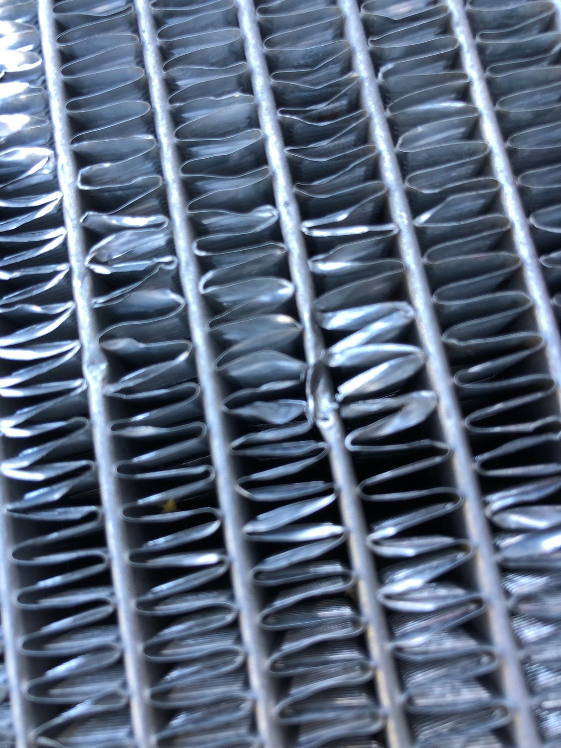

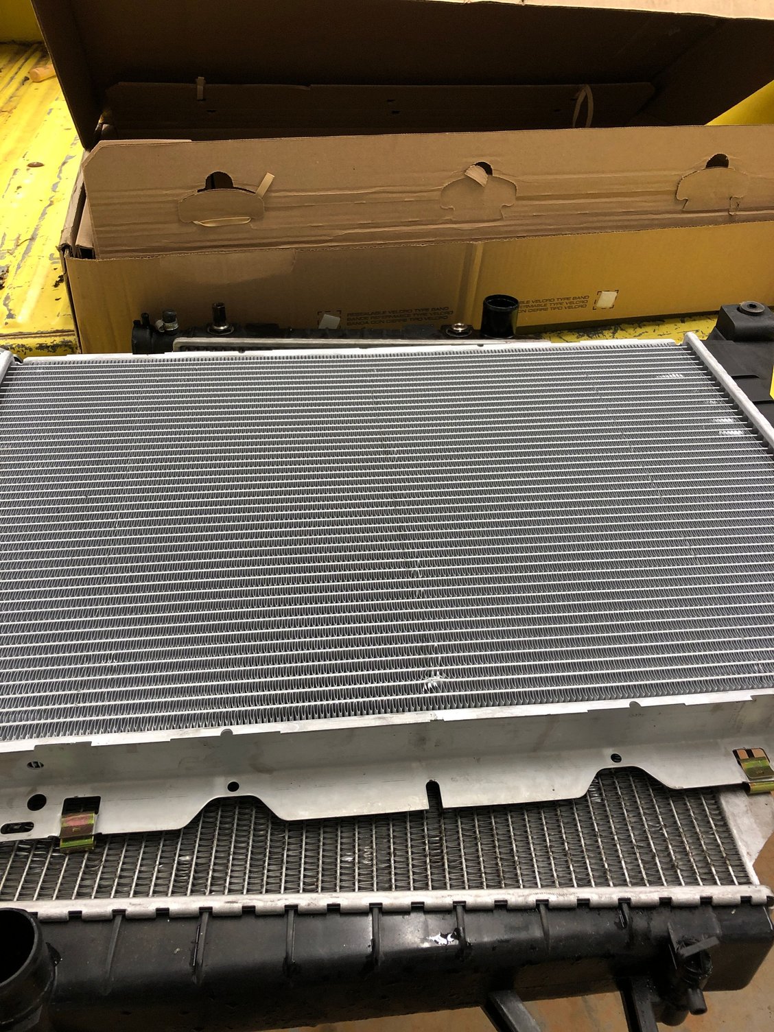

Replacement radiator had a potential hole, got a 3rd and shes back running good
Another fun project
