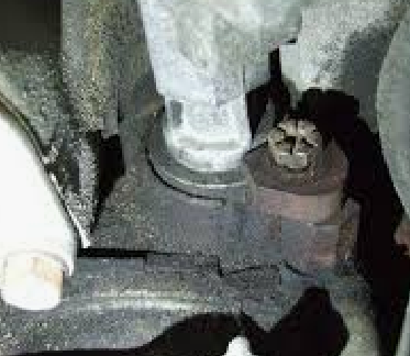

A timing light is one of the top 3 investments for our trucks, prolly any vehicle, Hopefully pics are big enuff to see marks, first clean off distributor base and hold down clamp, you should have an mark(indention) on distributor base and block where they meet each other, first pic, second pic is hold down bolt and clamp removed to see marks better, if the timing hasn't been moved the marks should line up, hope this dont confuse you - if the mark(indention) on distributor is to the left side of mark(indention) on block, the timing has been advanced, maybe too far, and your getting hard start(dragging the starter sound) us old folks call it, before you move distributor, use Sharpie and make new line-up marks if you dont have the marks(indentions), so when you twist(turn) distributor, left(clockwise) advance timing or right(counter-clockwise) retard timing, you can go back to the new marks, if the direction you went didn't help (e.g. made worse, better, no change)
clean this area
marks should line up if at base timing 10*, bolt hold down removed to see better
