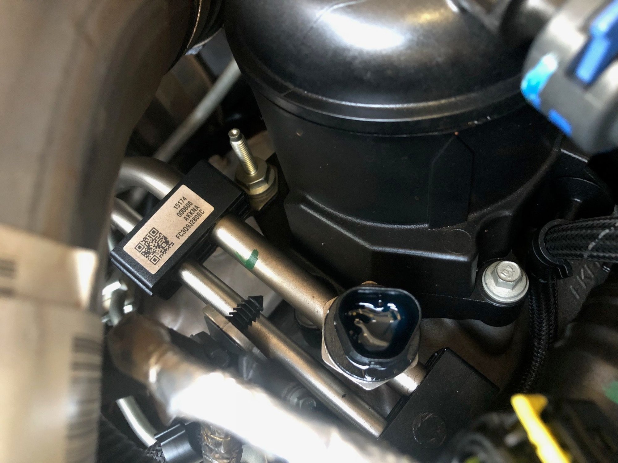

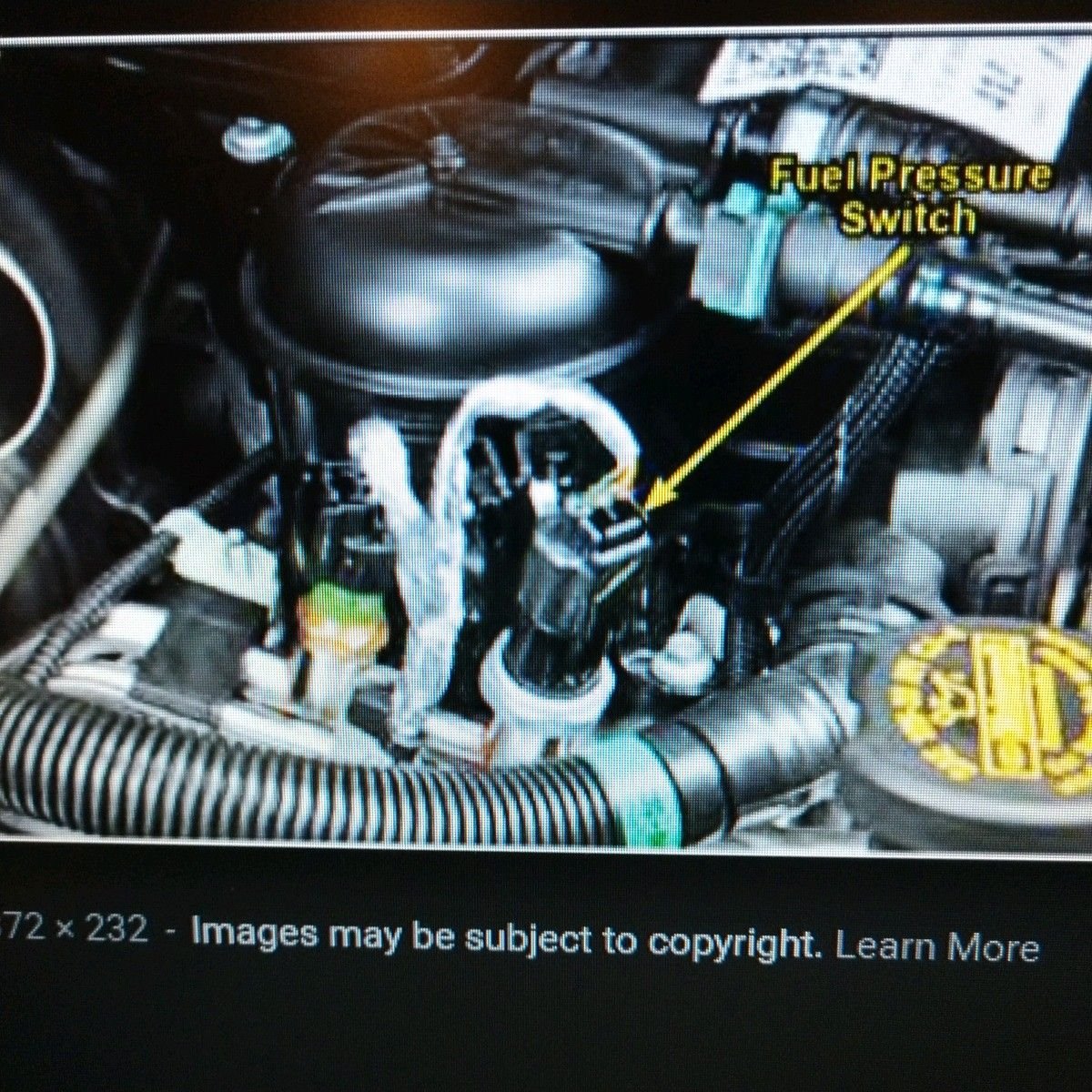

Dave, take a look at fuel pressure switch just in front of the fuel filter in the engine bay. We've had three now in recent weeks here with this leaking or even blown out that caused a HUGE mess.

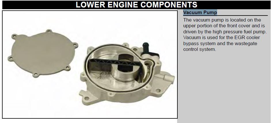

The vacuum pump is located on the front of the engine. They are know to leak oil at times.

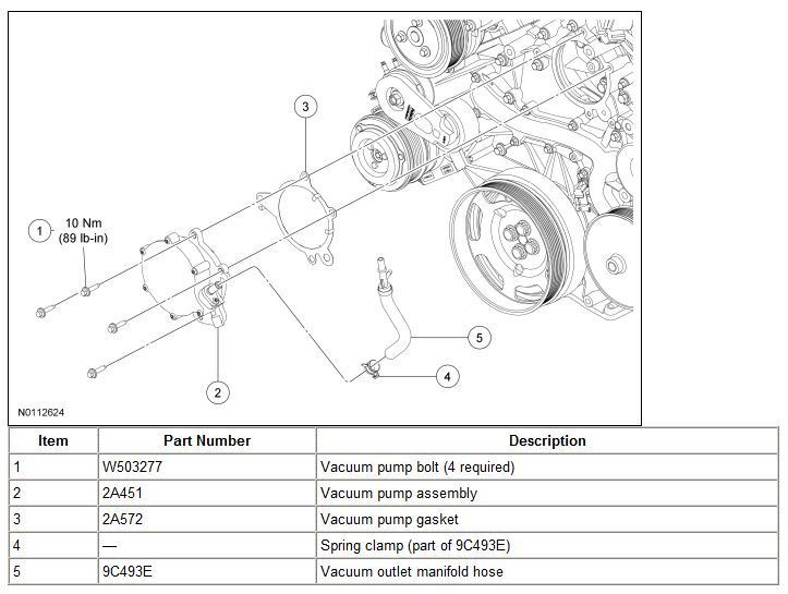

Engine is 5yr/100,000. My vacuum pump was leaking oil post ESP coverage. All four bolts were loose. To avoid what I assume to be a mess of a project to remove and replace the gasket, I just tightened all four (89 in lbs per m-chan68) and that has resolved the issue for 20 months so far. But since you have ESP, may as well have them correct whatever is wrong since that's what it's for.
Wouldn't that be a fuel leak, Monty? what I see is definitely black as coal motor oil....
Thanks Larry. I feel like this is in the ballpark....
Are the bolts for the vacuum pump accessible without dismantling the fan/shroud, etc? Maybe I should just leave alone, and let dealer fix correctly. I just don't like the idea of hitting the road on a 1200mi trip with issues. I guess it's not a catastrophic issue, since there isn't literally a puddle of oil on the ground. I'm just OCD about mechanical issues.
