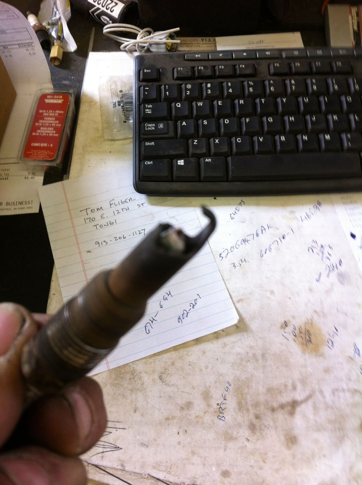

Well, so far the manifold gasket is replaced and there was a broken plug. Hopefully this takes care of it. Probably won’t know until I run the premium gas theough it.
tell us about the broken plug. Post pics

Dude that’s tremendously bad.
Even still I wouldn’t mind if you got a better pic.

I know the pic sucks. I didn’t have time to mess with it. Took it to the mechanic and had him do those while he was doing manifolds, which I was not doing.
