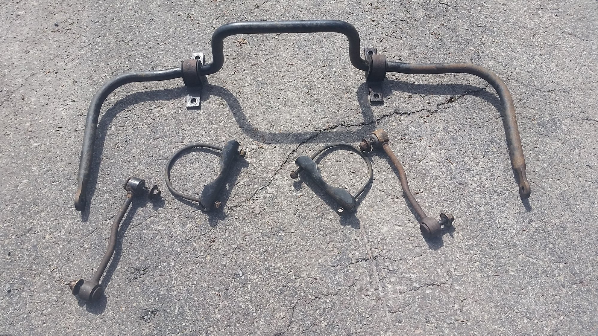

Removed the factory rear sway bar (26mm?) and replaced with Hellwig 7878 sway bar (1 1/4").
Disconnected shocks from lower mounts.
Brushed down, cleaned and POR15'd the lower shock mounts, didnt realize until later that the U bolt holes need to be drilled out for the larger diameter Hellwig U bolt. Used 9/16\" bit.
Old sway bar removed
Comparison of the two bars
Used a C clamp to seat the steel bushings inside the urethane bushings. The urethane bushings only required the supplied grease to push them into the end links by hand.

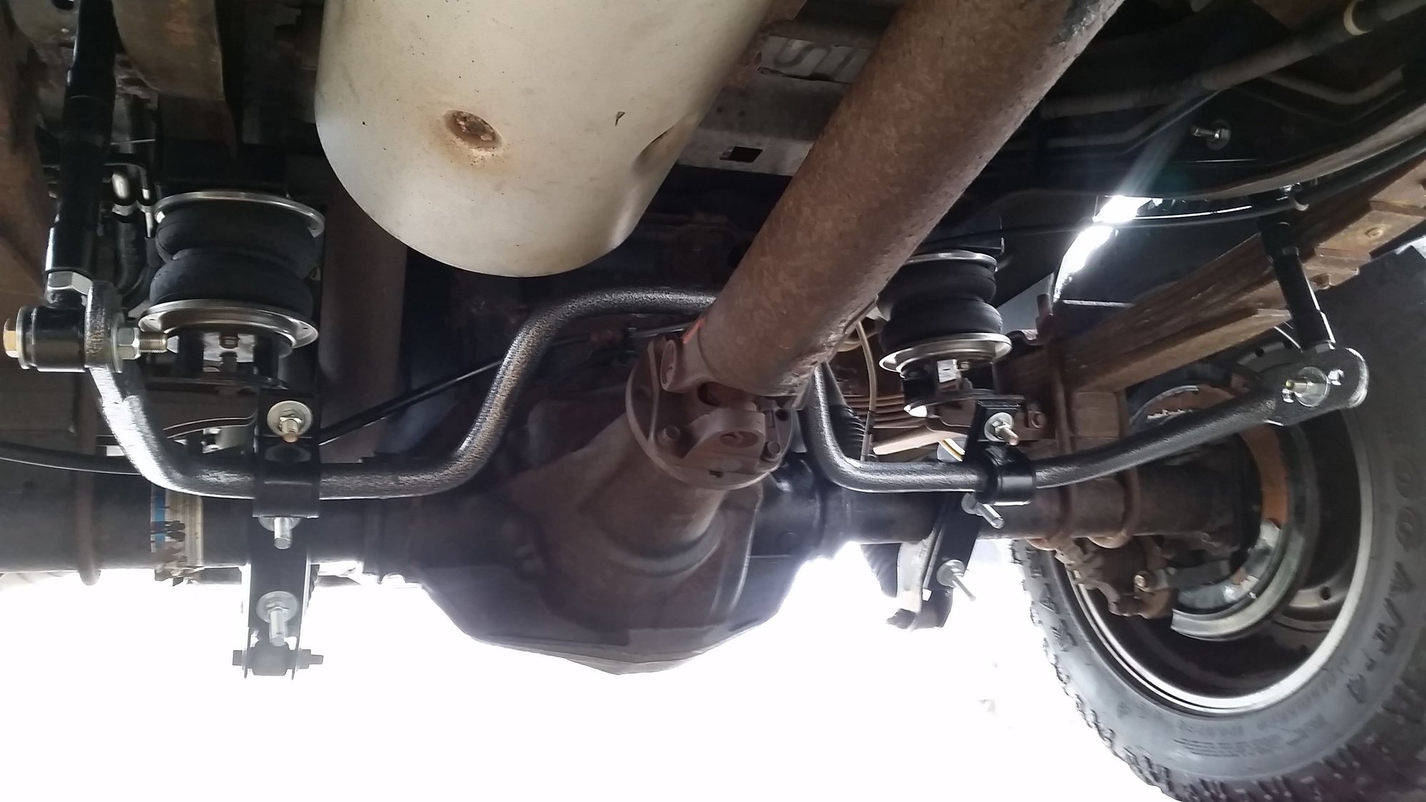

Lower shock mounts drilled out and back on axle
Finished install, used the middle hole for now. Had to run the male end link halves almost completely into the female halves in order to have sway bar arms level with the ground (X/C springs from ATS)

Good job sir. Nice pic of the locator pins also. Nice air bag setup too. Now I might be getting a little jealous of those...

Hey if you don't mind me asking, do you have a lift on your truck? I just bought a Hellwig 7640 and 7878 from a local guy for 150$!
My Ex doesn't have a lift and i didn't now if you were stock and the end-links worked. It looks like in your pictures that the end-links might be all the way together, thought you might be riding stock.

The only suspension lift I have is from the installation of ATS X/C springs, maybe 3.5".

What air bags are those ?

Air Lift brand

I would go ahead and move to the rear hole (stiffest), you're not getting the full usefulness from the bar.
