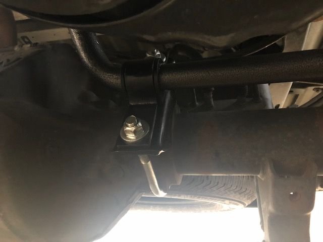

I got my Hellwig BigWig sway bar installed today.
Easy except for the link mount bolt that goes through the frame above the DEF tank. Their instructions on that are really poor and need a rewrite. I was able to fish the bolt into the hole using a piece of coat hanger wire.
The bar is stout, and hugs the front of the diff over the drive side.
Ill be towing on Thursday, I'm expecting better behavior back there.

I put one on my '13 f250. Made a huge difference. Make sure you retorque the bolts after a while. Mine rotated around the axle a bit, causing the bed to ride really wonky. Easy fix, but had me worried a bit.

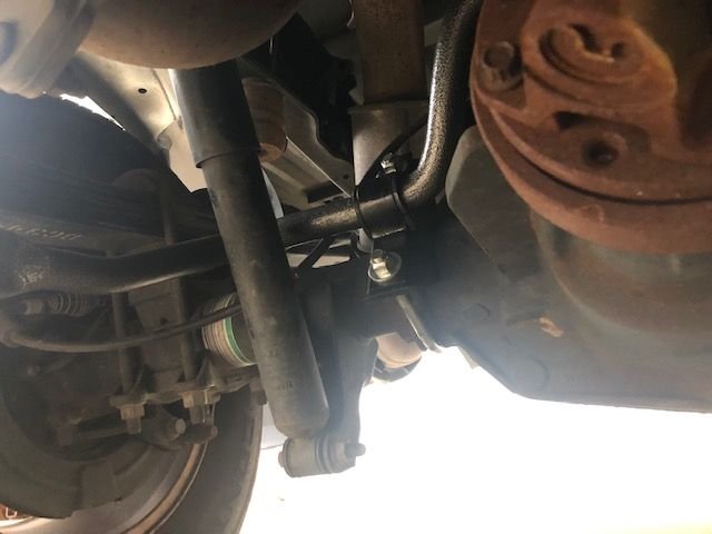

OP, how much clearance do you have between the sway bar and the passenger side shock?
Old Mar 25, 2019 | 08:50 AM
carbonation's Avatar
carbonation
Joined: Jul 2018
Posts: 190
Likes: 91
About 1 3/4 inch.
