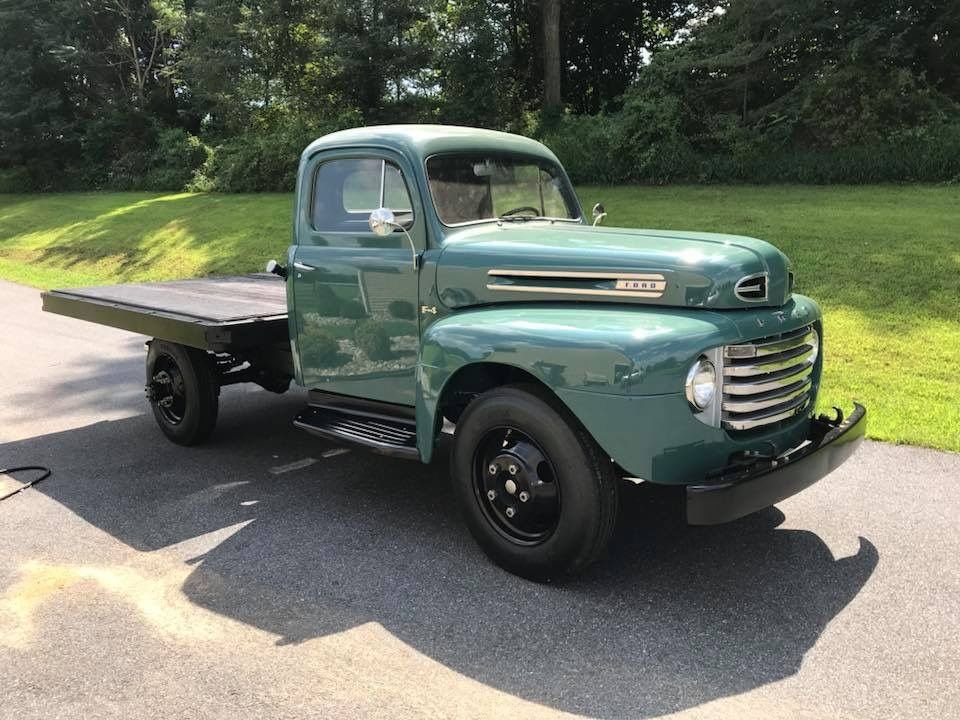

I left my doors on...the painter did a great job on it...
