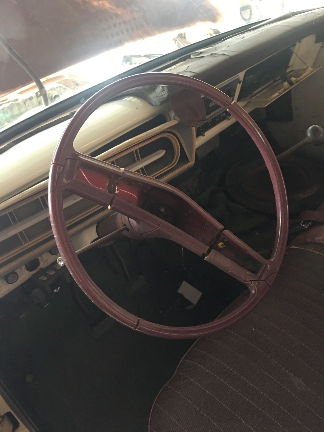

Am I about to order the wrong wheel? I have a 70 F250 but from what it seems I have a 71 wheel? Is the 70 not supposed to have the 2 bar wheel that came when I bought the truck? Does anywhere know where I can find the correct red wheel?

DC Has the 3 spoke C3DZ-3600-A
STEERING WHEEL-BLACK-3 SPOKE

Obviously your steering column has been changed to a 71-72 unit due to the red color in a white interior, or a 73+ column if your emergency flasher switch is located on the column.

So I’m safe I’m assuming they switched it but kept it the same color as the stock interior and that I should just buy a 71 wheel? Do you know of anyone who sells the red wheel?
No.
3 spoke 17" steering wheel using a horn button or horn ring. Reproduced by Carpenter in black only.
1960/63 Falcon/Comet; 1961/66 F100/250 2WD; 1966 F100 4WD; 1966/73 Bronco (unique horn ring); 1967/70 F100/250 2WD/4WD; 1969/70 F350.
2 spoke 16 1/2" steering wheel using a vinyl horn pad that contains the switch. At one time, Carpenter had this wheel in black (D4TZ-3600-A see below), but is now out of stock.
1971/77 F100/350; 1974/77 Bronco; 1975/77 Econoline except 1975/77 F100/350 & Econoline with Speed Control.
1971/73 wheels were available in colors, but Ford obsoleted them circa 1975, replaced them with the 1974/77 black steering wheel (D4TZ-3600-A).
At one time FTE member gangstakr had a NOS red 17" diameter 3 spoke steering wheel. I don't know if he still has it or not.

Will the splines still match up if I go back to the original 70 3 spoke wheel? And how can I get in touch with ganstakr, I’m still fairly new to the forum and don’t know much about the ins and outs of working it yet.
