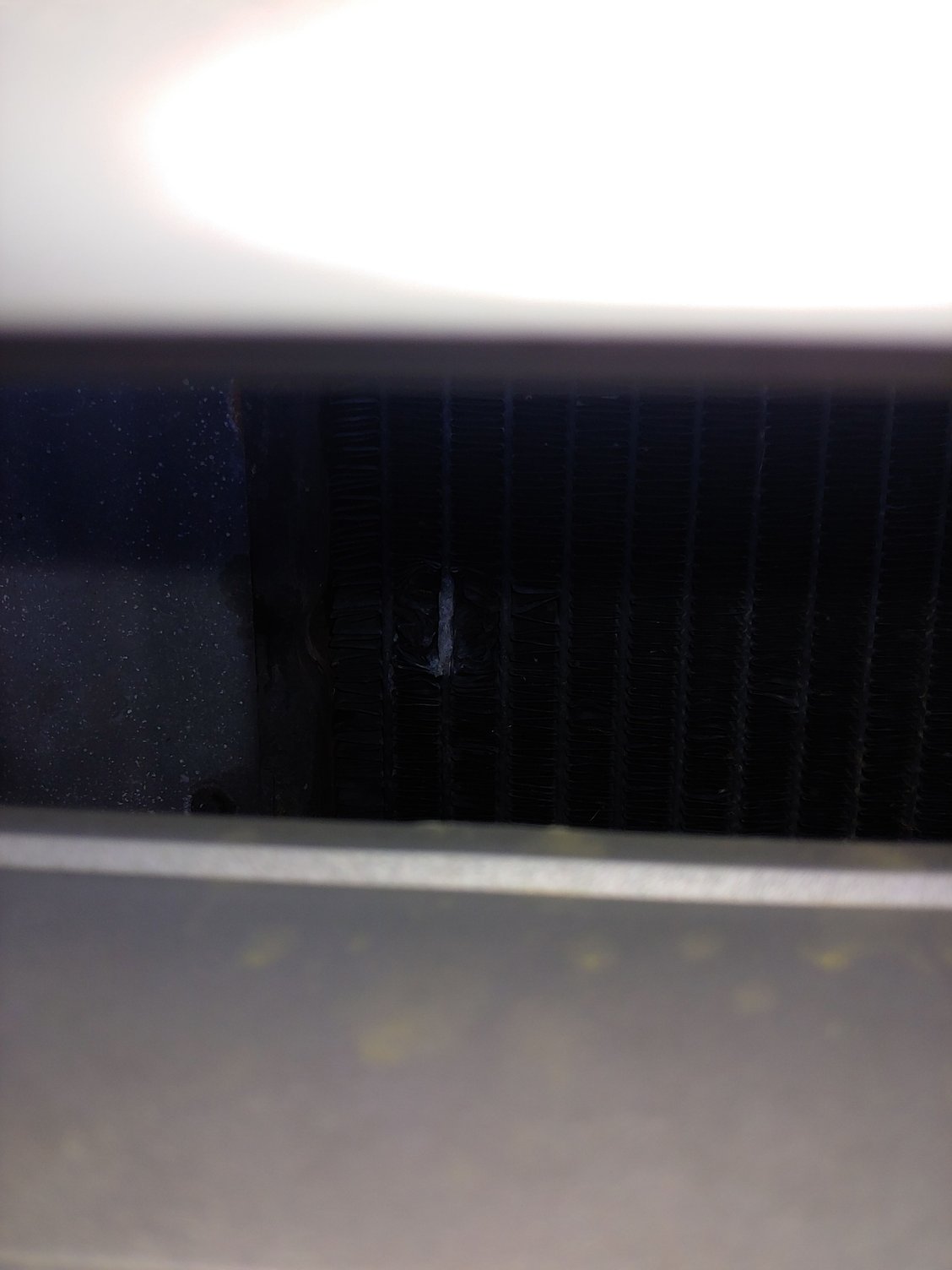

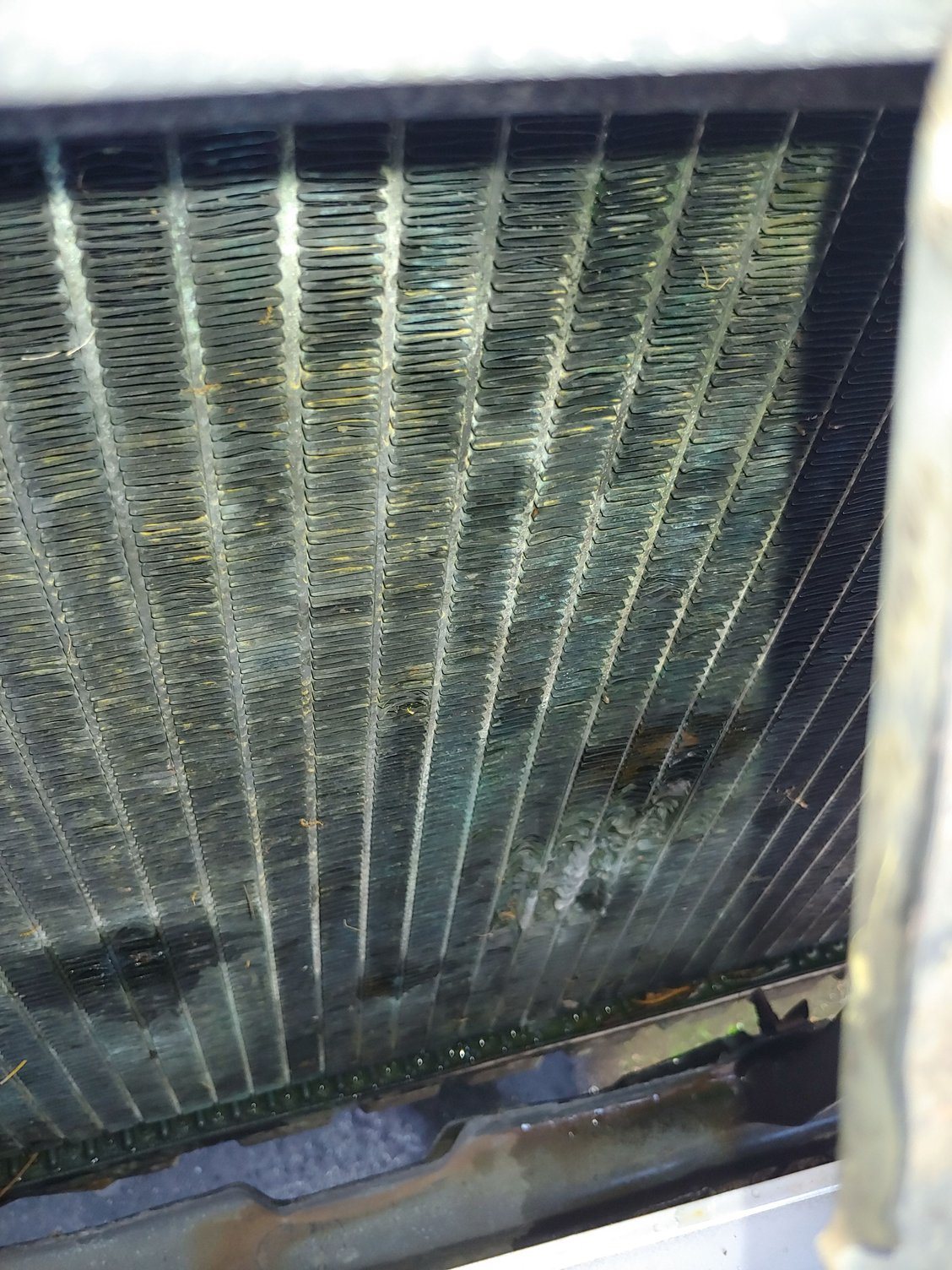

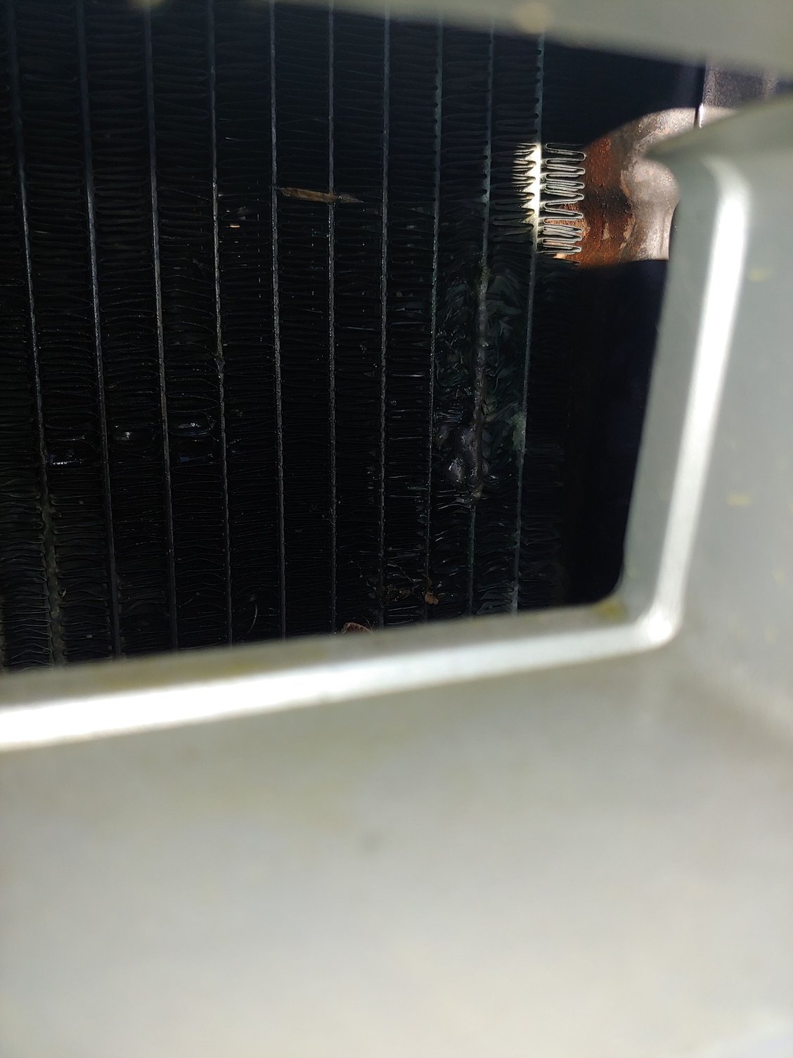

This what the radiator looks like the dents are worse than I thought

Someone did a crude solder job on the rad tubes to fix leaks. Time to have it recored, or replace it with a new one.
I am with Scott. The wet spots you see on the fins up high and the green all over is a sign it is on its way out.
The smoke (steam) was the coolant weeping out and burning off.
Before you replace the radiator I would do another good flushing as it looks like there is rust sitting in the bottom.
Pull the heater hoses off and back flush the heater core also.
It would be a good time to replace all the heater & radiator hoses and maybe the Tstat & gasket.
My radiator had crust when you looked in side. With it out cap on a laid it flat and filled with vinegar and let sit for a week. Drained and flushed and repeated.
It was in the truck filled with just water and I saw a little puddle and when checking found the radiator was doing the same as yours, weeping.
The crust was plugging the holes, once it was removed it leaked, now has a new radiator and all is good other than that rubber freeze plug (the PO installed) I should have replaced when the motor was out of the truck.
A $2 part comes back to bite me!
