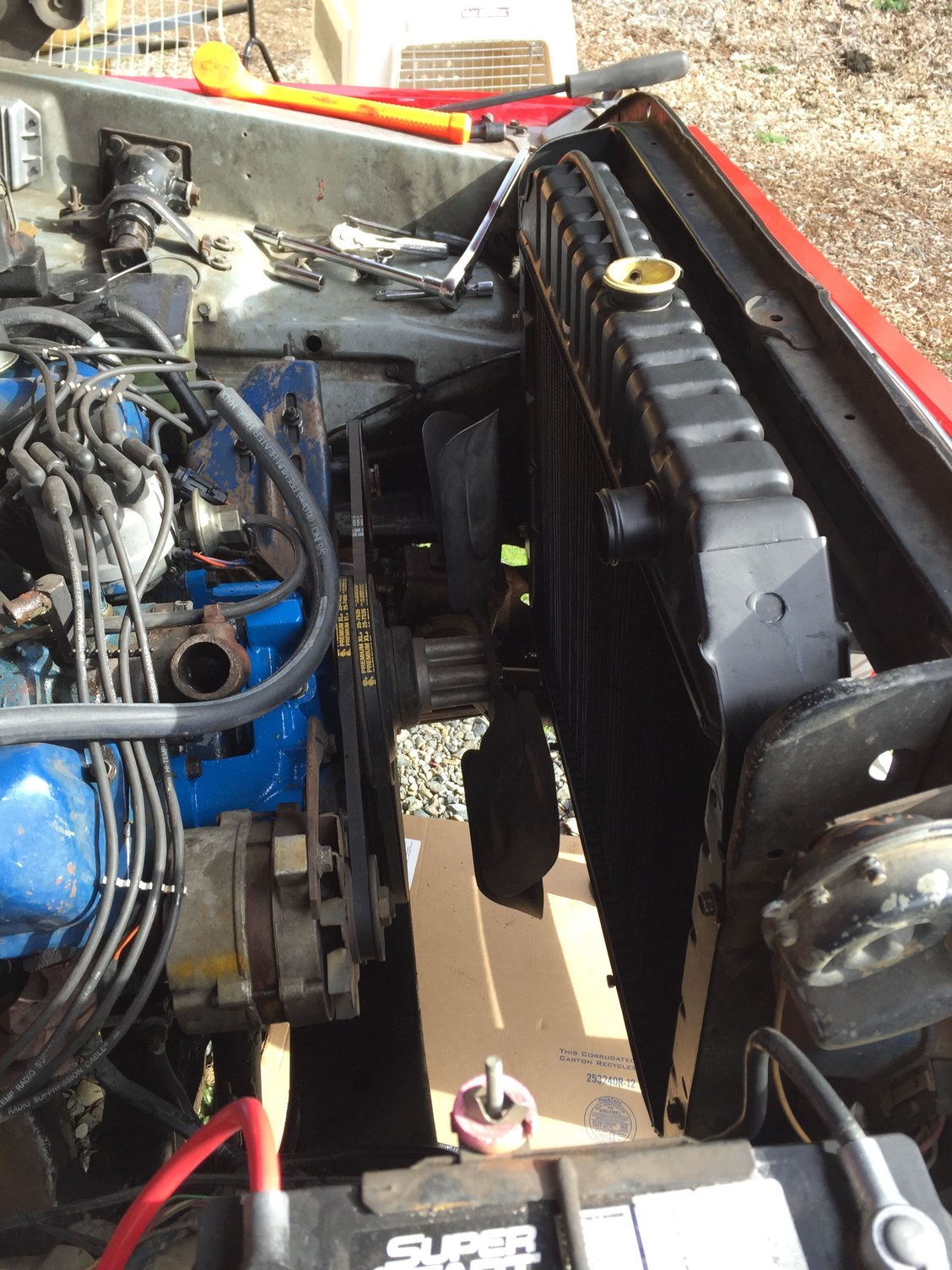

I just went through this too
The original 2 row radiator in my truck started leaking at the header as well last week. I found a great old school radiator shop with a guys who's been in business since '71 and had him look at it, not fixable but recorable.
He gave me quotes for a 2, a 3, and a 4 row recore and rebuild using the original tanks. The $600-$675 prices pretty much blew that option away. The other option he offered was a new radiator with brass tanks for $447.00. The part number he had listed in his book was 433-444.
I wasn't going to settle for a cheap $199.00 Chinese built radiator with plastic tanks, the kind that are sold through oreillys and the cheap parts places.
I looked at the aluminum options which look nice but they're far from stock in appearance which is something that's important to me with my truck.
Through all my research I found one consistent number popping up between all of the 3rd party retailers (NPD etc), it was "444". I was able to determine the manufacturer of those radiators was Thermal Solutions Manufacturing. A search of their website yielded the applicable part number of 433-444.... This unit was built with brass upper and lower tanks and is a 3 row core. I called Thermal Solutions and was told they don't sell to private parties, so I called www.radiators4less.com and asked about that specific part number and manufacturer, I got a call back from Cara 5 minutes later with a confirmation that radiator was in stock and could be shipped to my door for $359.00.

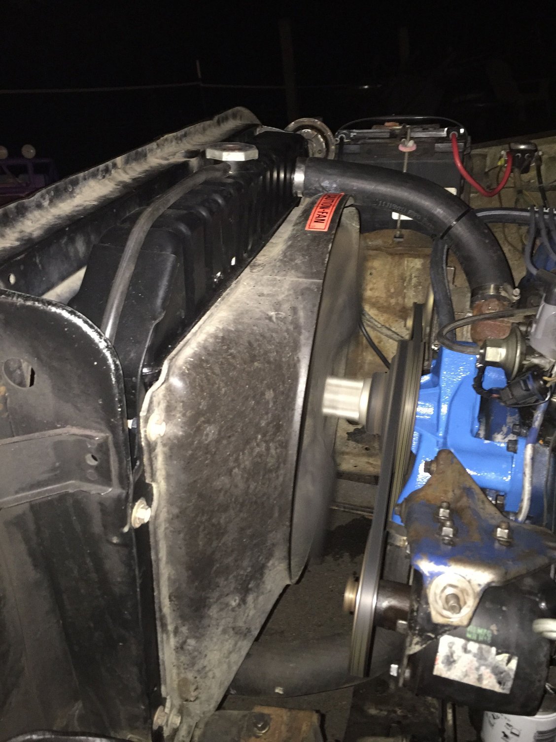

The radiator arrived at my door the following day and it's nice. My only complaint being the drain petcock being plastic instead of metal. The radiator is well built out of brass and copper/aluminum and It bolted right in place and everything fits well including the shroud.
I've put about 100 miles on it and it's great, in fact it cools a lot better than the original... So much so that it's rare to see the temp needle get into the operating range after warm up.
I recommend calling Cara at radiators4less ans asking for this unit.
