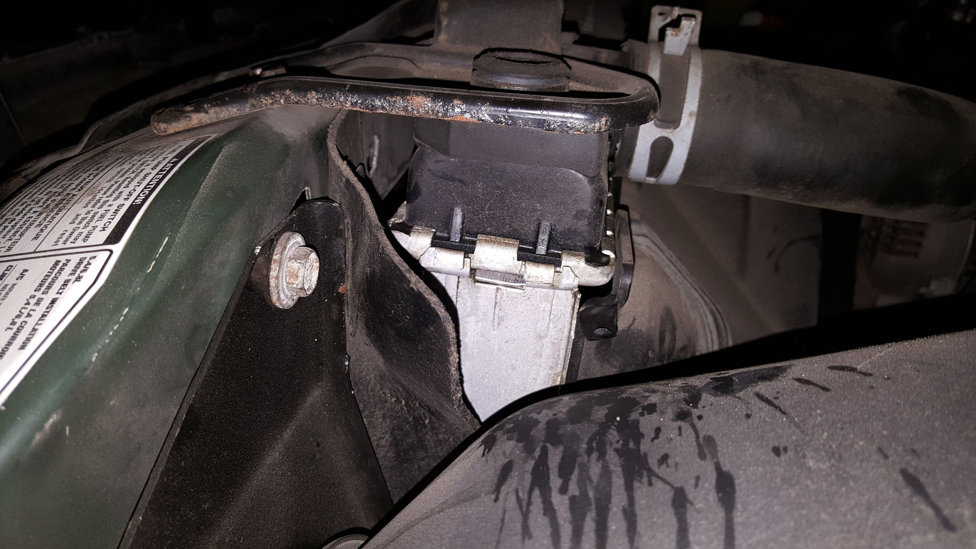

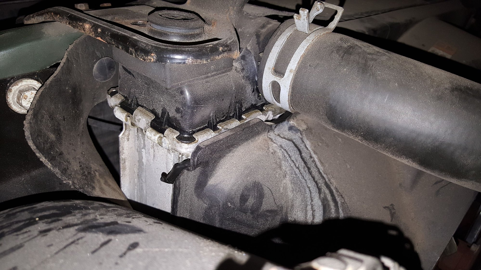

Looks like I am leaking a little bit of coolant from where the aluminum meets the plastic on the radiator. No obvious start location of the leak. Just a small around of coolant all around the circumference of the radiator and traces of coolant running down both sides of the radiator.
coolant around top edge of radiator
Coolant running down passenger side of radiator
Coolant around edge of radiator
Coolant running down driver side of radiator
I just replaced the coolant a couple months ago.
I have new upper and lower radiator hoses. New water Pump. New Machined billet thermostat housing. New Thermostat.
Since it looks like I need a new radiator what else should I go ahead a take care of while i am at it?

That's the life span of a crimp on plastic tank. If and when mine starts to leak, I'll probably go get a mishimoto all aluminium radiator.
