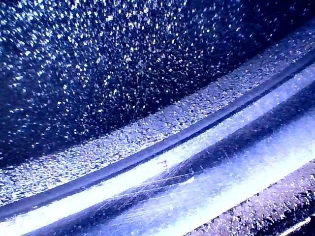

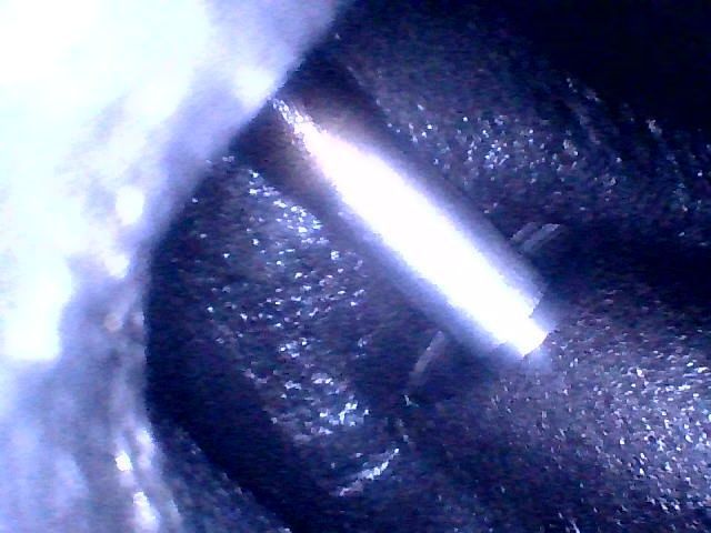

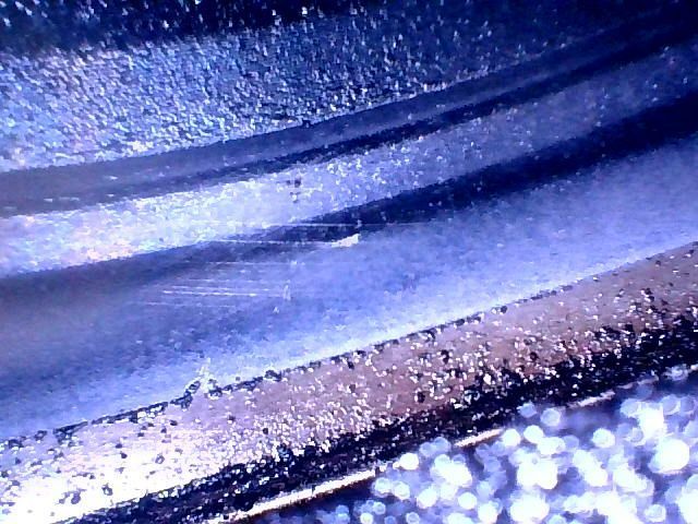

Finally got pictures this morning. I had to wait until I could borrow my wife's phone to take the images. The piston is sooty. I could not get a good picture of the valves inside the cylinder, but I was able to get some good pictures of the top of the valve. There is some discoloration on the top of the #6 intake. I checked the #5 for comparison, and it is much cleaner. Below are the images i took.
Cylinder with Piston near top.
Top of piston
Cylinder wall. Note the cross hatches still look good
Top of piston with piston down
Another shot of the cylinder wall
Top of #5 valve
Top of #6 intake valve
Another shot of the top of #6 intake valve
Different shot of#6 intake.

Took the heads off yesterday. #6 was very dirty and sooty. Definitely getting oil into the cylinder. It also looks like I had a small leak in the head gasket on the #6 cylinder and a small leak in the #6 exhaust seal. #5 is apparently also having some trouble that did not show up on the plug. The plug looked ok on #5, but the cylinder and head are a a dark brown instead of white like the rest. There was also a tiny bit of carbon on the exhaust of the #4, but it generally looked good. The bank 1 head looked as it was supposed to. I currently have the heads at a local shop for a cleaning, check, and replace the valve seals. I figured have them both done at the same time so they will hopefully wear evenly. I will post some pictures of the cylinder. Is there a good way to check the rings at this stage? I do not want to put it back together only to find it was a piston ring. Also, is it possible to replace the rings without pulling the block out of the frame? I do not have access to a hoist. I have seen people which say it is possible to remove the oil pan without removing the block, but they give no details.

How does the #6 cyl Wall / Bore finish look?
